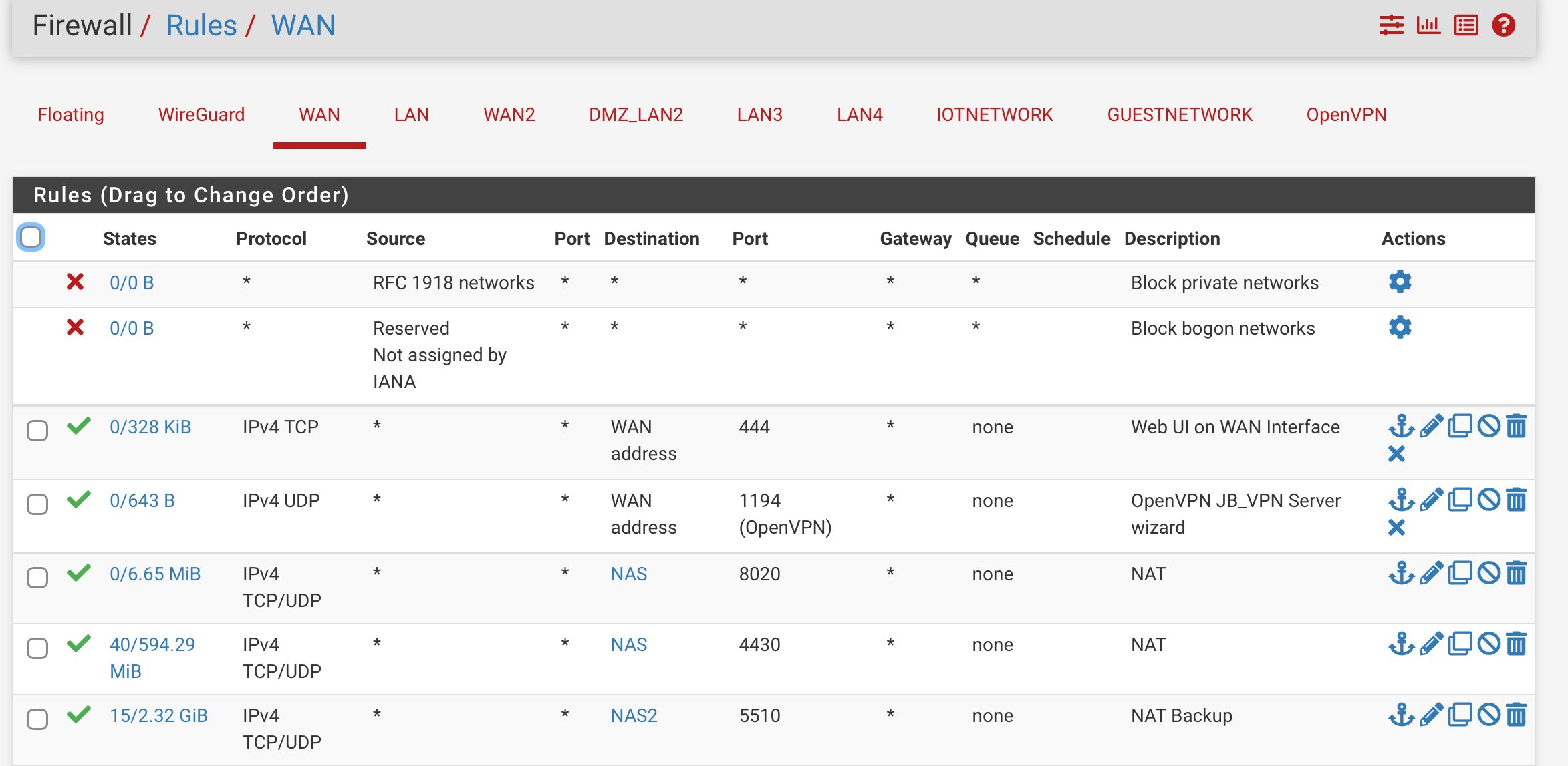

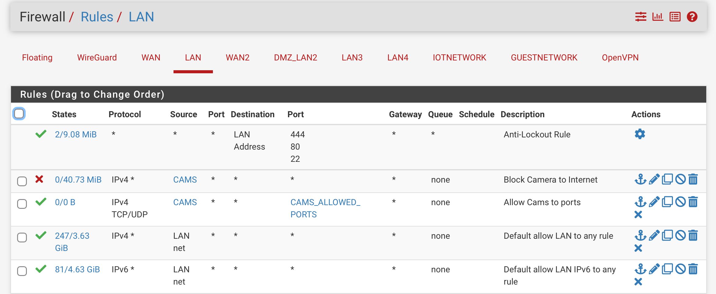

      I thought it was a firewall issue, so I allowed all traffic (temporarily) but with no luck. This happens to both my NAS devices. Only way I am able to connect to package manager is by rebooting the PFSENSE (NETGATE 4100) device. It will work for a day or two, then back to the same issue.
      These are my configs on the firewall. Any guidance would be appreciated.

            @michmoor What do the firewall logs show then?
            Based on your LAN rule,assuming your Synology doesn't fit into the CAMS alias, your flows should go outbound so if its being blocked the first place i would check is the firewall log.
