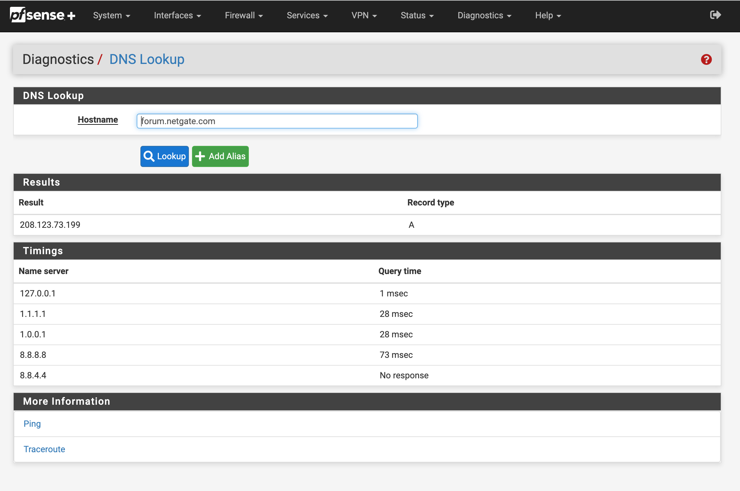

                            Just happened again. The problem is DNS related, but I can ping and nslookup Google:
                            J J 2 Replies Last reply Jul 4, 2023, 5:38 PM Reply Quote 0

                                  @johnpoz i mean.. the problem says: dns_probe_started. Thats why im supossing is DNS related.
                                  I tested on all browsers: Chrome, Firefox, Opera and Edge.. all the same error. Maybe is DNS related, because im blocking DoH with pfBlocker.
                                  pfBlocker > IP > IPV4:
                                  DNSBL Safesearch:
                                  J 1 Reply Last reply Jul 4, 2023, 6:07 PM Reply Quote 0
