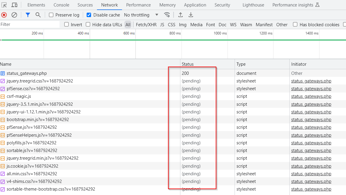

                                        alexmh
                                        I've got issues. After upgrading from 2.6 to 2.7 the Web Interface becomes super slow after 2 or 3 pages (for instance, if you are configuring Traffic Shaper, after step 2 or 3 the page does not load). IT does happen across the board if you are navigating between pages
                                        I did some investigation by:
                                        • Opening Chrome on the developer to check mode and it keeps waiting for the PFSense to respond. Any other site or application (I do have servers on the LAN) opens fine for testing purposes.
                                        • Nginx access log does not show the GET requests. I tried to check the Nginx error logs, but nothing
                                        • Memory is not going over 6% (My box rans on 16GB)
                                        • CPU does not go over 8%
                                        • Disk is only 2% used
                                        I've also tried to install it from scratch and restore the configuration... But the same performance issues.
                                        It was working for years on the old version (which us upgraded before from the old Old version).
                                        Is anyone having the same issue?

                                            stephenw10 Netgate Administrator @alexmh
                                            @alexmh said in 2.70 CE release any issues so far??:
                                            Does it do it in the default config before you have restored your file into it?
                                            Is something in your config preventing the firewall connect out?
                                            Does it do it on every page? The screenshot shows it from status_gateways which has to pull in the actual gateway data.
