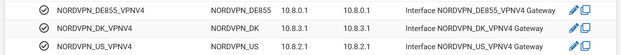

      Gateways:
      Screenshot 2023-07-10 at 11-40-23 System Routing Gateways - pfSense.localdomain.png

        I don't think so. But in my experience the problem only occurs if gateways have the same ip-address, the same subnets don't matter. So maybe you should look into this weird behavior of your setup.
