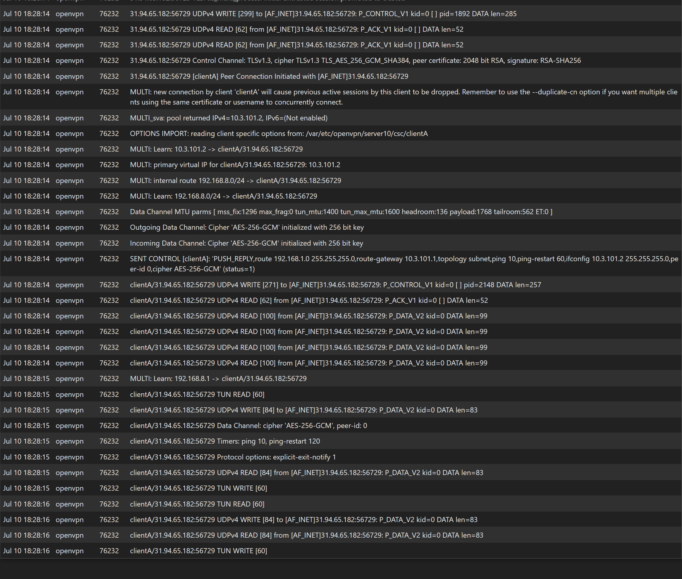

      Pfsense is configured as the OpenVPN server, after the upgrade to 2.70 my LAN clients (192.168.0.1/24) on the Pfsense side could not trace or ping anything to the client side anymore
      So I deleted the Pfsense OpenVPN server config and then followed this guide and set it all up from scratch, but I still have the same issue :-
      https://docs.netgate.com/pfsense/en/latest/recipes/openvpn-s2s-tls.html
      The OpenVPN client establishes the tunnel to Pfsense, Pfsense FW can ping all clients on the remote client subnet (192.168.8.0/24) and the remote firewall on the client side can ping all hosts on the Pfsense LAN (192.168.0.1/24) including the Pfsense FW
      Tunnel :-
      OpenVPN logs :-

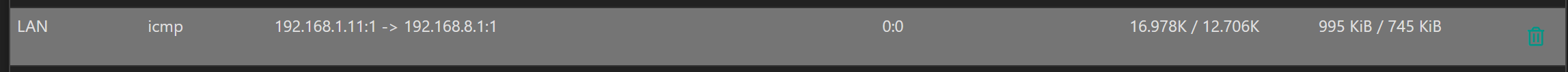

      All I see in regards to ICMP from 192.168.1.11 to 192.168.8.0 when pinging from the Pfsense client side in states is :-
      The Firewall and NAT rules are also setup as per the linked document above.
      • jimpJ Offline
        I moved this to another thread because that other thread isn't the place to add on new potentially unrelated issues even if the symptoms seem similar.
        Do not Chat/PM for help!
        • jimpJ Offline
          • Look under Diagnostics > Routes and:
            • Make sure there is a default route for IPv4
            • See what the entry for 192.168.8.0/24 looks like. Is it pointing to the correct OpenVPN interface/address?
          • Make sure you do not have any routes for 192.168.8.0/24 under System > Routing, Routes tab
          • Try a ping from the firewall itself using the LAN for the source
          • Check the LAN rules, make sure the client on LAN isn't hitting a rule with a gateway set
            Doody @jimp
            @jimp
            IPV4 routes, ovpns10 is the correct interface and there is a default route :-
            System /Routing / Static Routes :-
            Ping from LAN :-
            So I guess, last thing to check is the LAN rules
