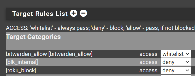

      My group ACL target list shows the following
      The problem is that this doesnt work. All internal sites are still accessible.

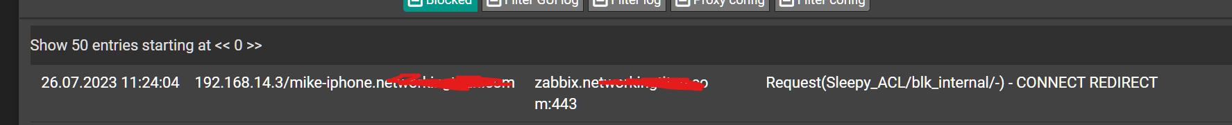

      Whats Odd is that in the Blocked log file you see the request hitting the block ACL but its still permitted through
