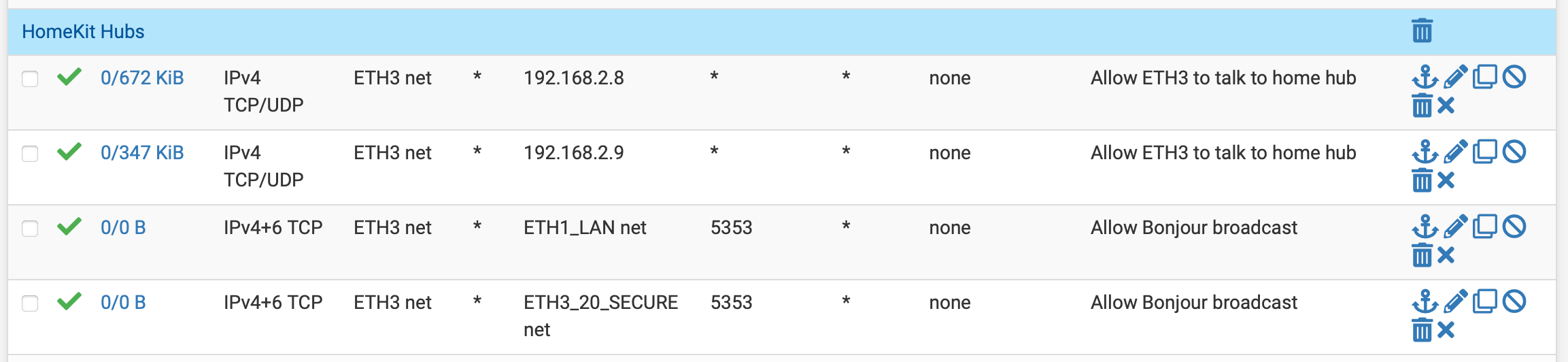

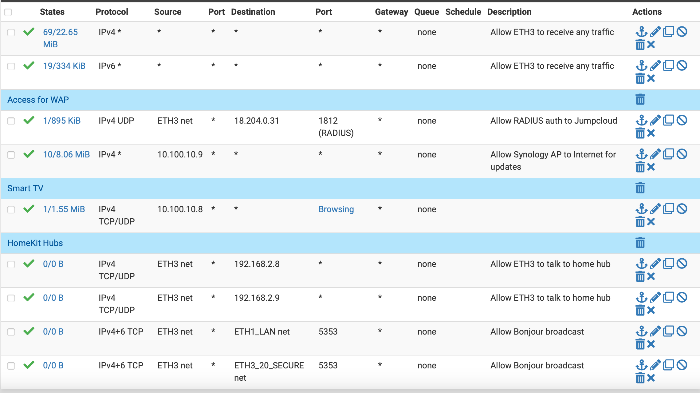

            Here's a pic of my full set of rules, can anyone tell me what might be missing?

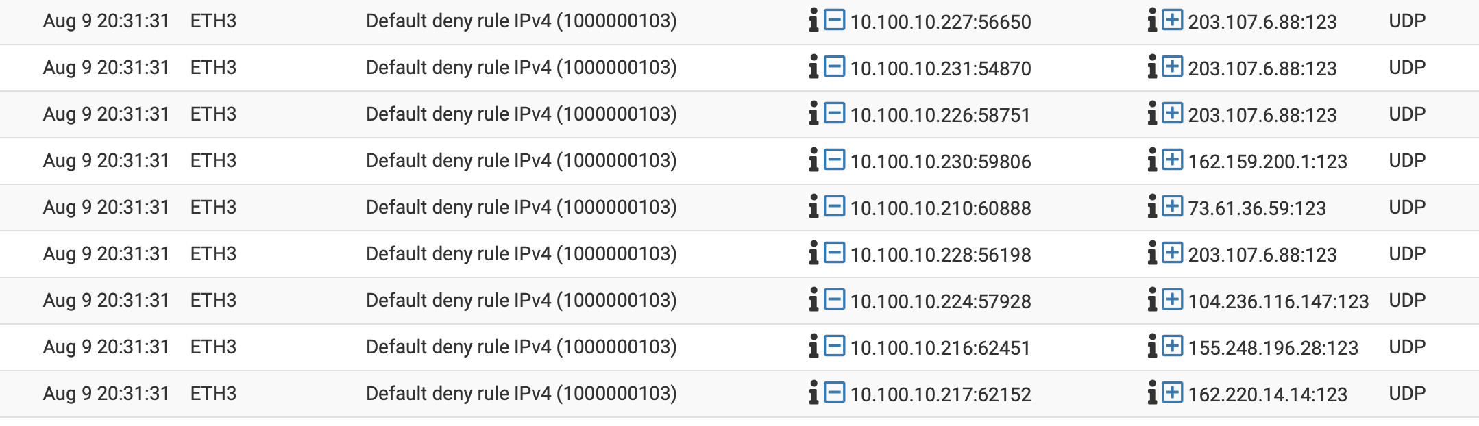

                        Odd, I upped it to 3000 entries and searched for the IP address of my garage door opener which I specifically remember was not connecting to the home app.
                        There were no hits on it...

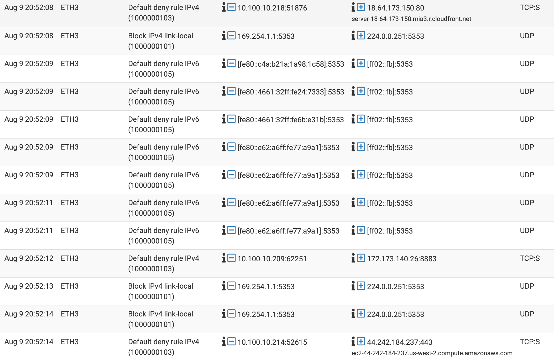

                            Do you see the 5353 mdns traffic? That would be multicast destination.. I have a couple of threads around here about troubleshooting avahi.. And what rules you have to have to allow it to work.. and via sniffing validate that your traffic is being sent on, etc.
                            I see hundreds of these and I don't recognize either of the IP addresses, but I'm thinking they may be multicast addresses?
                            Aug 8 14:07:13 ETH3 Block IPv4 link-local (1000000101) 169.254.1.1:5353
                            Cannot resolve 224.0.0.251:5353
                            Cannot resolve UDP

                              169.254.1.1:5353
                              Not sure how that would do anything - that is a APIPA address, ie link local for single network.. It wouldn't route across pfsense anyway. Even if it got back an answer from its discovery of something that was on 192.168.x.x etc..
                              A 169.254 is something normally gives itself when dhcp doesn't work.. It could for something discovery something on the local network - I think one of my directv bridge device things use to send out SSDP from that IP range, etc.. But its pretty much just noise..
                              I think there is a way to get 169.254 to be routed - I think there is check box in pfsense somewhere to allow that.. But that would not really be a solution to be honest.

                                        Something like this:

                                            @RobbieTT said in Rules to allow Homekit across vlan:
