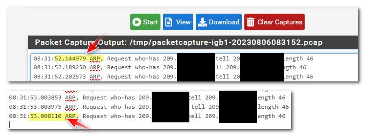

          Here captured 100 arp packets.. Look at time of first packet, and then time of 100th packet.. Less then 1 second, so yeah your light be going blinky blinky ;)

            Thank you for your help. Where in PFSense can I find the log of the default WAN deny ?
            I used the packet capture under diagnostics as you suggested and I can see a few ping requests from my ISP default gateway, some port scanning requests from unknown locations, but mostly a lot of ARP packets. Some contain my ISP IP and my IP, but most of them don’t. It looks like they are destined from another IP. What are all of these ARP packets and should I be concerned that they are showing up at my WAN? Are they sucking CPU from my router when they are being processed?

              johnpoz LAYER 8 Global Moderator @pV5
              @pV5 said in Very High WAN Traffic When No LAN Activity:
              In the normal firewall log.. Unless you disabled logging default deny? Then all traffic blocked by the default deny on any interface would be just in the firewall log.
              I have it turned off - because I have specific rules to just log what I want to log, ie only syn packets for tcp and only common UDP ports. Seeing all of the noise would be kind of pointless. But I am interested in specific traffic.
              yeah mine shows IP ranges that are not in my /21 I get from my ISP for arp as well. It seems many an ISP like to run multiple layer 3 on the same L2..
              But all of those arps would account for your blinky blinky lights.
