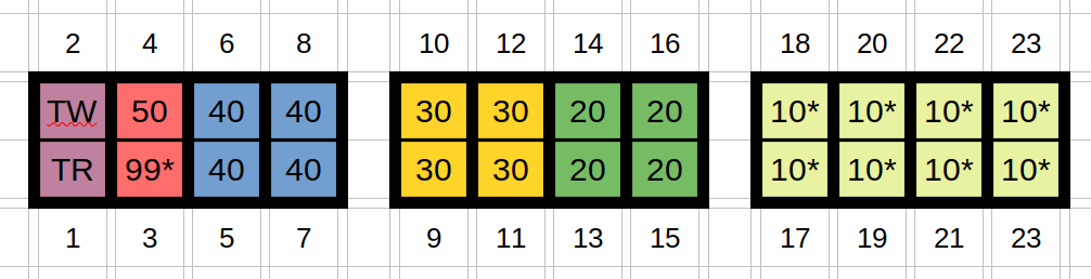

      Router: Netgate SG-1100
      Switch: Mikrotik CRS326-24G-2S+IN
      (switch diagram below)
      Switch Port 1 (TR) is a trunk port connected to SG-1100 and carries all of the VLANS (10, 20, 30, 40, 50, 99)
      Switch Port 2 (TW) is a trunk port connected to a WiFi Access point and carries all of the VLANS (10, 20, 30, 40, 50, 99)
      IP assignments:
      Switch = 10.10.99.250
      Wifi Access Point = 10.10.99.251
      If I connect a laptop to port 3 (VLAN 99) I can access and ping both the switch (10.10.99.250) and Wifi Access Point (10.10.99.251).

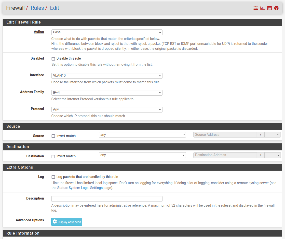

      If I connect a laptop to port 17-23 (VLAN 10) I can NOT ping or access the switch (10.10.99.250) and Wifi Access Point (10.10.99.251). I have a firewall rule (see below) on VLAN 10 that passes any IPV4 protocol to any desitnation, so I thought this would work. What have I done wrong or what configurations am I missing to get this to work?

        Hard to tell because we only see one rule.
