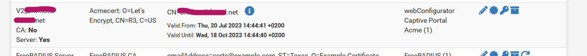

        In System > Certificate Manager > Certificates the certificate obtained from Letsencrypt shows up :

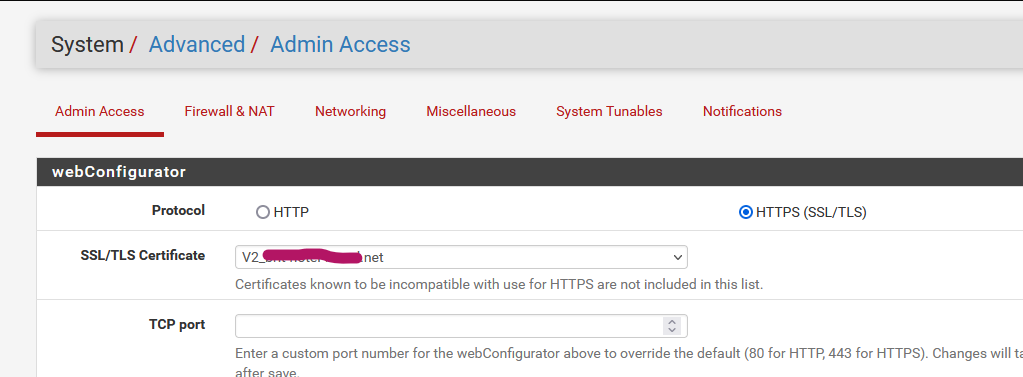

        I use this certificate for the pfSense GUI (webConfigurator) as indicated.
        I never bothered to change the default TLS port number 443 :
        so 'https' selected means : use port 443, which is the default browser's https port.
        You've selected the certificate obtained by acme / Letsencrypt ?

        That should be it : select this domain for the web configurator, select 'https', save and done.

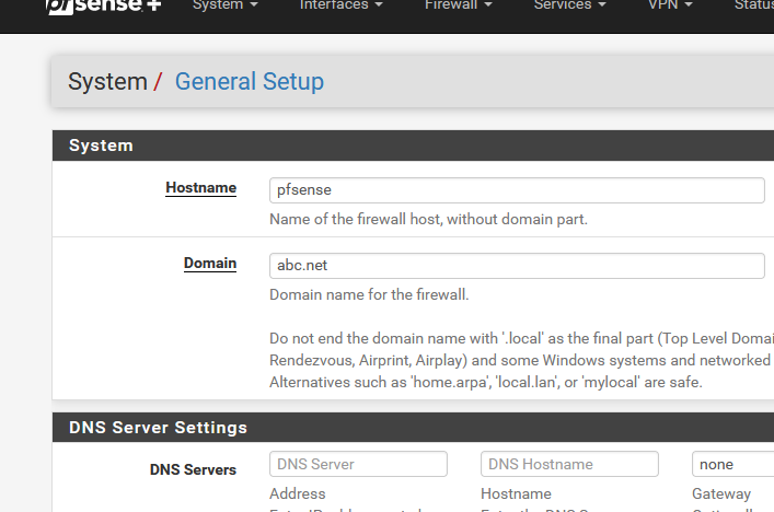

              When you ask for a certicate, like pfsense.abc.net, you have to do this first :

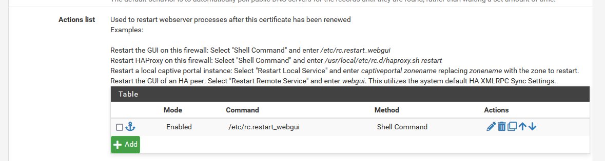

              You've set this :
              If a new certificate was obtained, the webconfigurator has to be restarted so it will use the new certificate. That's what the 'action' is for.
