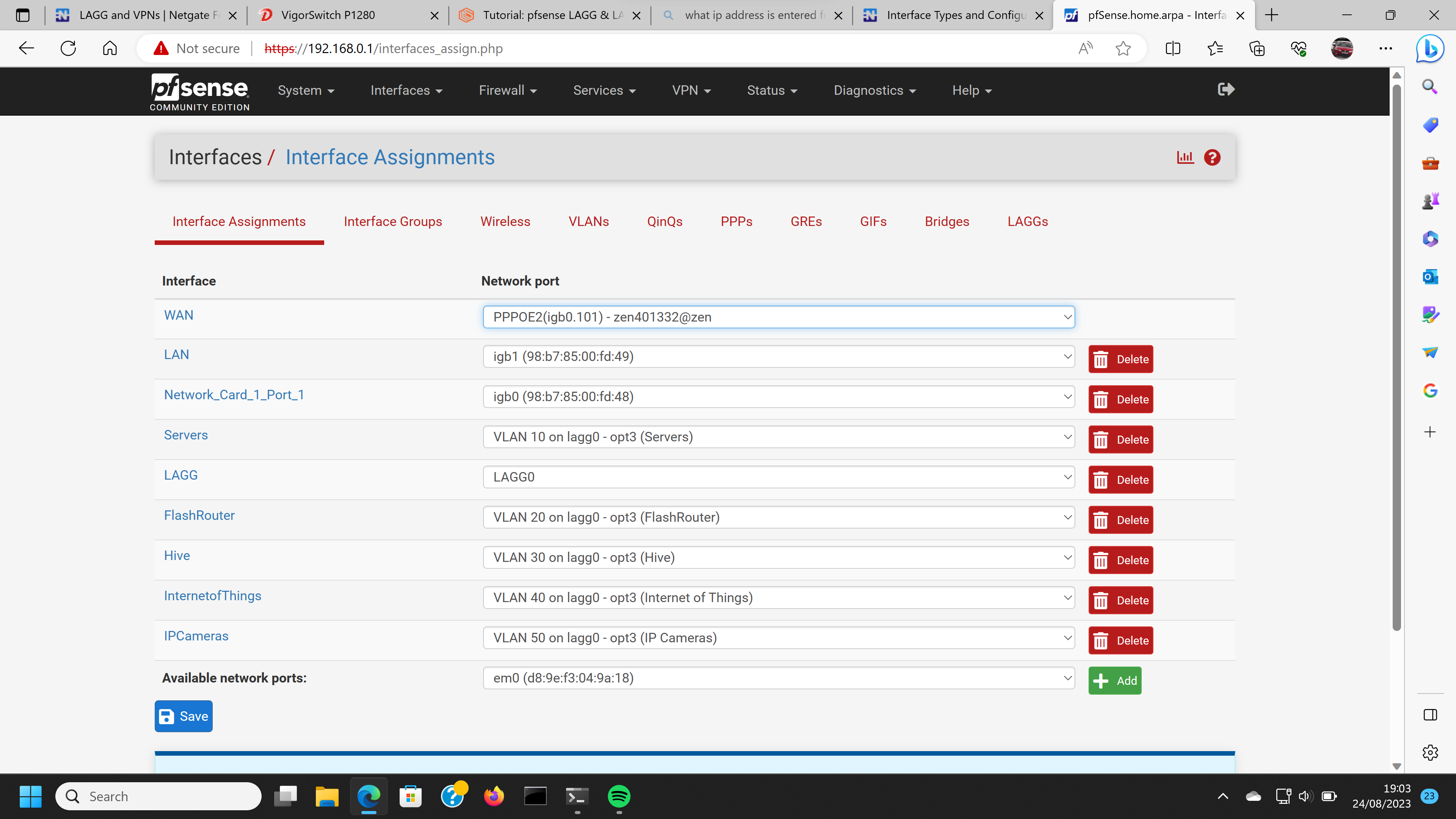

            stevencavanagh @stephenw10
            so, i currently have:

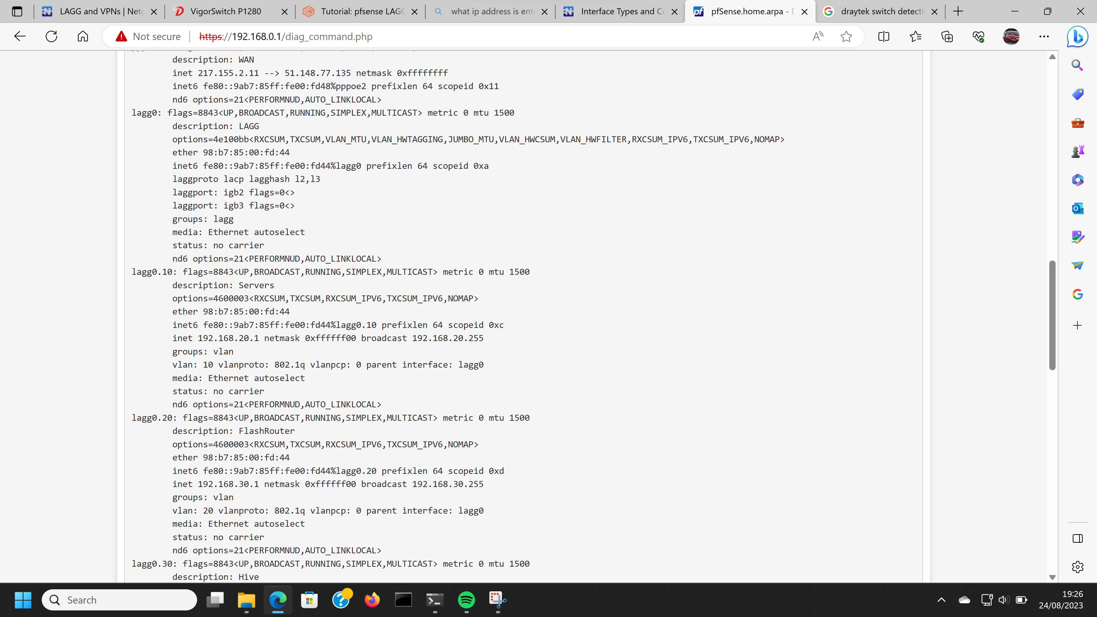

                stevencavanagh @stevencavanagh
                log for LAGG interface:-
                  Ok, so I'd guess there's some misconfiguration on the switch for the VLANs that are separating those 4 links and it's creating a loop.
