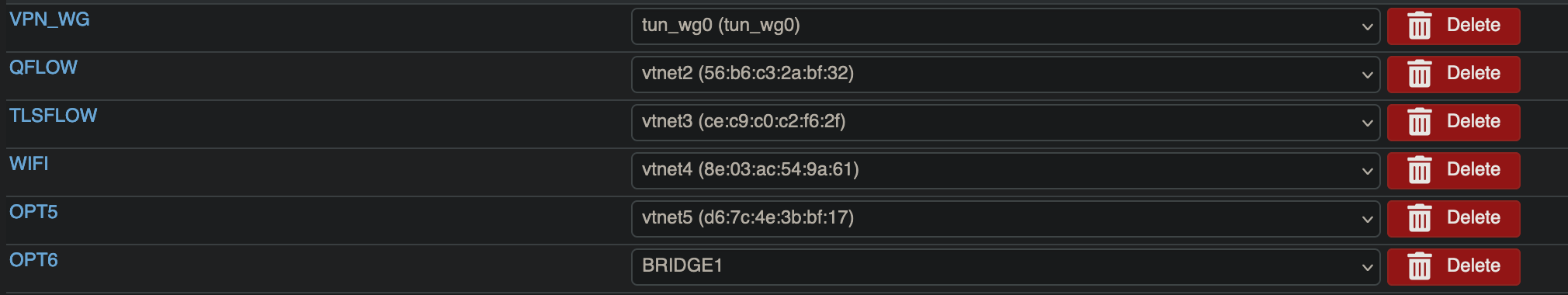

      I have PfSense on Proxmox and have several interfaces connected to it. Now I want to monitor all these interfaces on another VM (SecurityOnion) which I can do easy with the Proxmox Virtual Interfaces / Networks, but what is missing is the decrypted "VPN_WG" Wireguard Interface (the one were the already decrypted traffic can be observed) which is only visible from inside the PfSense VM.
      How can I now mirror the traffic to an interface that is reachable from outside, so the traffic on it can be inspected?
      I researched and found that adding a Bridge with Span Port is the solution but it doesn't work.
      Here is what I tried so far:
      1. Added a new Network in Proxmox and attached it to the PfSense VM
      2. Assigned it as OPT5 in PfSense
      3. Enabled it
      4. Created new Bridge, with "VPN_WG" being selected as the Member Interfaces and "OPT5" as a Span Port:
      1. Assigned the new BRIDGE01 as "OPT6":
      1. Enable "OPT6" as well.
      Still there is no packet coming to the OPT5 interface even though VPN_WG is receiving packets.
      I tried the same thing with the "LAN" interface as the member interface and it worked with no problem, but it seems impossible on the VPN_WG interface.
      I already asked in the general section, but they agreed that posting it here would be a good idea, as people here may know more about why I can't bridge this specific interface.
      If anyone can help me I would really appreciate it.
