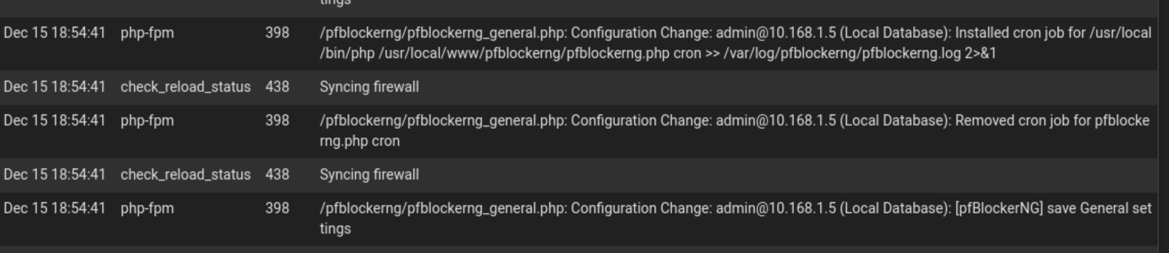

            @johnpoz I am also trying to disable automatic updates for pfBlocker. I want to do this because if it automatically updates and an update has a defect in it, it's difficult to troubleshoot why something suddenly stopped working. It's much easier to troubleshoot if something breaks immediately after I manually execute a change.
            This happened once already when somehow 9.9.9.9 dns service got put into a blocklist. That was a very disruptive defect after an automatic update. I don't want it happening again.
            I have disabled cron like @focheur91300 did, and it runs hourly and does nothing, however, it also still runs daily at 1am as configured on the disabled cron setup page:

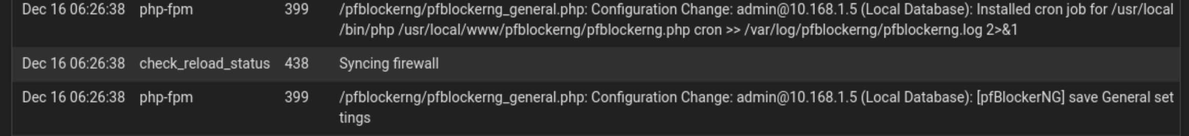

              If you mark the cron job as disabled on the GUI (the general settings page),
              The sequence the code uses is briefly this:
              1. remove the entry for this from the config
              2. remove the crontab
              3. reconfigure the crontab based on the config
                if you look at the system log after marking it as disabled and saving you will notice that it says it is removed (step 2), but then that it is added (step 3) .
                like this
              if you cat /etc/crontab you will see the job is still there.

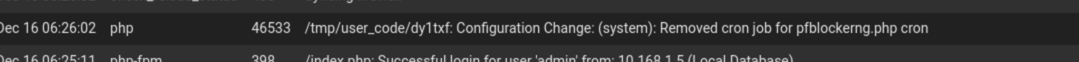

              Next if you manually execute the function that is removing it from the crontab (step 2) - and you can actually go to diagnostics - command and run it in the php window.
              install_cron_job('pfblockerng.php cron', false);
              Doing so will get you a log entry similar to this
              and now if you cat /etc/crontab the job is actually gone and therefore won't run.

              if you now go back to the general settings and save the the page again, you will log the save install without the corresponding remove
              Step 1 is the fail point
              Step 2 is the remove line from crontab which is the command above (works)
              Step 3 runs as part of the save (and clearly works as intended, refreshing the crontab as it should based on the current config)
