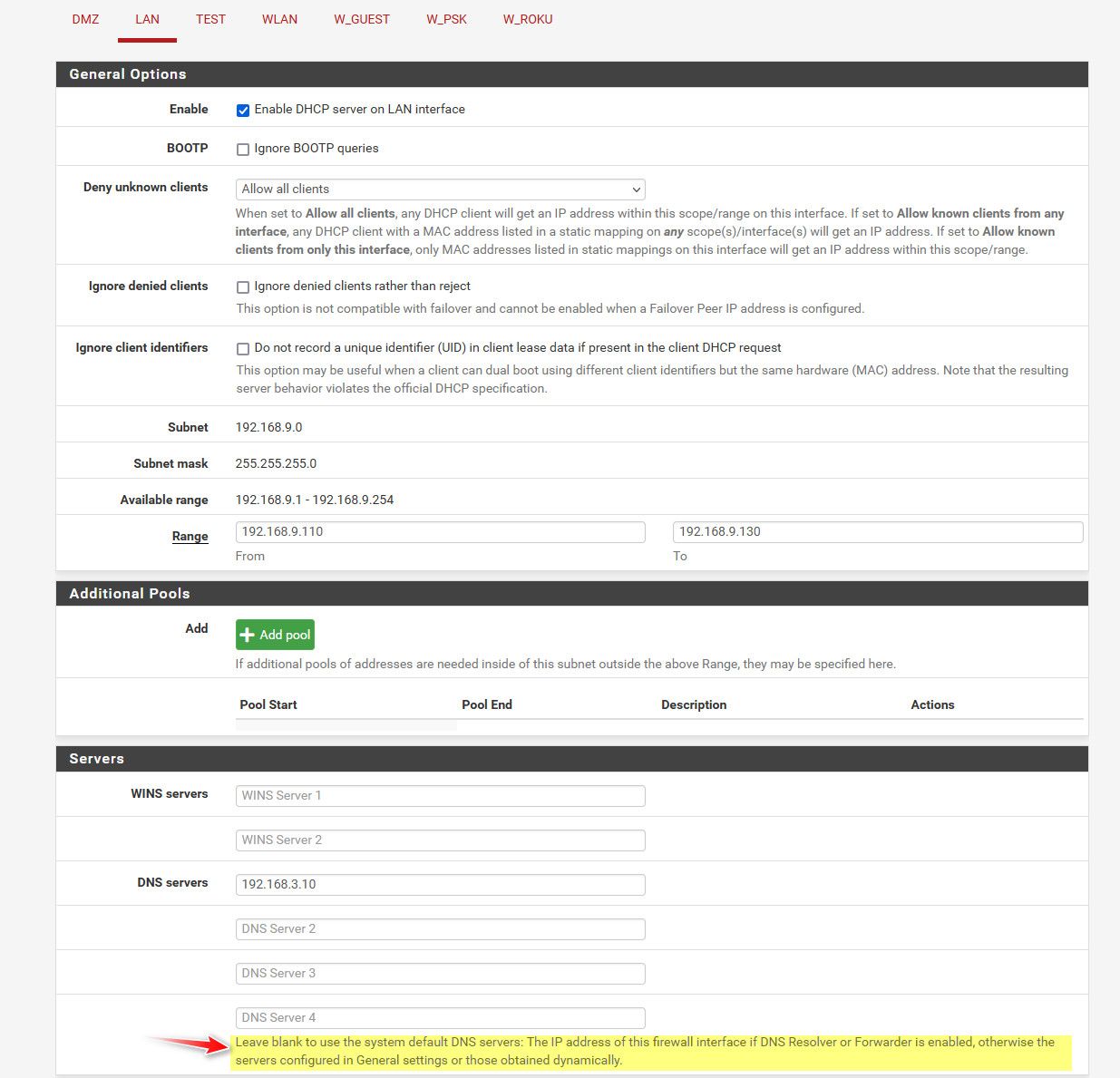

Here is the screenshot of LAN
AND the SERVER portion of the screenshot
What you are saying is the SERVER portion should be BLANKED out so that all routes will be thru the pfsense router not thru google - Have I understaood the concept?
@johnpoz said in How to setup local domain in local network that everyone:
I noticed in your setup you had pfblocker installed. If clients do not point to pfsense for their dns - pfblocker isnt really going to work.
you are absolutely RIGHT! I was really ignorant.....I have NOW blanked out the server portion and rebooted my PC.
