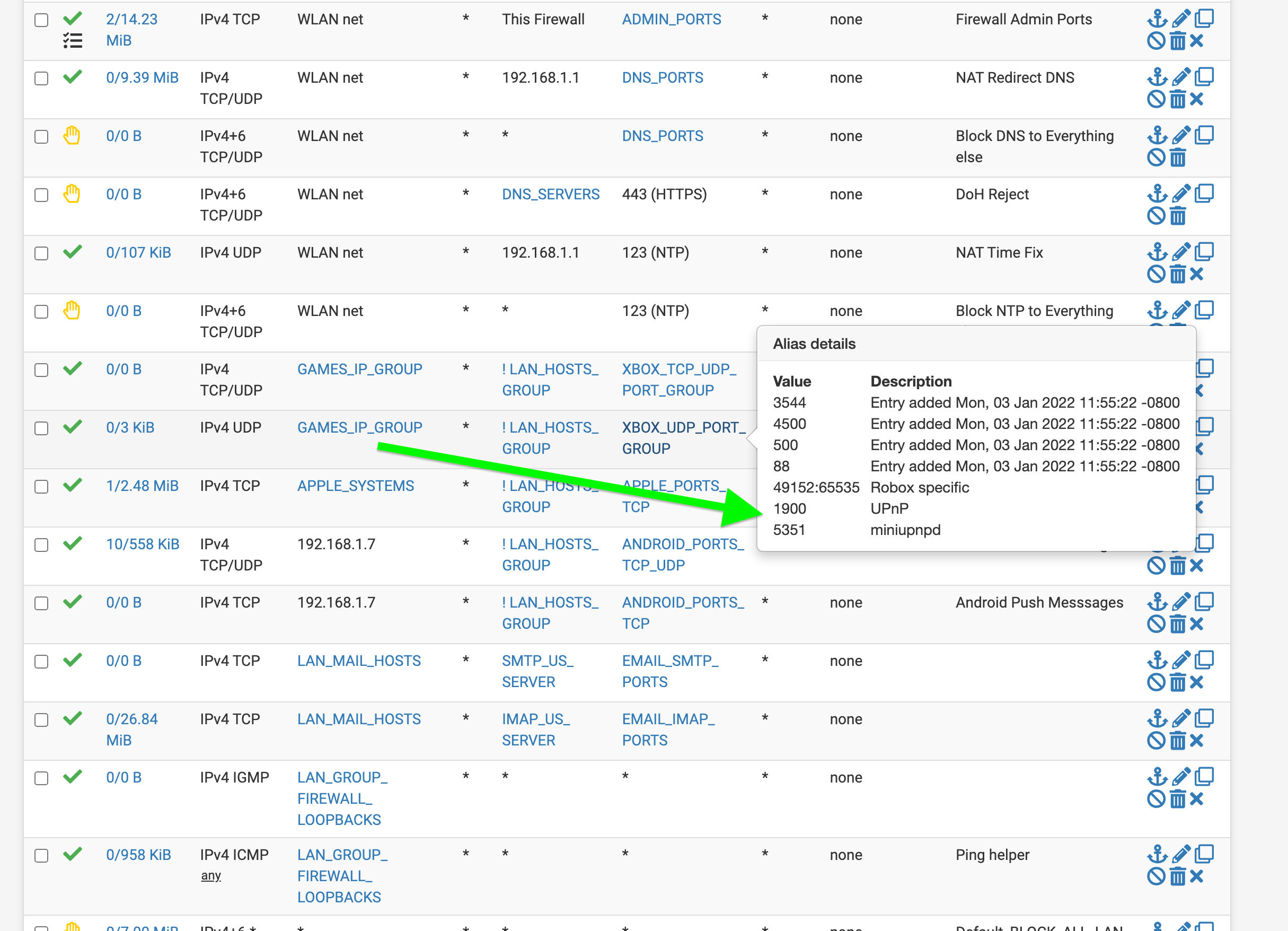

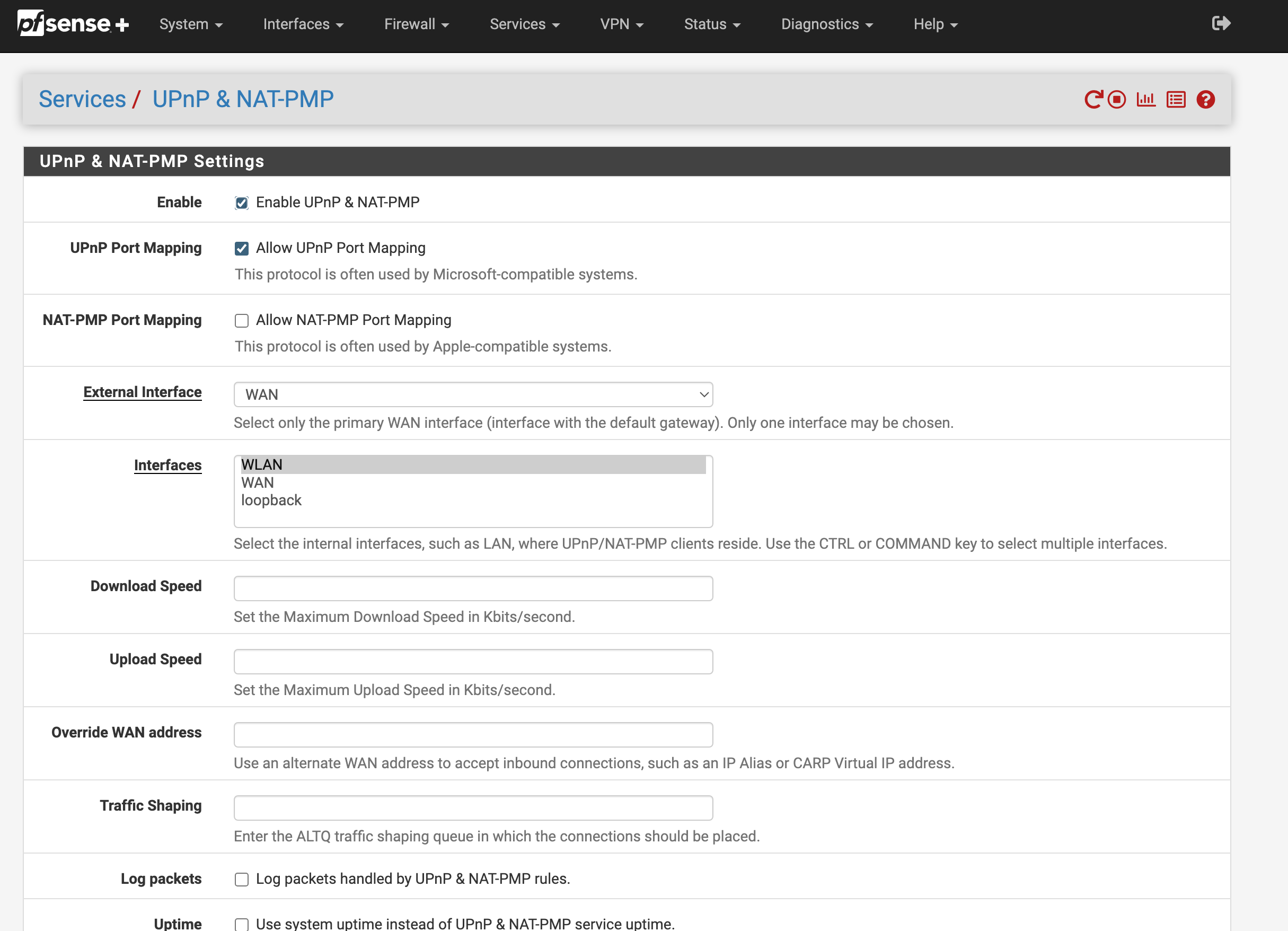

      @rpm5099 have you also selected that interface inside of mini UPnP?
      WLAN is selected on mine for example, you must also open port 1900 for whatever needs UPnP
      Check what ports are required
