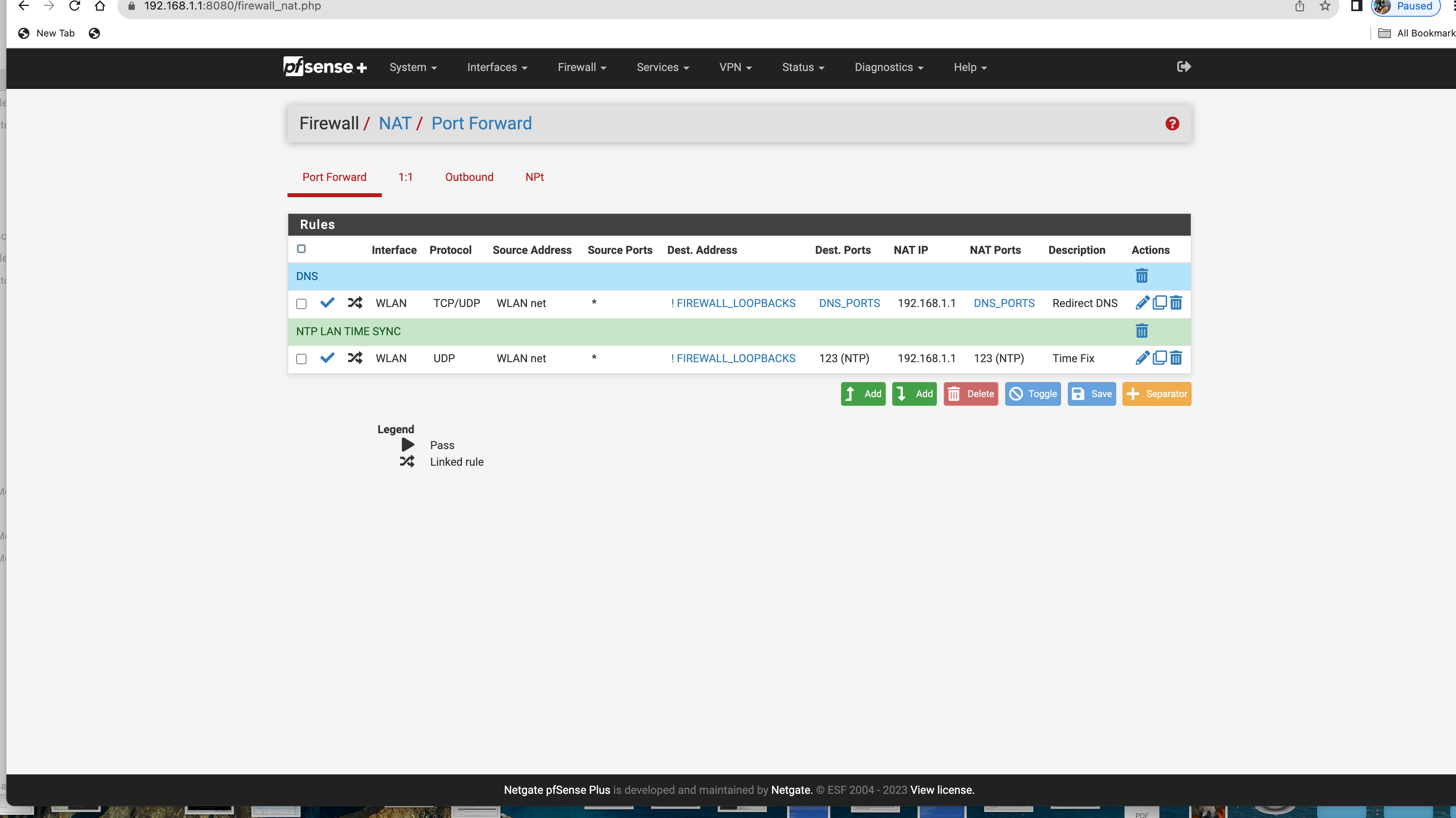

                  @mcury why is your nat only using the loop back? Why not use both the firewall and the loopback? Do a negated rule anything but the alias that has the loopback and firewall redirect to the firewall.
                  Make sure to upvote
                    mcury Rebel Alliance @JonathanLee
                    @JonathanLee That will redirect any connections that is not for WIFI address port 53, to 127.0.0.1:53, forcing the use of pfsense's DNS server (unbound).
                    pfsense itself is using 127.0.0.1 too.
                    JonathanLeeJ O 2 Replies Last reply Reply Quote 1

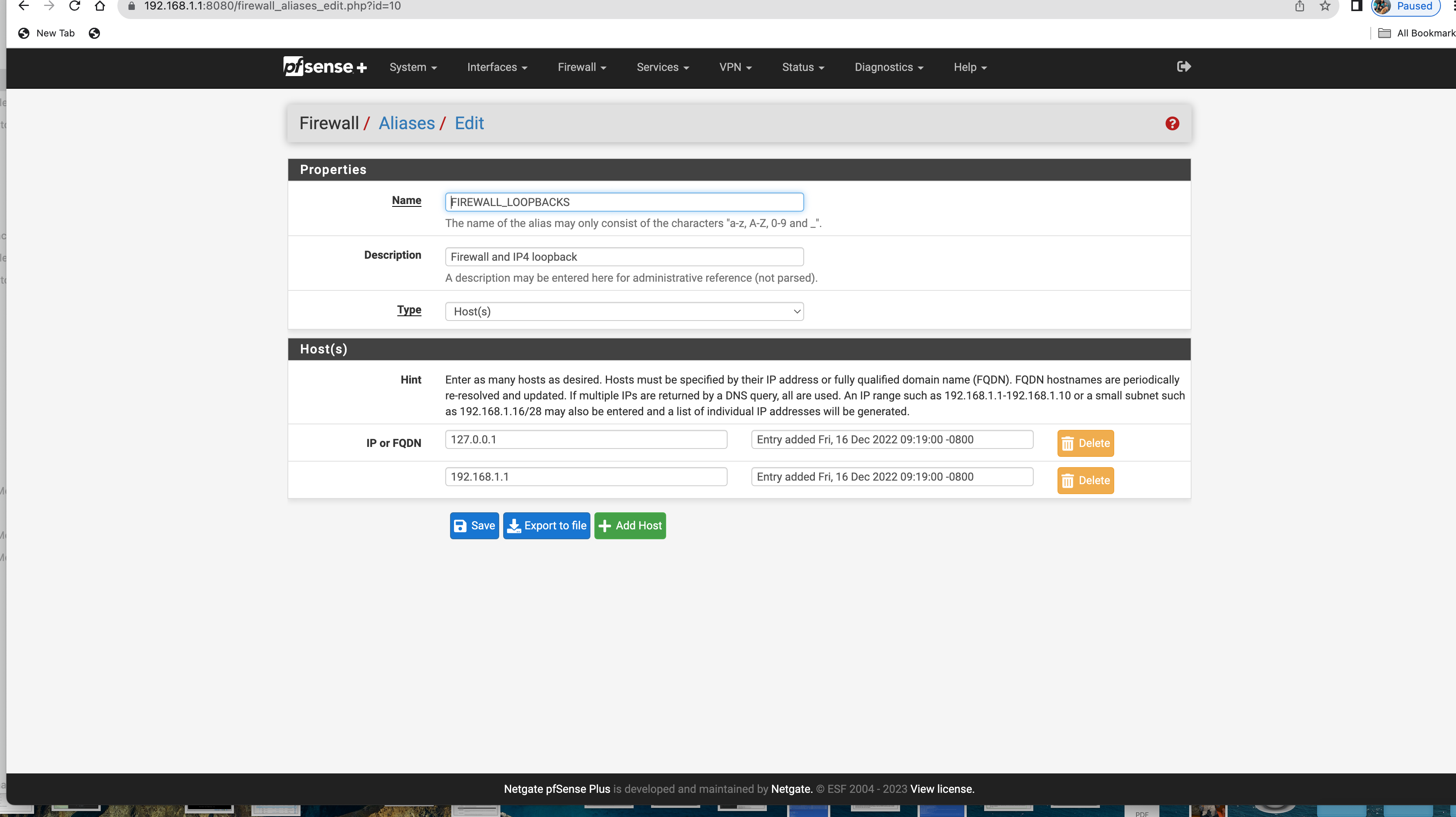

                      @mcury This is how I am doing mine as it would never work for me with only the loopback
                      (Netgated rule)
                      (alias)

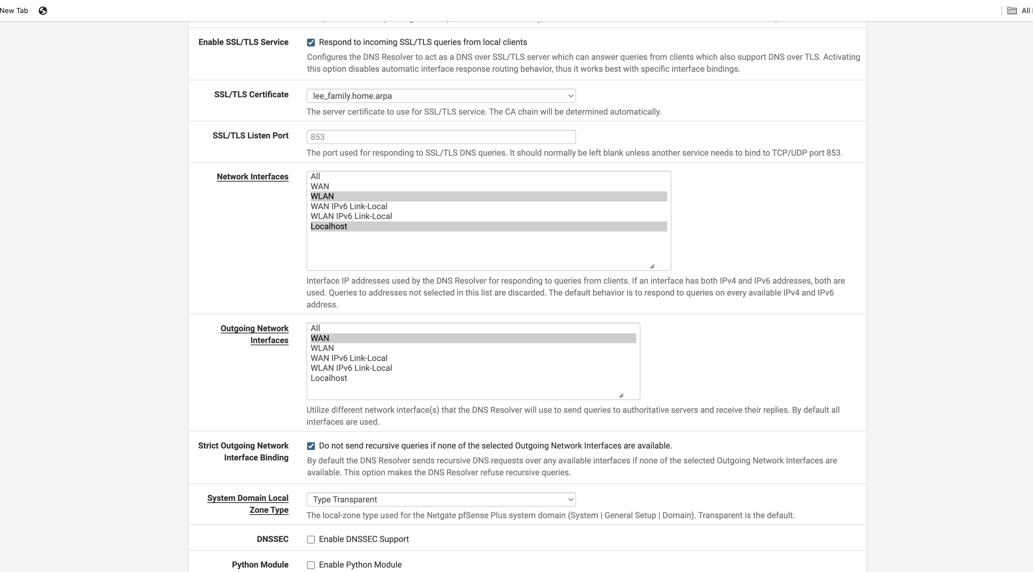

                        hmm, I wonder if your Unbound is listening in the loopback ?
                        For this to work, Unbound needs to be listening in the loopback too.
                          Loopback used DNS over TLS SSL

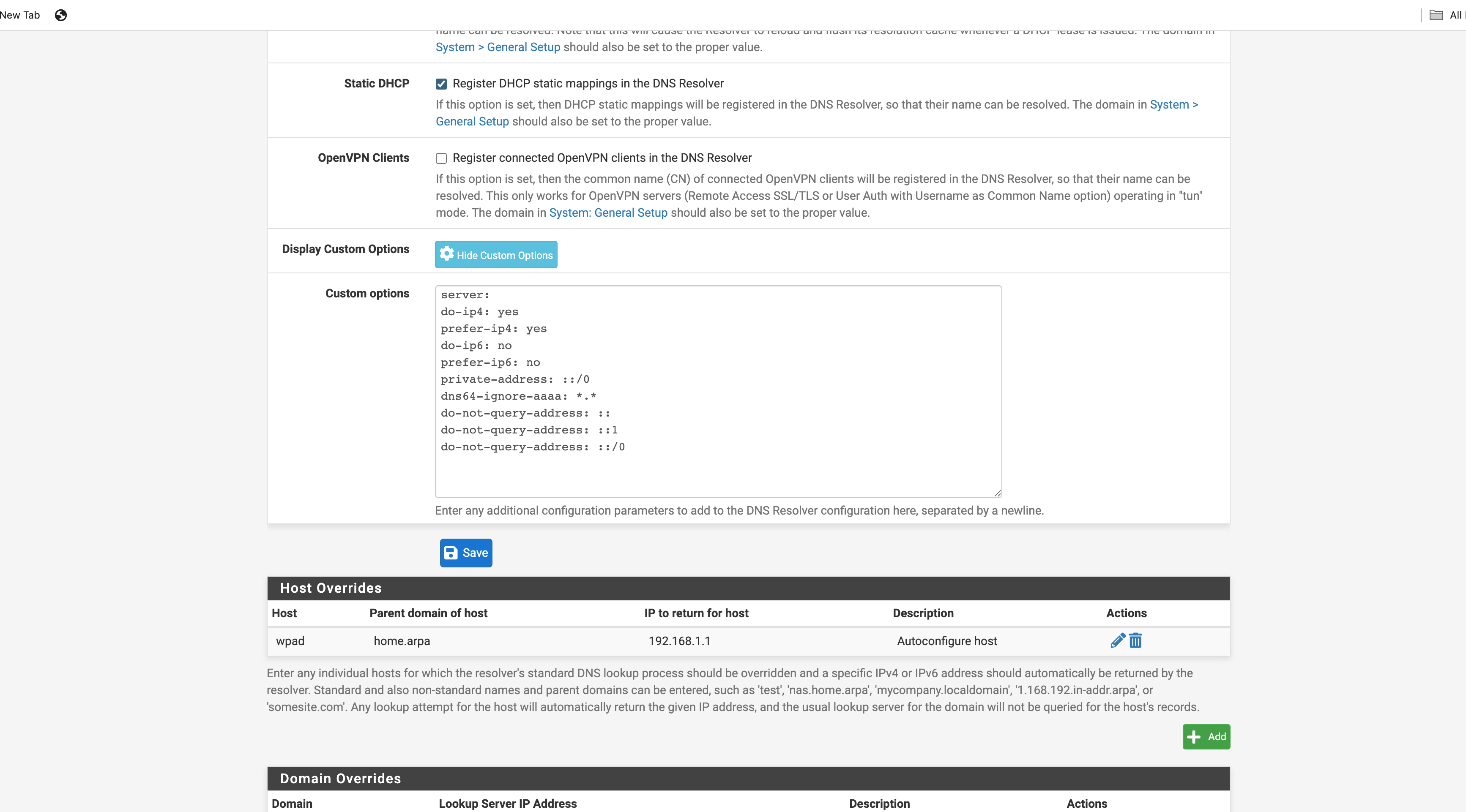

                          Custom options because of ipv4 only isp restrictions

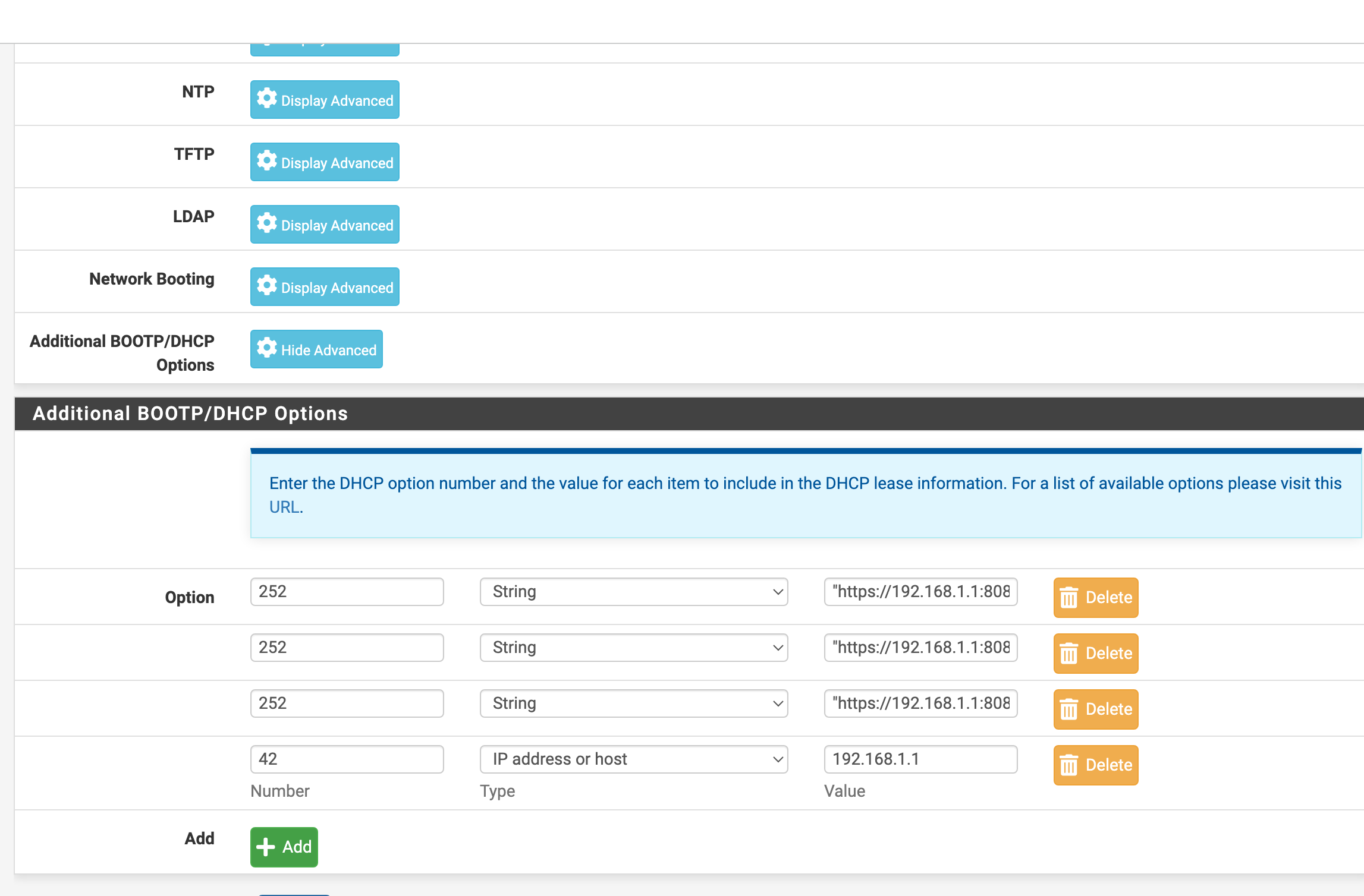

                          WPAD in use for proxy with DHCP options 252 and 42 enabled
