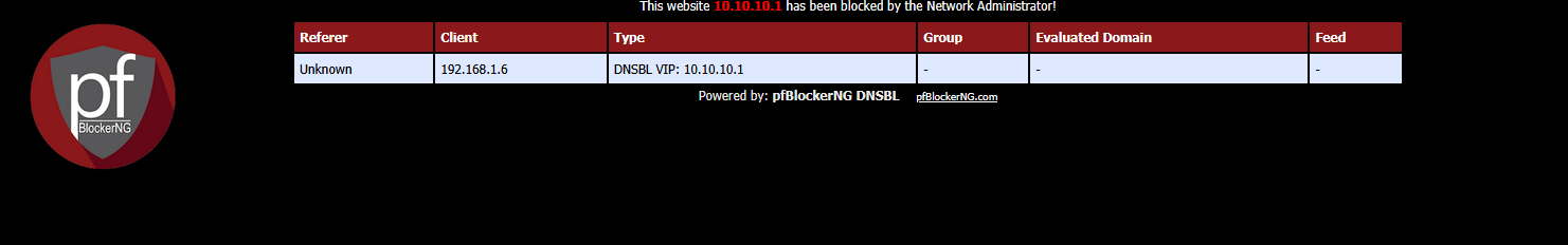

                    Question : what does this text "GET / HTTP/1.1|Mozilla/5.0 (Windows NT 10.0; Win64; x64) AppleWebKit/537.36 (KHTML like Gecko) Chrome/117.0.0.0 Safari/537.36 " doing in a DNS request ?
                    Also : a DNS 'server' will not send upstream the original IP that initially for a DNS request.
                    Like unbound talking to "8.8.8.8" : "Hey, 192.168.10.45 wanted to know what the A record of "google.com" is".
                    Your ' internal DNS-Server' won't do neither. So, 'pfBlockerng' (unbound) DNS logs can't produce that info if the request came from an intermediate DNS server. It can only know about 'who', the IP the request came from, was asking not who was originally asking.
                    What probably happens is that DNSBL does its job, finds a DNSBL entry so it returns the pfBlockerng web server IP (the one that shows the "You are blocked " page).
                    Now, as the initial client was a web browser, it got redirected to this web server IP, this is the (default) 10.10.10.1
                    An that web server will 'see' the IP of the client.

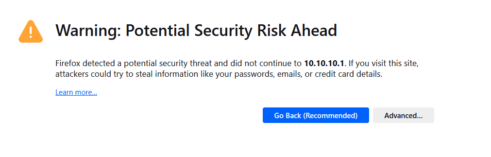

                      @Gertjan Probably your theory is right and the client IP comes from the pfblockerng webserver. So this IP could also be available in python mode.
                      What's not right is, that a https redirect will fail. It simply throws a certificate issue warning. So the client actually connects to the pfblockerng websever, but the browser displays a cert warning. Most users will close the site then, but if you ignore the warning you will see the block page.
                      So if the Client-IP comes from this webserver, it does not matter if its http or https.

                        The thing is, you know that, and you probably know that black part of the URL is showing what is your pfSense device.
                        Like this URL :
                        The netgate.com part is in black. Because that the one that is important. That's the one matching the certificate from Netgate. So, ok, you know what you do. Internet isn't a dangerous place for you.
                        Now for the other 99,x % of us : if they all start to click through this "wrong cert" warning, pishing sites and other fake ones will have a bright future front of them.
                        So I tell them always : don't think - close it right away. Do not click any where.
                        IMHO : we as pfSense admins shouldn't contribute to the fact that our network users see this kind of info. It will introduce bad habits. And these 'stupid' users will pay the price later on.
                        Their IP will get logged of course, thus feeding the pfBlockerng stats.

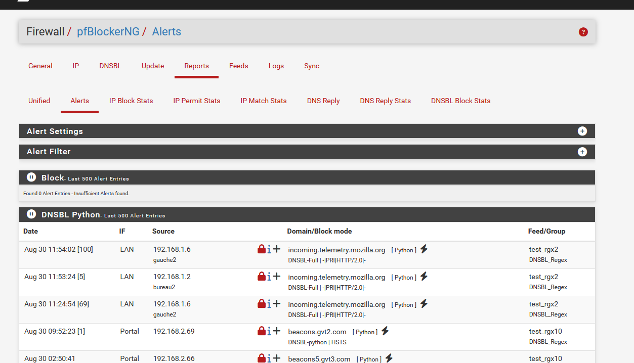

                          seraph77
                          I just ran into the exact same issue after switching to python mode. Since the update to 24.07.1 I have no more logs (unified /Alerts) when in Unbound mode. Before it worked like a charm. It still blocks but does not report. So I believe there's a bug somehow. When switching to Python mode, the logs are created again , but only showing the IP of the internal DNS, which is not that helpful for analysis. Is there a way to fix either of it (Python mode reporting source client ip or Unbound logging again as before)?

                            You don't see something like this :
                            @seraph77 said in PFBlockerNG Python-Mode - Source-IP in Reports:
                            ? Where ?
                              seraph77 @Gertjan
                              @Gertjan I see those entry's in Python mode only (Unified and Alerts Log). And there also only, the request coming from the internal dns server (before the update I saw the IP of the Clients under Unified and Alerts mode Unbound only). With unbound only mode, the logs are not generated now (not in Unified and not in Alerts). Since I did read your previous Posts I decided to switch to Domain Overrides. So just all internal DNS requests would be redirected to my internal dns. So now I see all the Client IP's again in Python mode (Unified and Alerts log). I guess it's just the way it is at the moment. Probably DNS is anyway faster with this config. What's still not clear to me is, if i would put Null Block (logging) would it be faster than going throug DNSBL webserver/VIP?
                              BBcan177B GertjanG 2 Replies Last reply Reply Quote 0

                                    If a listed == blocked domain was requested, instead of resolving it, pfBlocker intercepts the request, and 'teminates' it for unbound right away with the answer '0.0.0.0', (the "Null Block (logging)) option which will indicate the requesting source, i.e. your web browser, that their is no answer (no A or AAAA) so the content won't get loaded.
                                    When you select "DNSBL webserver/VIP" instead of "Null Block (logging), then an IP will be return, by default "10.10.10.1" which is an IP served by a pfBlockerng web interface.
                                    This means, if you where using a web server on the client, this 'page' would be loaded, and instead of the requested blocked domain name, this would be shown :
                                    but there is a but : this is pretty worthless.

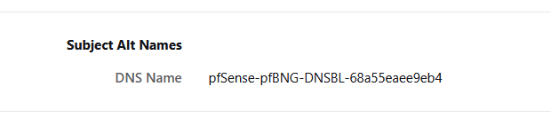

                                    These days, most http requests are not http any more, but https. This means the web browser will request a certificate from the pfBlockerng web server.
                                    You'll see :
                                    because the browser was requesting initially "a-pfblockerng-blocked-host.tld" and it got back an IP for this host : "10.10.10.1". When connecting to it using https, the web browser will ask for a certicate and here it comes : this certiccate will not / can not contain the SAN "a-pfblockerng-blocked-host.tld" but something else. click on "Advanced" and you'll see :
                                    So, two issues : the cert is self signed, which is not a good sign when you (try to) visit a public web site, and - not even shown but you can have a look at the cert : it doesn't contain "a-pfblockerng-blocked-host.tld" neither.
                                    Mine showed :
                                    which isn't "a-pfblockerng-blocked-host.tld" for sure.
