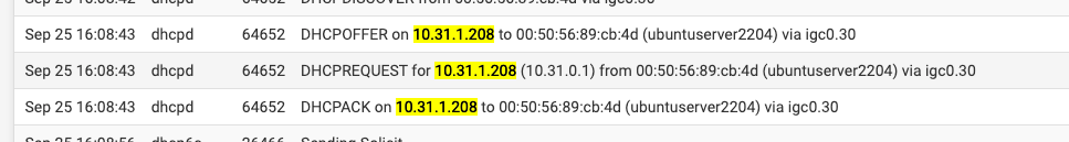

      The VMs have different MAC addresses, but when they start they receive the same IP.
      What could be wrong?
      DHCP Logs

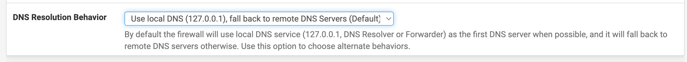

                    • NollipfSenseN
                      NollipfSense @aloisiobilck
                      @aloisiobilck Here System > General

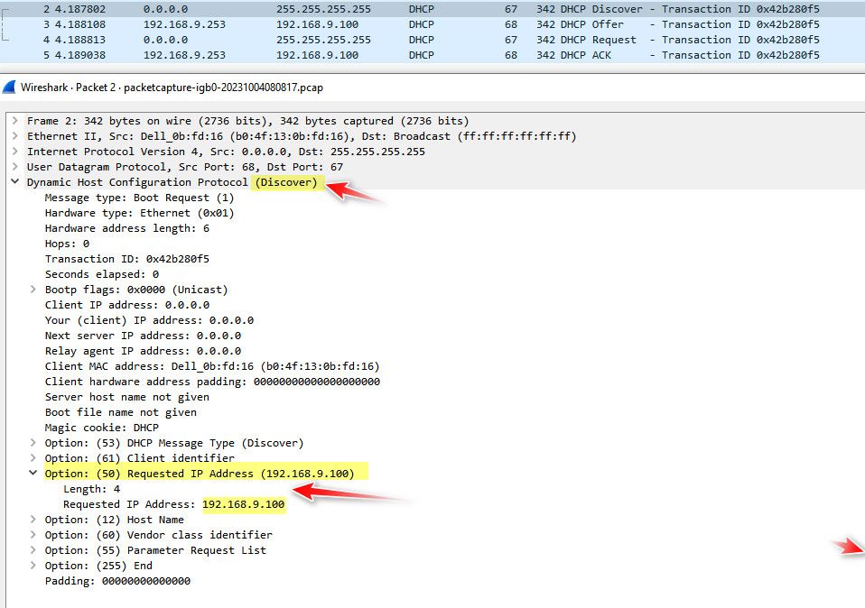

                        I am not 100% on this - but if the client requests its last IP, then that would be offered to it even if the mac is different. I can try and duplicate that..
                        You need to look in the discover to see if client is asking for its old IP..
                        For example - here is client asking for the IP it had last time..

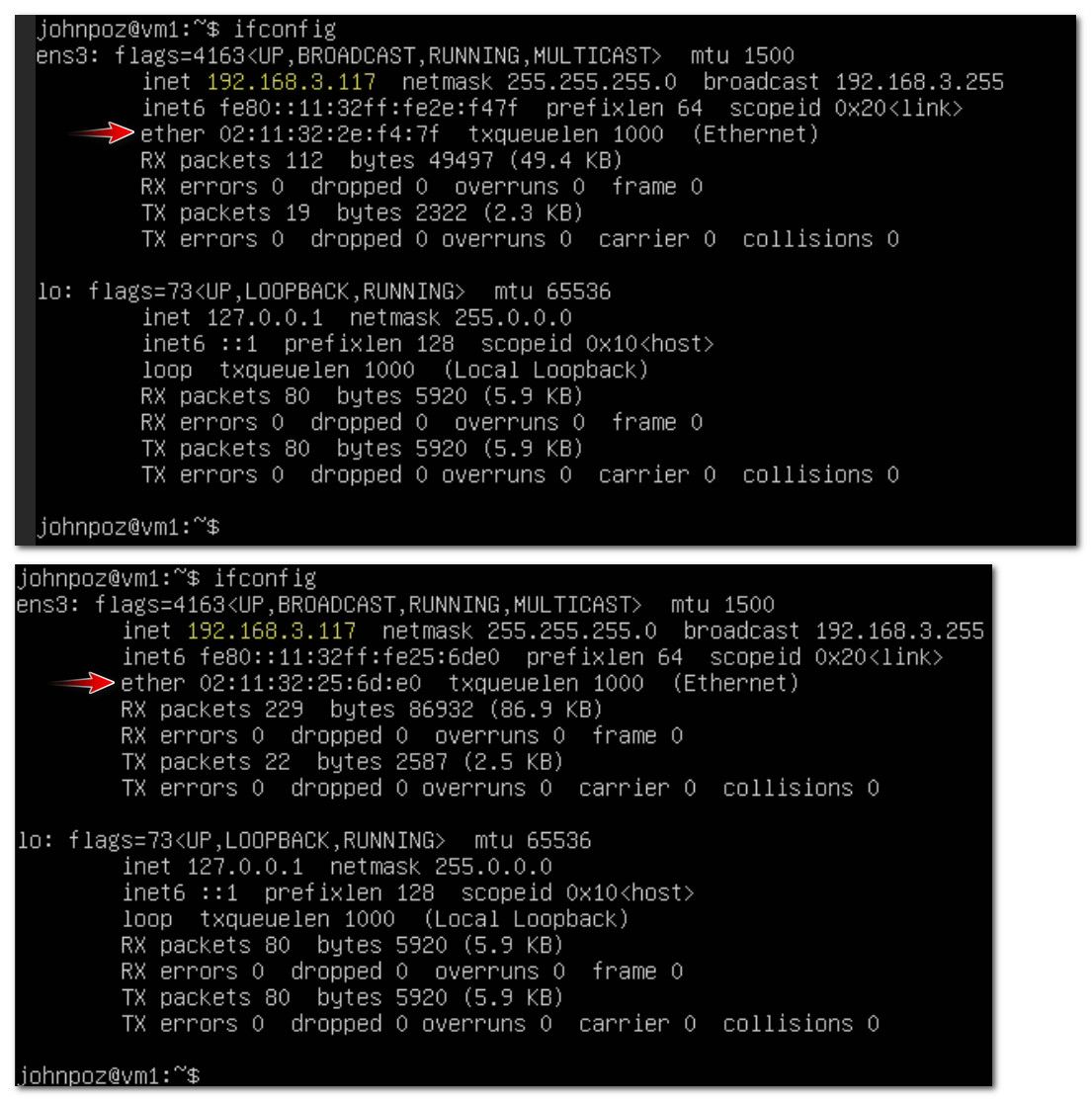

                            As a simple test I was going to fire up a vm.. have it get an IP, and then shut it down and change its mac and then boot it and see if it requests the same IP and gets it.. Or could just create another clone of the vm, leaving it online and then fire up the clone with different mac and see if also requests - but this time it shouldn't get it because there is something actually online with the IP.

                                Example from my previous example of client requesting a specific IP - can see that the client was probing for that IP 192.168.9.100 that it was requesting
                                A probe is different than a normal arp, asking hey this is IP X who has IP Y..

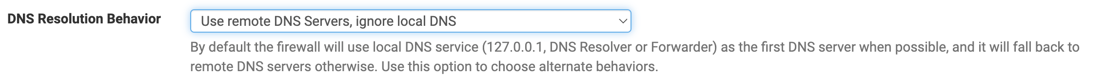

                                  aloisiobilck @NollipfSense
                                  @NollipfSense
                                  Sorry for the delay in answering. I changed the DNS, but the problem continues.

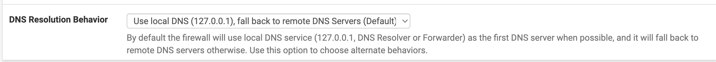

                                      aloisiobilck @johnpoz
                                      @johnpoz
                                      As @NollipfSense asked, I changed it here. I also don't know what DNS has to do with DHCP.
                                      From
                                      to:
                                      • johnpozJ
                                        johnpoz LAYER 8 Global Moderator @aloisiobilck
                                        @aloisiobilck yeah that has zero to do with it that is for sure. And I highly doubt you want pfsense to not be able to resolve its own records.. The default is what you would most likely.. I resolve so there is nothing to fall back to.. So I use local only.. But again that has zero to do with anything..
