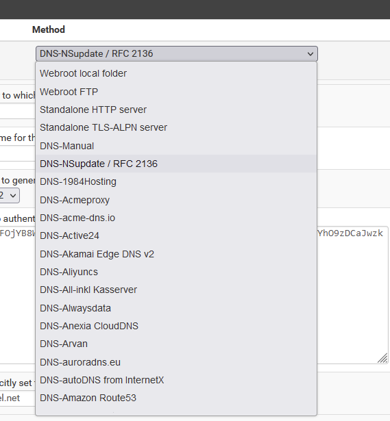

            If your domain registrar is on this list and you can find the correct acme DNS API :
            edit :
            Better safe then sorry : Set DNS-Sleep to 120 seconds or more.

                The list represents the methods.

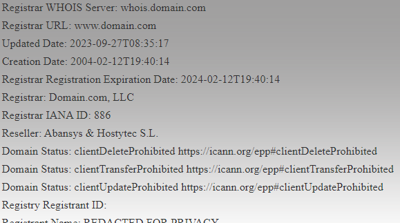

                Check with your registrar what method they propose.
                Who is it ?
                  jperezme @Gertjan
                  @Gertjan
                    Gertjan @jperezme
                    @jperezme
                    ๐Ÿ˜ข
                    If domain.com is your registrar, all I (not me, I use Google, so blame them if I'm mistaken) could find is :
                    https://www.domain.com/help/article/enable-your-free-ssl-certificate
                    and that means : If you have a domain name with them, you can activate a free "Letsencrypt" certicate for your site (hosted on their equipment). You probably can't download the certificate files.

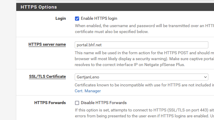

                    Also : when you rent a domain name, and you want to use it for your local captive portal so login takes place using an url like https://portal.your-local-site.tld then you shouldn't use the "your-local-site.tld" domain name on the Internet. It still exists on the Internet, of course, as you rented it.
                    Example.
                    I have a hotel, which means clients are always asking : what is your hotel's Wifi ?
                    I have a domain name, "bhf.net" which I use for my LAN devices, and my captive portal, so I can support the https login page for my portal.
                    The acme pfSense package handles the wild card domain "bhf.net" renewal every 60 days.
                    I had also declared "portal.bhf.net" (added to the Resolver page : Host overrides) "portal.bhf.net" where it points to 192.168.2.1, which my pfSense captive portal dedicated interface.
                    On the captive portal settings page, I select this :
                    and done.
                    The pfSense GUI web server uses the same certificate, so https access for the GUI is now also set up.

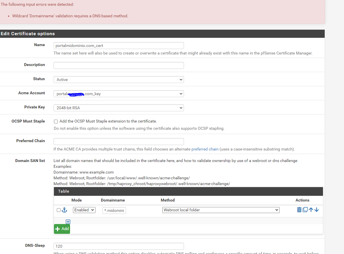

                      I still don't understand how I can tell Acme when I create the certificate which DNS method to use.
                      I have created in DNS to resolve the entry portal.midominio.com pointing to the address 172.16.30.1, which is the IP of the captive portal.
                        Gertjan @jperezme
                        That's a wild card.

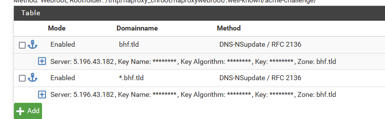

                        These are the "rules" :
                        You have to do this :
                        add two domainname's - as shown in the image.
                        One with the domain name only, the other with a *. in front of it.
                        And, as mentioned here : Let's encrypt Challenge types :
                        DNS-01 challenge
                        This challenge asks you to prove that you control the DNS for your domain name by putting a specific value in a TXT record under that domain name. It is harder to configure than HTTP-01, but can work in scenarios that HTTP-01 canโ€™t. It also allows you to issue wildcard certificates.
                        HTTP-01, like your selected webroot method, can't.
                          jperezme
                          I have used wild card because you told me previus message i only need works with portal.midominio.com
                          I suppose i ddn't understand you.
