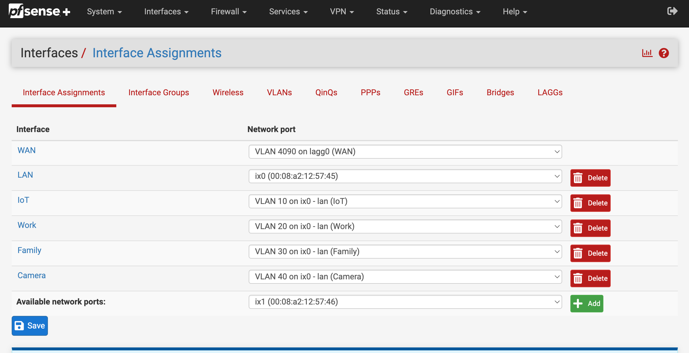

      LAN set up on (ix0), VLANs (ix0.10, ix0.20, ix0.30, ix0.40)

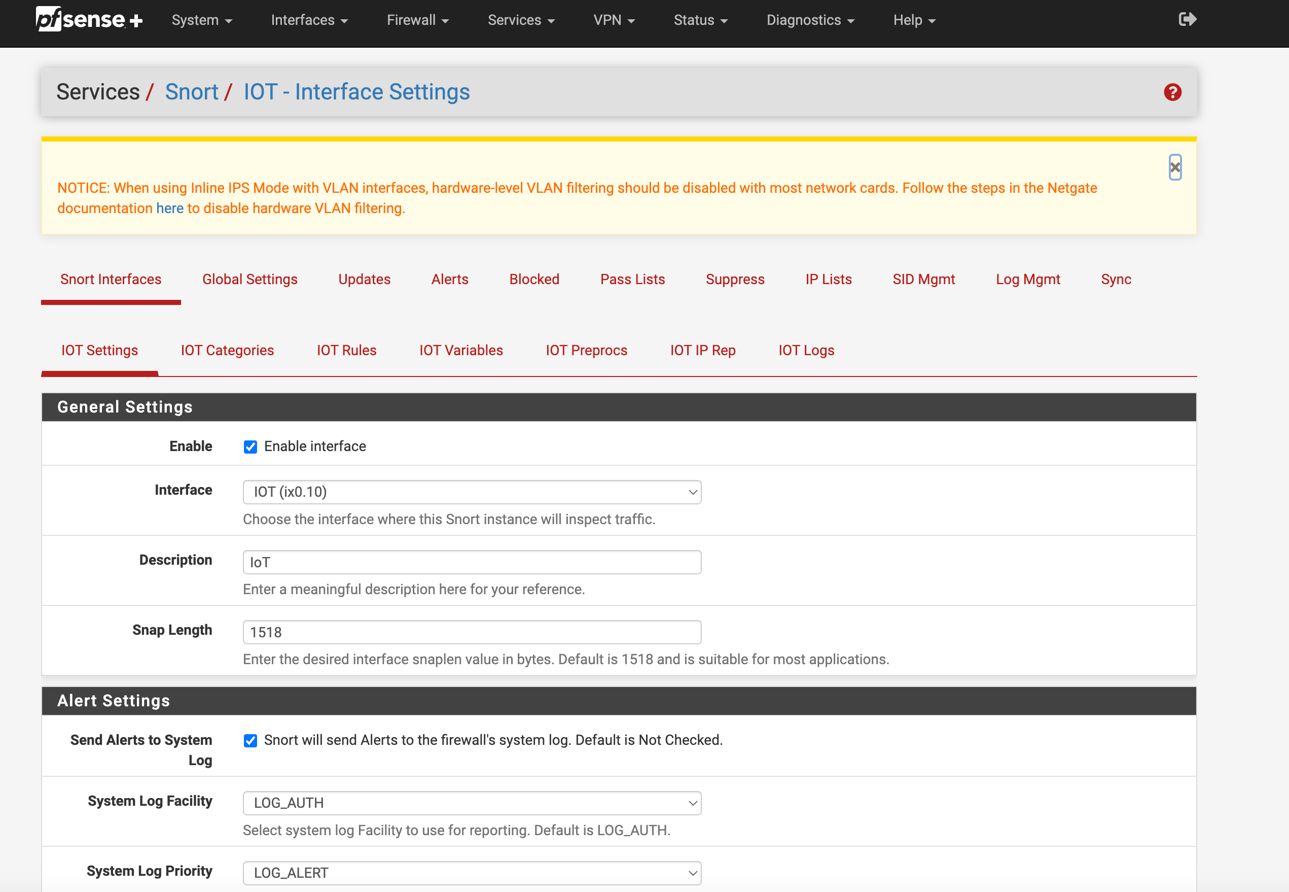

      While setting up Snort in Inline Blocking mode, I get the message "NOTICE: When using Inline IPS Mode with VLAN interfaces, hardware-level VLAN filtering should be disabled with most network cards." and asks me to refer to Intel ix4 cards in the below link.
      https://docs.netgate.com/pfsense/en/latest/hardware/tune.html#intel-ix-4-cards
      Also, hardware offloading is disabled.

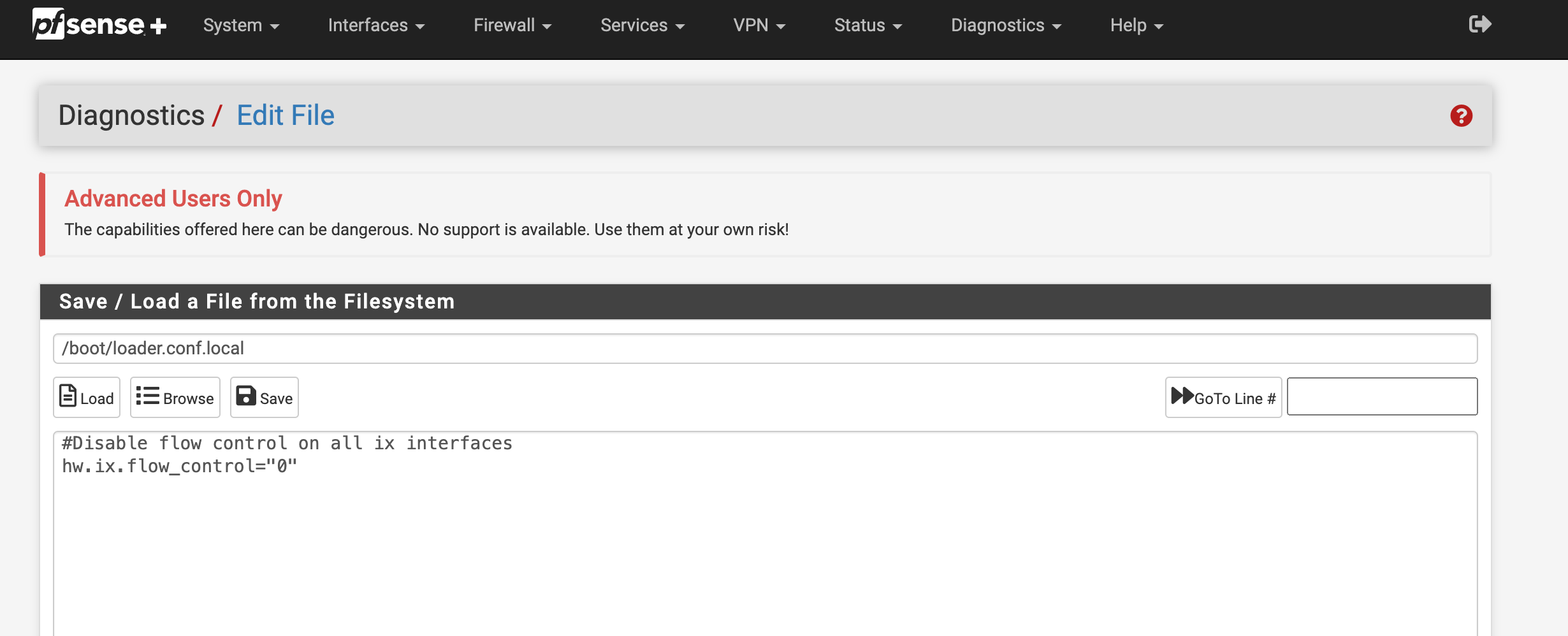

      As suggested on this page, I have disabled Flow Control on all ix interfaces.

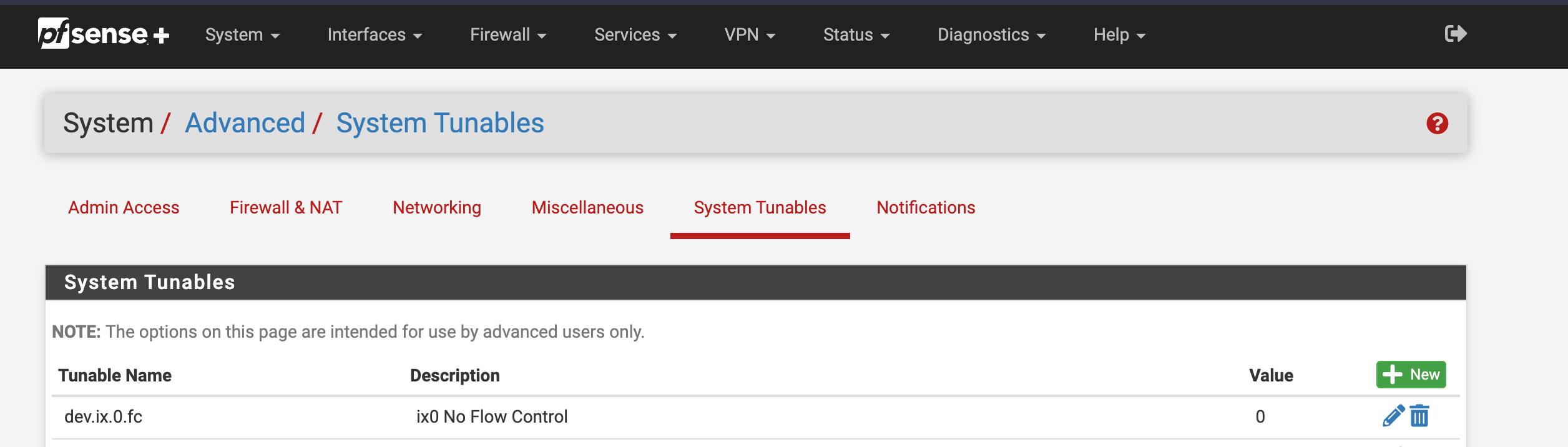

      Added a DEV system tunable entry (dev.ix.0.fc with value 0):

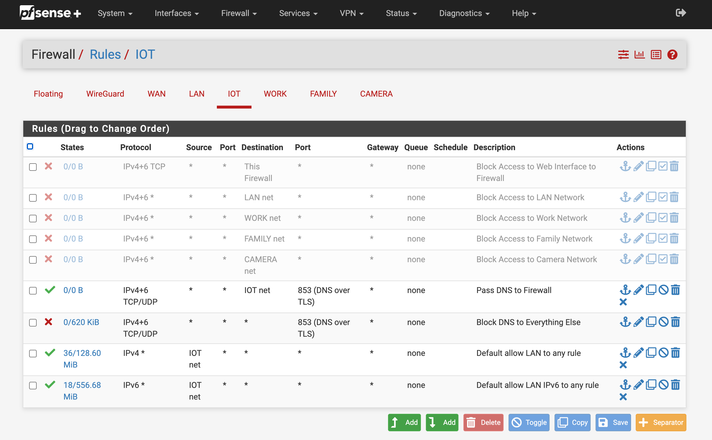

      Lastly, I have also disabled thee FW rules on all VLANs.

        Inline IPS Mode and VLANs is not supported. Your only option is to run a single Snort instance on the parent physical interface.
        Inline IPS Mode uses the netmap device within FreeBSD, and that device currently does not support operation with VLANs in native mode.
        You can try using a single Snort instance on the VLAN parent interface or else switch to Legacy Blocking Mode if you need individual Snort instances on each VLAN interface.
