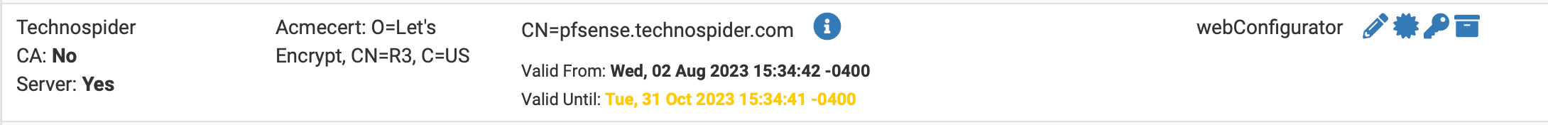

I have successfully installed Acme certs, and am issuing 3 certificates.
All 3 have successfully renewed as expected, but the one in use by webConfig is still showing that it's going to expire today even though there's a newer cert to be had.
I have per the instructions (Restart the GUI on this firewall: Select "Shell Command" and enter /etc/rc.restart_webgui) set the GUI to restart.
Not sure how to push the updated cert to the list... -
Alright, I see what I did.
At some point when I first set up the certs I renamed one after creating it.
That caused a 2nd copy with the new name to be created in the list of certs and so webconfig didn't know to jump over to it on renewal.
I pointed the webgui to the new name and then deleted the old cert.
We'll see how it all goes in another 50 days or so but I expect everything will be fine. -

If you don't want to wait, just hit the
Keep in mind : don't hit this button to often ^^
Also : domain name validation is cached for a week (10 days) or so on the LE side.
So, a real test with all bells and whistles is possible after this period. -
@Gertjan Right, I don't mind waiting. I just hit that button about a week ago when I first noticed the issue and wanted to see if forcing an update would solve it.
