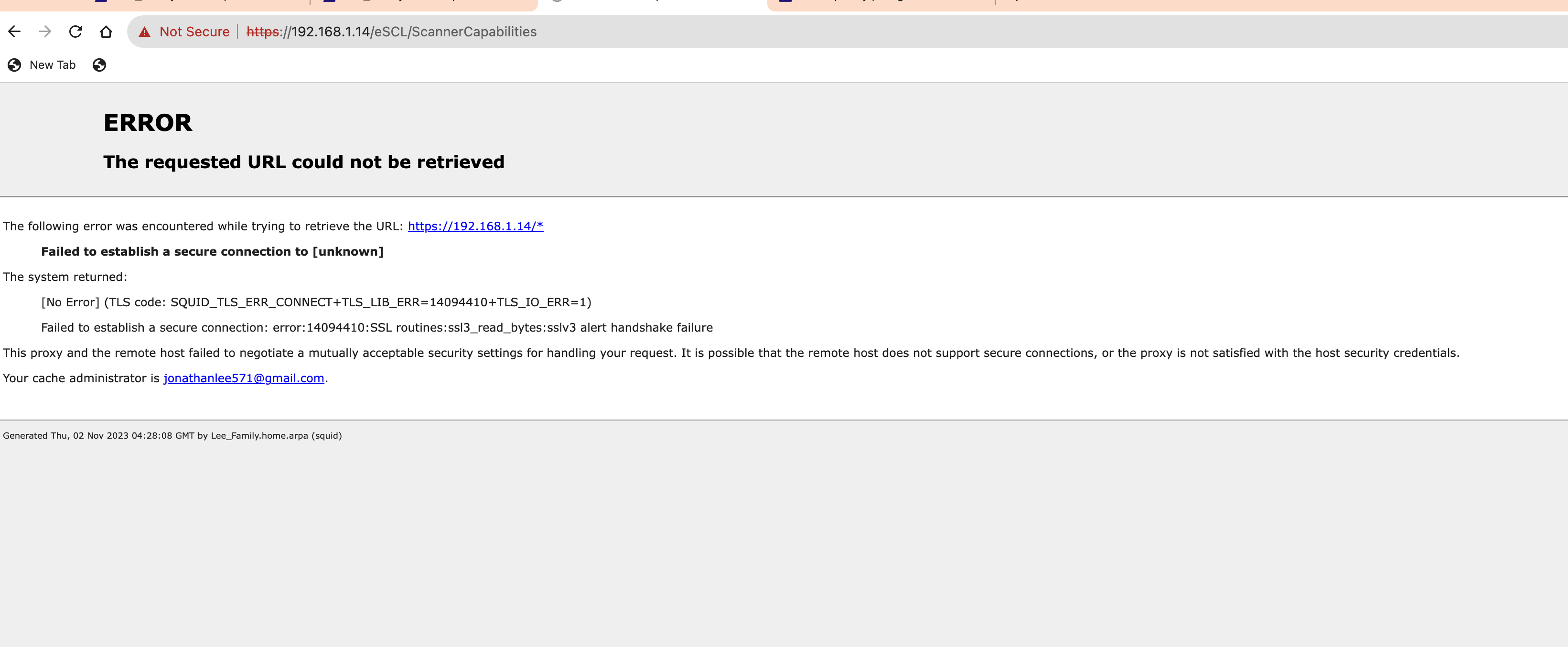

      However if I attempt to use https I get this response . .. I use SSL intercept so what I have a root CA installed right...

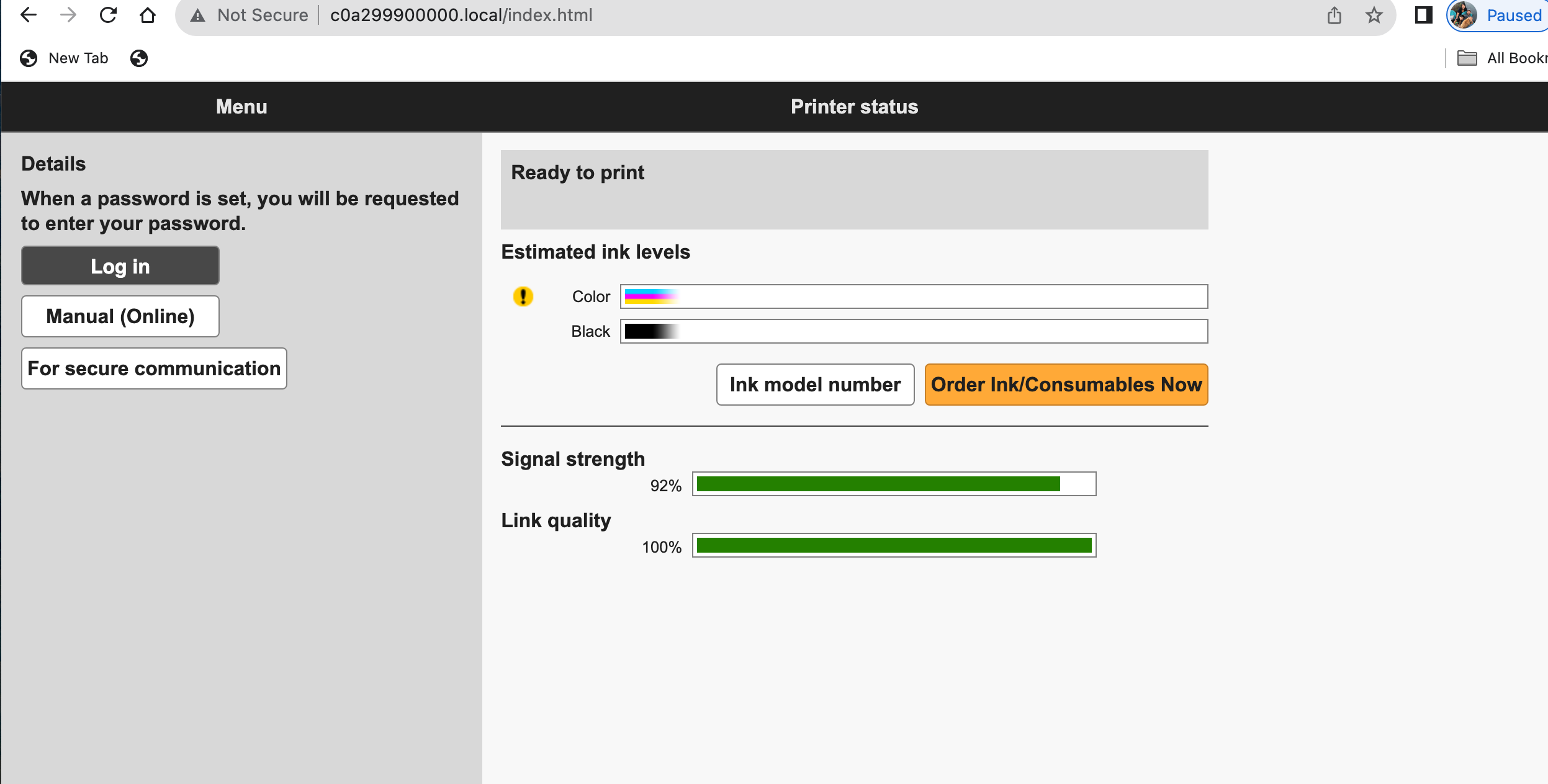

      I can access the printer directly with the IP address Side note I did't know I could even do this, nice new access feature

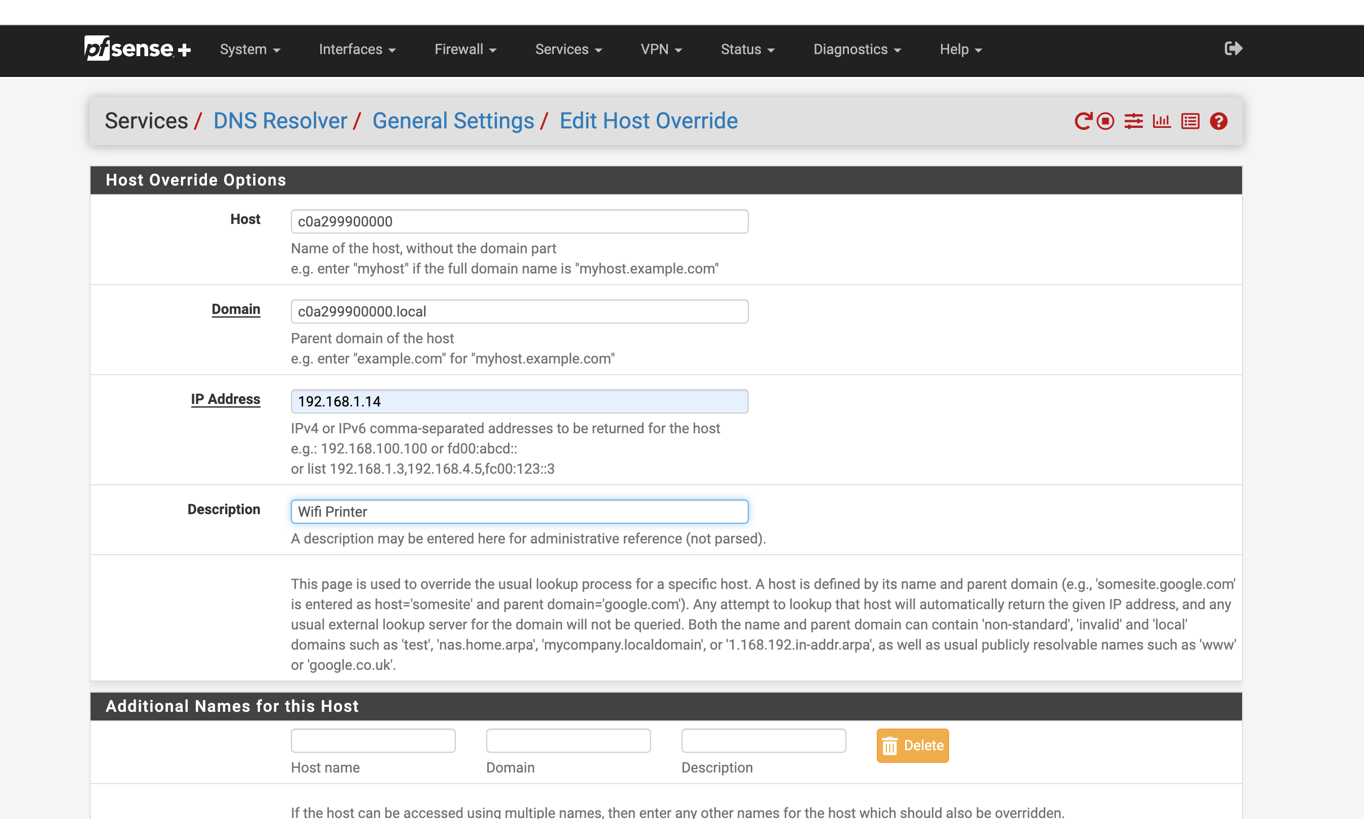

      2. add a DNS host override for the hostname the Canon IJ Scan app utilizes. I used local and home.arpa

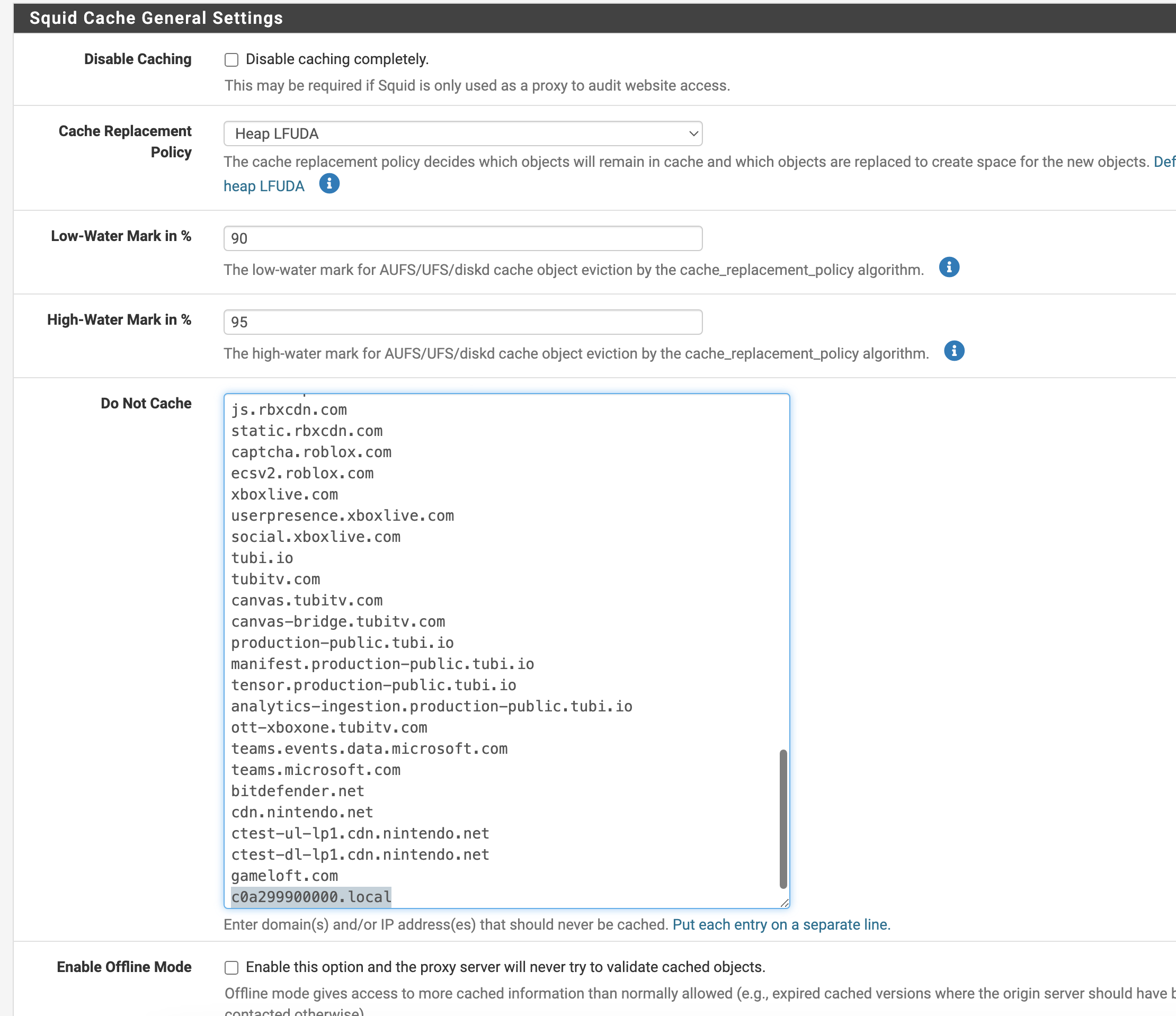

      4. set do not cache in Squid for the printer's host name
      Now test url...
