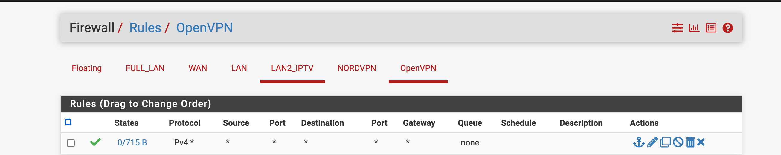

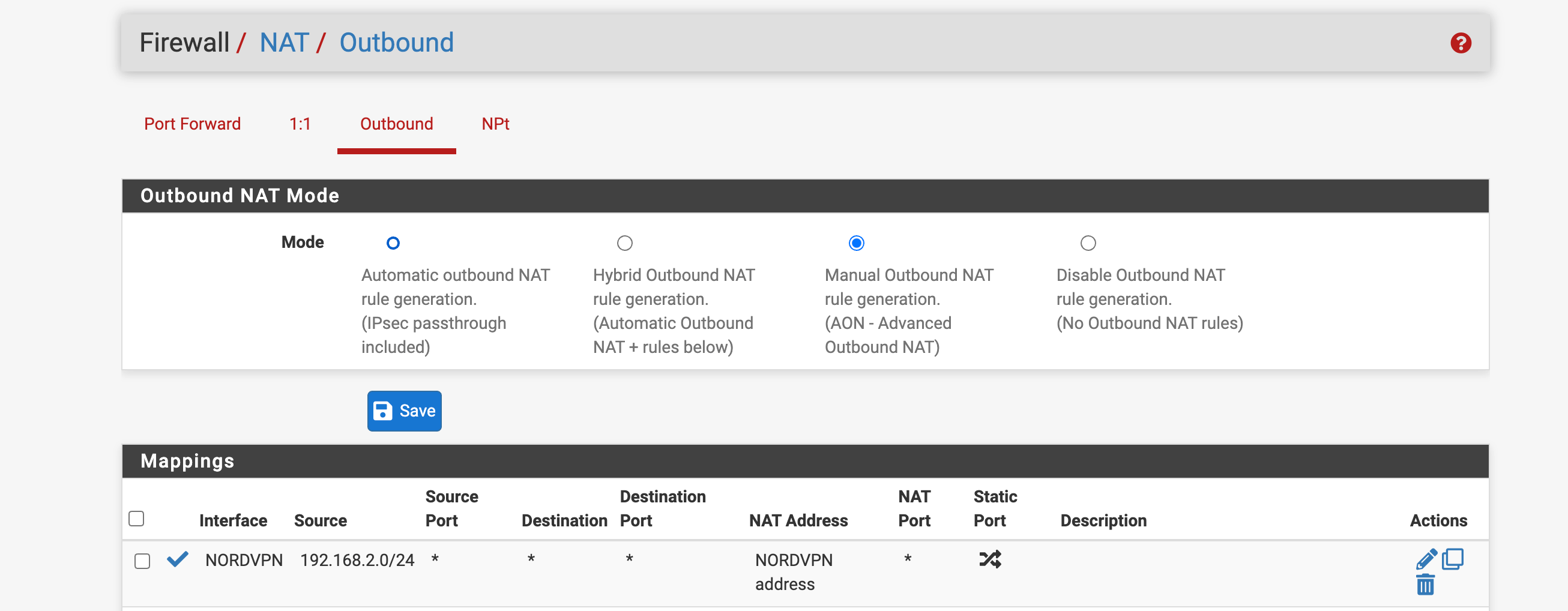

      I added one Rule to NAT and another to Rules :
      Now, all my LAN traffics pass through the VPN.
      But I have a problem with my IPTV Smarters application. When I use then VPN, the apps doens't works.
      I need to allow port 80 and 8080. I tried to add theses 2 rules on LAN, NORDVPN and OpenVPN, but nothing works...
      I alos tried to open and allow ALL ports, but it doesn't works...
      How can I open theses ports through my VPN ?
      Thank you very much.

              Without VPN, I use this rule and my IPTV works well :
              But if I switch the gateway to NORDVPN_Gateway, my IPTV stop working... This is the same on my computer.
