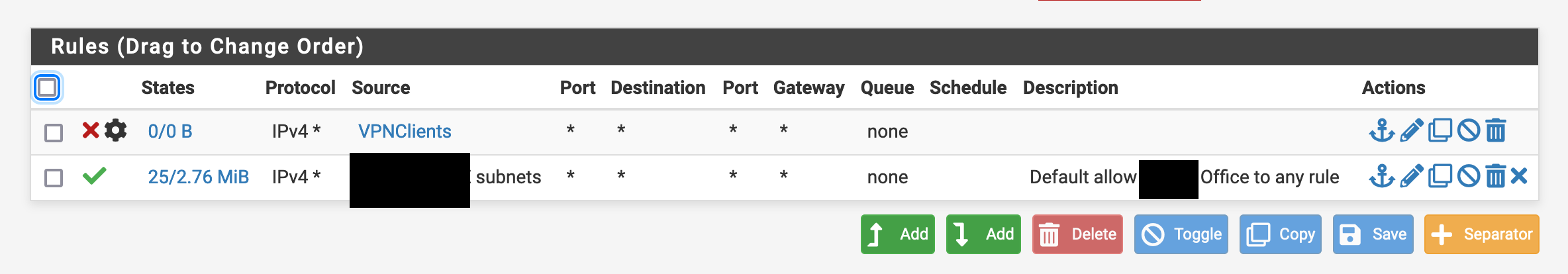

      Hello,
      I have a couple of computers on my network that I like to run through a VPN. I have had this working for a year or two under different scenarios. Today, I decided to stop using the separate ports on my Protectli (software switching) and put in a mini flex switch instead. I finally got all of my vLANs setup and things seemed to be back to normal...except my VPN rules. I have a rule under a vLAN that should pass traffic from the alias computers to the wireguard gateway and tag it with "vpntraffic". I also have a floating rule to block all traffic tagged as "vpntraffic".
      After getting everything setup, I remoted in to one of the computers to verify if it was using the VPN. When I checked online, the IP was from my home. I decided to changed the rule so that the default gateway was chosen and the traffic still got out to the internet. The floating rule should have blocked the traffic. I changed the rule again to block all traffic for that alias. I am still getting to the internet.
      I am running pfSense+ on 23.09. I have reset the states table and have rebooted a few times. I am not sure how I would troubleshoot this and not sure what information I need to provide. Thank you!!

        I'm wondering, what rule the screenshot is showing. It might wether be the tagging rule on the interface nor the floating block rule.
        Anyway, since it didn't get any hit, I assume, not any packet from an IP in teh VPNClients alias was arriving at this interface.
        So possibly the rule is on the wrong interface?

          It is the rule on the vLAN interface called [MY]Office, which is on the 192.168.69.X subnet. One of the computers in VPNClients is 192.168.69.104. The first time I set up the vLAN, pfBlocker did not add a rule to the interface. When I deleted the interface and recreated it, the pfBlocker rule showed up.
          I am not sure how I can troubleshoot where the client is getting its internet from and how it is bypassing the rule.
