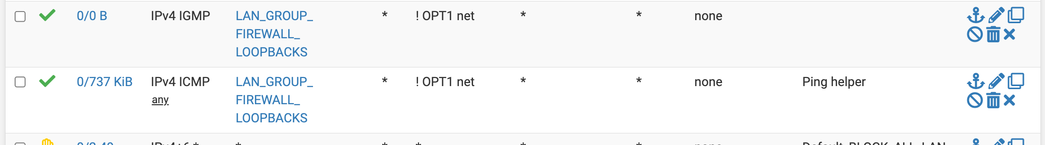

Here is an example of mine. I have no bridge between interfaces. I want my WLAN interface ( source: my custom LAN group alias) to be able ping anything and negate the OPT1 interface. Ping anything but not OPT1.Yours should have layer 3 rules on both interfaces
