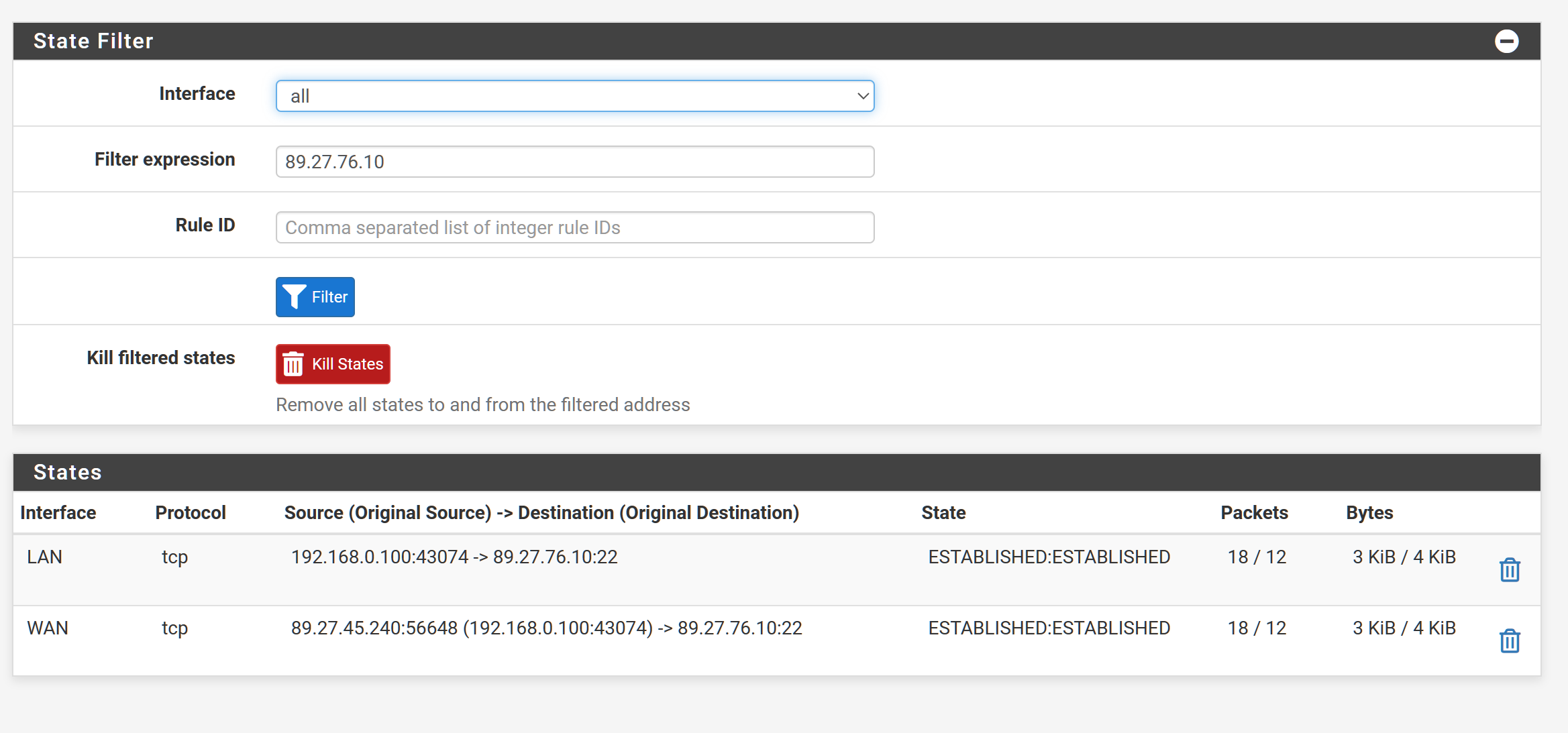

              Ping is working behind pfsense but ssh just hang. Feel free to test with ip 89.27.76.10
              Also ssh is working outside of my home network. From log I don't find anything related. There are open states when I try to get ssh connection.
              But some packets just don't find their destination. Finally after few minutes of waiting ssh connection is closed by server.
