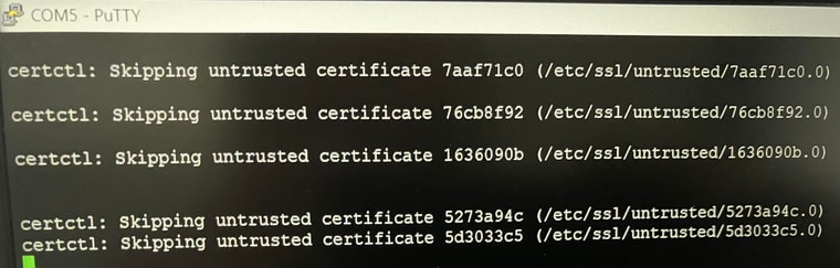

RESOLVED----> 	24.03.b.20240322.1708 Issues with SSL certificates will not allow reboot to install 24
After reboot many errors for not found operation not supported
This certctl error continued for a long time it would not stop, it just hung on this.
After I could not use any of my BE to go back it really caused issues when I interrupted this, but it would never continue it was stuck.
After this wipped out my boot enviroments all of them
I am stuck at Ok thats it
This version from today did not work I am going to restore from USB Dang...
I thought I could get it to boot from usb console I got just and OK screen and it had a major issue showing if you typed quit it would fail and start over.
You could not access the boot environments after power cycle only marvel. I did see at one point that I was attemping to do a PXE boot with an image and showed T T T T T T T for timeouts after I noticed 3100 I have a 2100
So when open SSL was removed the certificates I created and approved marked trusted are somehow mixed up with non approved list. How can we migrate them into the trust store
I am a Squid/Squidguard/Squidlite user. Is it safe to say do not update to 24 at this time as it will break the system and boot environments?
That is just the output of
certctl rehashafterpkggets reinstalled/upgraded.That is almost certainly completely unrelated to whatever your real issue is there.
@jimp it wouldn’t stop ever I had to reinstall after

@stephenw10 YEAH!!!!!!!! I am scared to test 24 again based on what occurred last time. But I should use my other SSD and do it because this SSD is working really well right now. It would not stop that photo you see above, I interrupted it and that is what killed my kernel file on the drive I bet, but it killed the Boot Environments too.
@stephenw10 Should I attempt it again but just let it run for a couple hours uninterrupted?

24.03.b.20240322.1708 resolved this
System installs and boots and functions
