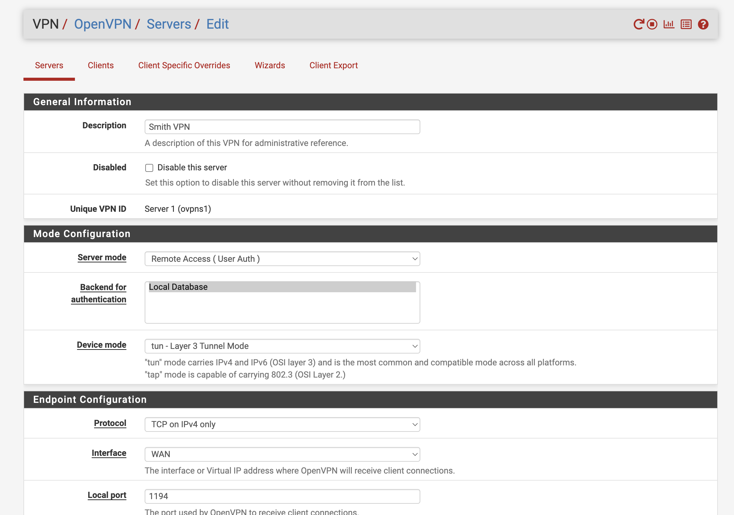

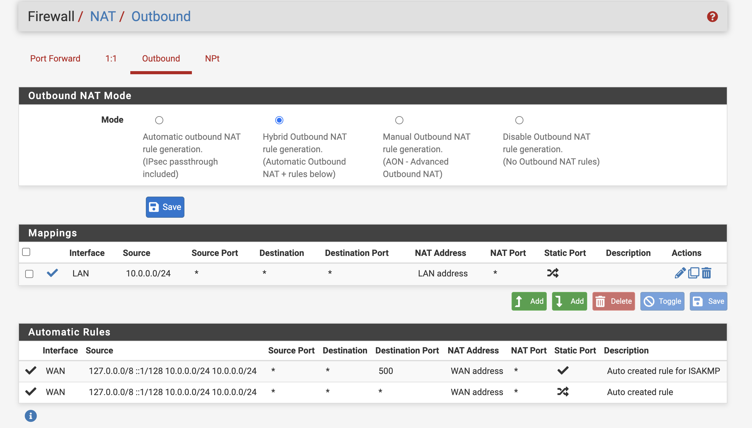

      Hey guys, I hoping someone has a quick fix to my situation. I had a working OpenVPN configuration, then I changed my IPv4 Address on the LAN for the pfsense server from 10.0.0.1 to 10.0.0.2. I can still connect to the VPN, but now getting some connection errors on the client side and cannot connect to any LAN or WAN servers. Tunnelblick log posted below.
      If it helps, another service stopped working when I did this: The DNS resolver is used to direct my subdomain pfsense.sonoclipshare.com to 10.0.0.2. When I test this subdomain using DNS Lookup I do get 10.0.0.2, but when I try to visit pfsense.sonoclipshare.com:1433 (the port my webconfigurator is configured for) it fails to connect. If course, 10.0.0.2:1433 works just fine.
      Is this a firewall problem?

        Is pfSense the default gateway on the destination devices, you want to access?
        Maybe you forgot to update the gateway.
        Or if it isn't and you do masquerading with an outbound NAT rule, did you update it?

          • U Offline
            utnuc @viragomann
            @viragomann Here's my outbound NAT:
            alt text

              • U Offline
                utnuc @viragomann
                @viragomann I'm in tun mode. Here's my openVPN config.
                alt text
                • V Offline
                  viragomann @utnuc
                  @utnuc
                  According to the client log, the server pushes the ifconfig 10.0.0.3/24, and as you said above 10.0.0.2 is the LAN IP of the server.
                  This could only happen if the server is in tap mode, however. Or there is something pretty faulty on the server.
                  Also in the outbound NAT, there are two entries 10.0.0.0/24.
                  Check out in Status > interfaces, which are using this subnet.
                  • johnpozJ Online
                    johnpoz LAYER 8 Global Moderator @viragomann
                    @viragomann I think he is using the tunnel network same as his lan network.. Which is going be problematic for sure..
                    Here is mine for example.. You can see the tunnel networks are auto added to the outbound nat.
                    V U 2 Replies Last reply Reply Quote 0
                    • V Offline
                      viragomann @johnpoz
                      @johnpoz
                      Ah, this could be the reason for sure.
