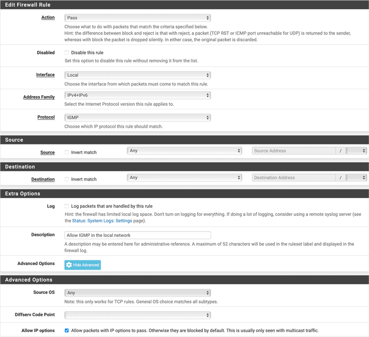

            If you want IGMP, you need a rule that passes IGMP with IP options set. If you are want a rule per interface, it would look like this:
            Alternatively, if you have multiple LAN segments, you could also use a floating rule which would look like this:
            The important part is to check the box for Allow IP options.
            Edit: Be sure the IGMP pass rules come before any other pass rules that might match the IGMP packets. I.E. if you have a "pass all" kind of rule, the IGMP rule needs to come before that.

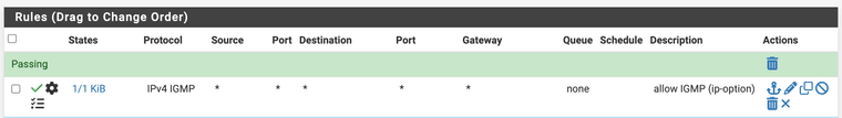

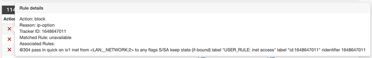

                                      On my 6100 running 25.07, I'm noticing these IGMP packets getting blocked (they were probably there all along but since I'm troubleshooting multicast issues I happened to be digging around and saw them)
                                      I haven't collected packet dumps of this traffic yet, but based on the LAN IPs of the 2 hosts below, I identify them as my main Mac workstation and a Windows 11 VM, so it's not platform-specific.
                                      That "inet access" rule is the very bottom of my ruleset on the LAN interface, and looks like this
                                      What's the best course of action here?
                                      • Make a separate rule just above it that allows ip-options just for protocol IGMP?
                                      • Just ignore them?
                                      • Something else?

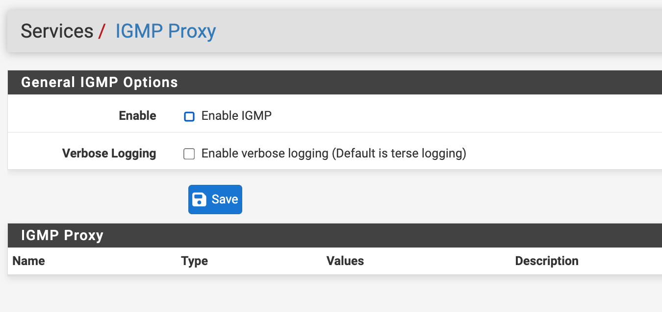

                                      Do I need IGMP Proxy enabled for any reason?
                                      edit: I decided to go with a rule to pass IGMP on the LAN for now. It's matching...
                                      Thinking about this, I'm not sure that this actually does anything other than tidy the logs. Once the IGMP packet hits my pfSense, I don't think it "goes" anywhere useful.
                                      • dennypageD Offline
                                        dennypage @luckman212
                                        @luckman212 I have this in Firewall / Local / Rules:
                                        There really isn't much reason to suppress IGMP packets in the local network.
                                        johnpozJ luckman212L 2 Replies Last reply Reply Quote 0
