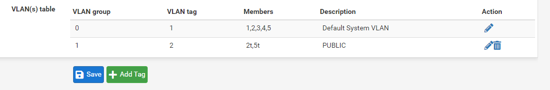

      On the Switch VLAN (802.1q enabled) I have two VLAN :
      VLAN tag 1 with Members 1,2,3,4,5
      VLAN tag 2 with members 2t, 5t
      PVID is 1 for all ports

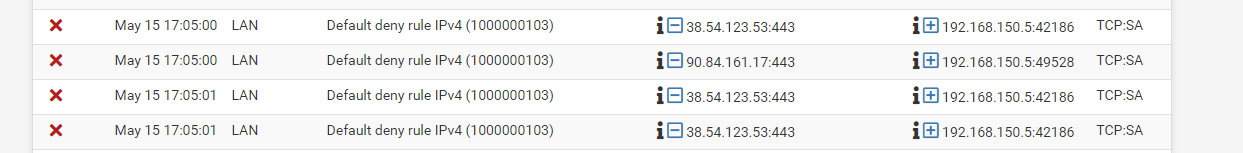

      Clients connecting to SSID with VLAN 2 get a DHCP lease, I can ping said clients from the SG-2100 without any issue, however, when clients tries to go on internet, it just failed, and i can see on syslogs Firewall than trafic is blocked on LAN interface, with destination of 192.168.150.0/24.

      Syslogs Firewall
      Switch VLAN Table
      I can't find why the trafic is blocked when going from internet by LAN interface

        I tried multiple thing, got some packet captures, and saw that UDP was working fine, everything in local was working fine, and TCP SYN packets were going out, but SA were block going back
