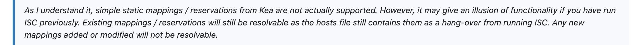

      Nope that's unrelated. At that time both dynamic and static leases were not resolvable at all. 24.11 has out custom binary that handles the Kea-Unbound glue to allow it. But that didn't affect the actual leases, only resolving hosts.
      What client type are you testing this from?
        MacUsers @stephenw10
        @stephenw10 said in Kea DHCP stops working:
        May be it was but still matches exactly with my case. Probably this particular part somehow escape testing before release?
        I tested with two MacBooks, Minix U22-XJ, Raspberry Pi 5 and even with a Netgate 6200 - none of 'em got the IP they deserv :)
        If that's what you meant. It doesn't matter what client or type - any new mapping (brand-new or edited) not working.
        Pls let me know if there is anything else I can provide to get it fix.
