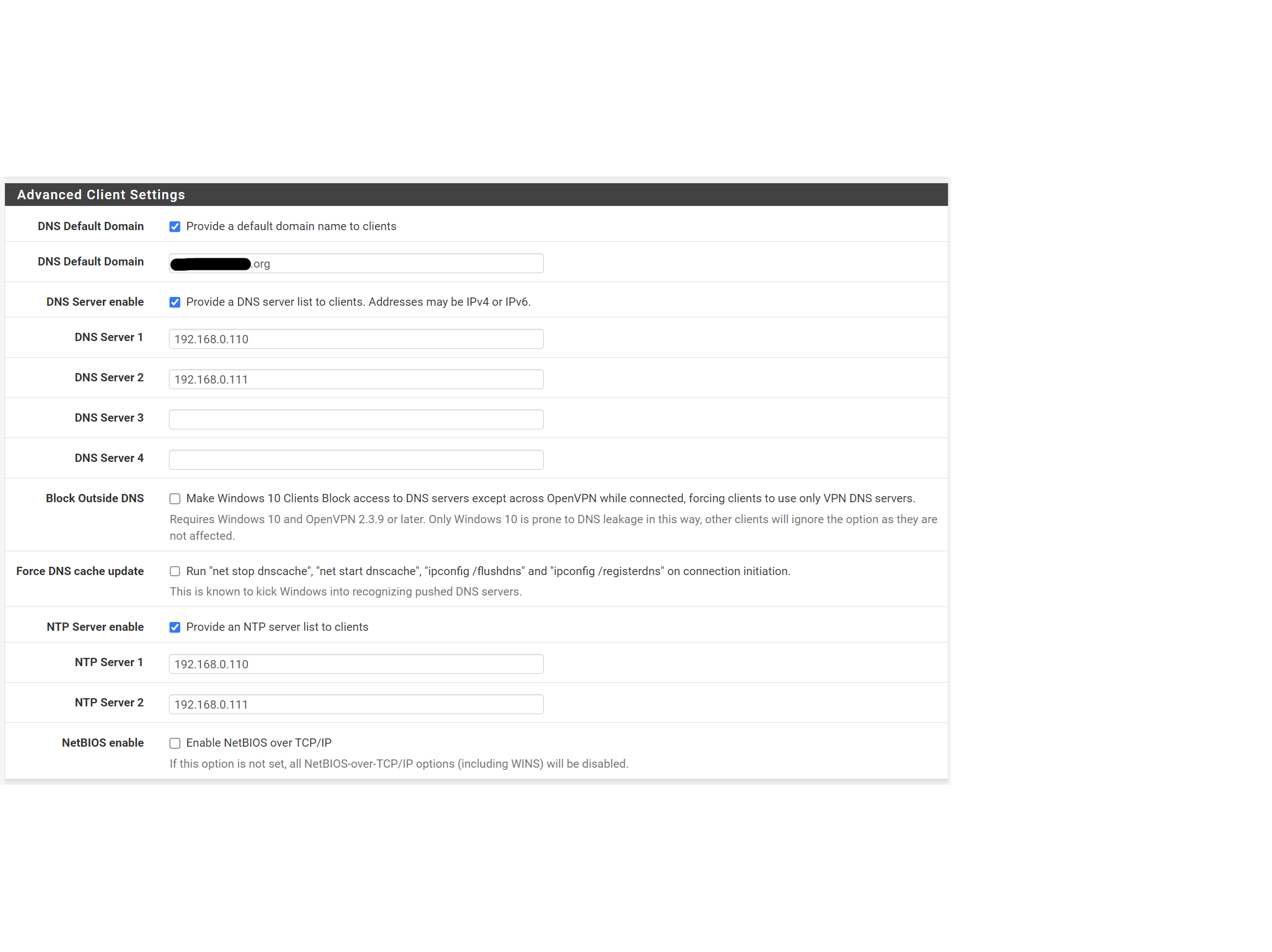

      I have followed the OpenVPN Remote Access Configuration Example recipe.
      Tunnel Network: 172.17.0.0/24
      WAN Address: x.y.z.65
      LAN Address: 192.168.0.254
      LAN Subnet: 192.168.0.0/24
      DNS #1: 192.168.0.110
      DNS #2: 192.168.0.111
      I have configured Network Policy on Windows Server and set OpenVPN Server to use Radius Authentication. I have validated that Radius Authentication is working by using Diagnostics | Authentication and it returns a successful response from the RADIUS server.
      I am using an ACME issued certificate for the OpenVPN server. I also use this same certificate for the WebGUI and it works fine. The certificate is for gateway.xxxx.org and is in Certificate store and the ACME cert is in the Certificate Authorities store.
      Hostname: gateway.xxxx.org
      External DNS has A record of x.y.z.65 pointing to gateway.xxxx.org
      Internal DNS has A record of 192.168.0.254 pointing to gateway.xxxx.org
      OpenVPN Configuration:
      WAN Firewall Rule:
      OpenVPN Firewall Rule:
      Problem:
      Both on Android (connected to a public network) and my Windows 11 machine (connected to a private network, on the 192.168/.0.0/24 network I cannot establish a VPN connection. I'm stuck and need some help.

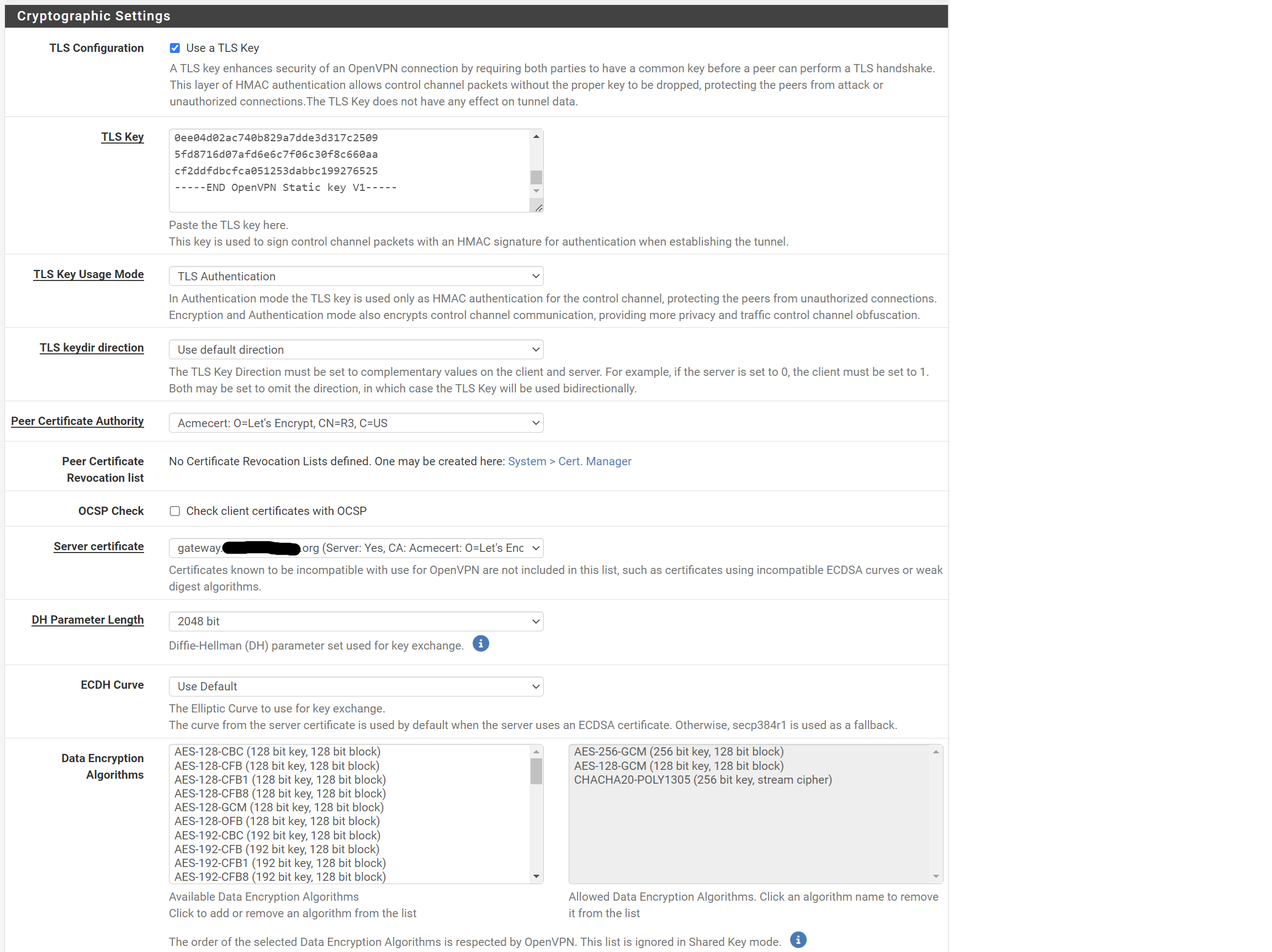

                  Gertjan @codechurn
                  @codechurn said in Open VPN Server:
                  Where would I find the Open VPN Server System Logs?
                  In the same log.
                  This is a paret of the server startup :
                  Btw : not really important, but :
                  Switch to IPv4 (only) :
                  Remove IPv6 here :
                  because right now, you announce IPv6 capabilities, but in reality : you have none.
                  Client devices will, of course, prefer IPv56 over IPv4, so if your VPN announces : IPv6 ok, you'll hit the wall.
                  Cool.
                  Bit not really needed.
                  I've created a self signed cert for 10 years, and be done with it (KIS principle).
                  Some random observations :
                  Just "User auth" and not "SSL+TLS + User auth" ? You don't want your VPN to be encrypted ?
                  This one :
                  ACME places a SAN (host name) in the certificate, not a 'user login name'. Not sure how this can ever match.
                  Here : https://www.youtube.com/@NetgateOfficial/videos are some old and very old pfSense OpenVPN server setup guides. They are still very valid, just keep in mind they were made with an old version of OpenVPN server.
                  "Instantiate" the ovpns1 "OpenVPN" into a (example) MYSERVERVPN - like you did with the EXPESSVPN (VPN client)à interface
                  Move the firewall rule present on "OpenVPN" to this new "MYSERVERVPN".
                  What pfSense version ?
                  edit : and yes : The OpenVPN client exporter is needed.
                  Install the free, official OpenVPN Android Apple Windows App.
                  https://openvpn.net/client/
                  This one logs just fine and is easy to handle, and works the same on every platform.
                  If that one works, only then try to tackle the Windows version (didn't even know it existed, and the way it looks, who want to use it ^^)
