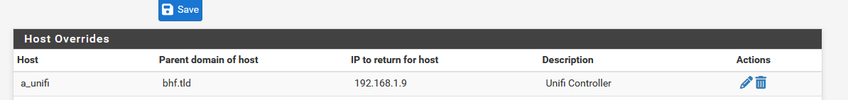

                                Easy solution - the one that works without the help of DHCP :
                                As per Unifi documentation :
                                Create a host override (bottom part of General config of the resolver) called 'unifi' and let it point to IPv4 of your controller.
                                I called it "a_unifi" so it gets sorted on top.
                                You should "unifi" of course.

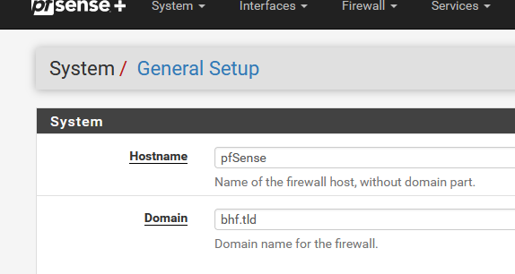

                                as "bhf.tld" is the domain of my pfSense.
                                as Unifi devices, if they didn't get the controller info with option 43 in the lease from a DHCP server, they will do a DNS request for "unifi" and use that IPv4 as the controller IPv4.

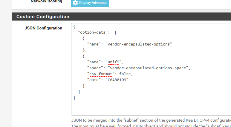

                                On the kea DHCP server settings page :
                                put this in place :
                                  "option-def": [
                                      "name": "unifi",
                                      "code": 1,
                                      "space": "vendor-encapsulated-options-space",
                                      "type": "string"
                                and on every LAN where you have unfi stuff, (APs cameras etc), put this :
                                  "option-data":  [
                                      "name": "vendor-encapsulated-options"
                                      "name": "unifi",
                                      "csv-format": false,
                                      "data": "C0A80109"
                                Btw "C0A80109" = 192.168.1.9 because my controller uses 192.168.1.9 - adapt yours for your controller IPv4.

                                            That's why I mentioned the first "easy solution" (see above) :
                                            (with images)
                                            ..... and done.
                                            I've tested this : it works.

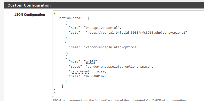

                                            I needed some special DHCP options, as other early pfSense kea users - and I counted .... 3 ?!! See forum posts and redmine. And when I say 'I needed' it's actually for my hotel captive portal visitors, as all recent phones, PCs etc have RFC8910 build in, and people tend to connect to (free) "wifi" whenever they can.
                                            Rfc8910 Captive portal support is why I needed a DHCP option, so at first I patched it in myself, but a Netgate author created a redmine and promptly wrote a JSON entry box and that worked right away :
                                            The first block is for the portal login page URL, and the second for my portal APs, so they can find the controller (192.168.1.9).

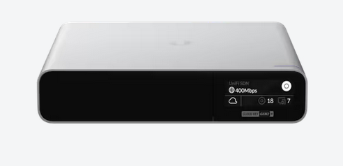

                                            I didn't retain the Cloud based solution (with a monthly fee).
                                            I finally when for the :
                                            stand-alone 250 $ solution.
                                            It has a build in 1 GB disk that I don't use - I guess it's for camera images/video's.
                                            Now I have a nice GUI that controls all my AP's, nice charts and many buttons to click on 😊

                                            The only thing missing is the ability to add Custom DHCP Options! With the legacy ISC DHCP web interface, we had:
                                            Number:
                                            Type:
                                            Value:
                                            Look at the image I showed above.
                                            These are now called "name", "data","space" and there are many (!) more formats.
                                            You have to use the { and }, and commas - these should be placed with space science precision (JSON !), you are not allowed to F-up.
                                            @Finger79 said in switch over from ISC DHCP to Kea DHCP:
                                            it seems the workaround is to figure out how to
                                            Nah ... an admin has to do some work for a living ^^
                                            Remember : why you buy (chose) that device that needs special, totally none standard settings, then, by your choice, you have to support it. pfSense can not be made aware of all existing possibilities out there. So : you'll be needing the device's docs, and you'll be good.
                                            It won't take long time that device that need special DHCP lease options will have JSON examples as more then half of the planet will be using kea after all (it will eventually replace ISC).
                                            There are of course good candidates for total pfSense GUI integration, like the RFC8910 portal support. All the info needed is available in pfSense, so it could be a "one check-box DHCP solution".
                                            DHCP options are invented by the maker of a device that uses DHCP as a client.
                                            The DHCP server has to make (offer) this DHCP option. So it needs to be very flexible, as everybody (device constructor) wants something else. There are no standards.
                                            To enforce validity of these parameters, in stead of plain text, JSON is now needed (also plain text btw).
                                            See it as a sophisticated classic linux (Windows INI ! or even config.sys or autoexec.bat file) config file, the ones we used for the last 50 years or so, and it evolved from these to somewhat better, that can be 'checked' as kea (pfSense) uses lint before it accepts your JSON entry
                                            Now everybody can add whatever DHCP option he wants, if he is willing to look up how to do so. And as said, the alter is always
                                            All of this is very 'imho' and 'afaik'.
                                            pfSense is flexible, so I flex it.
