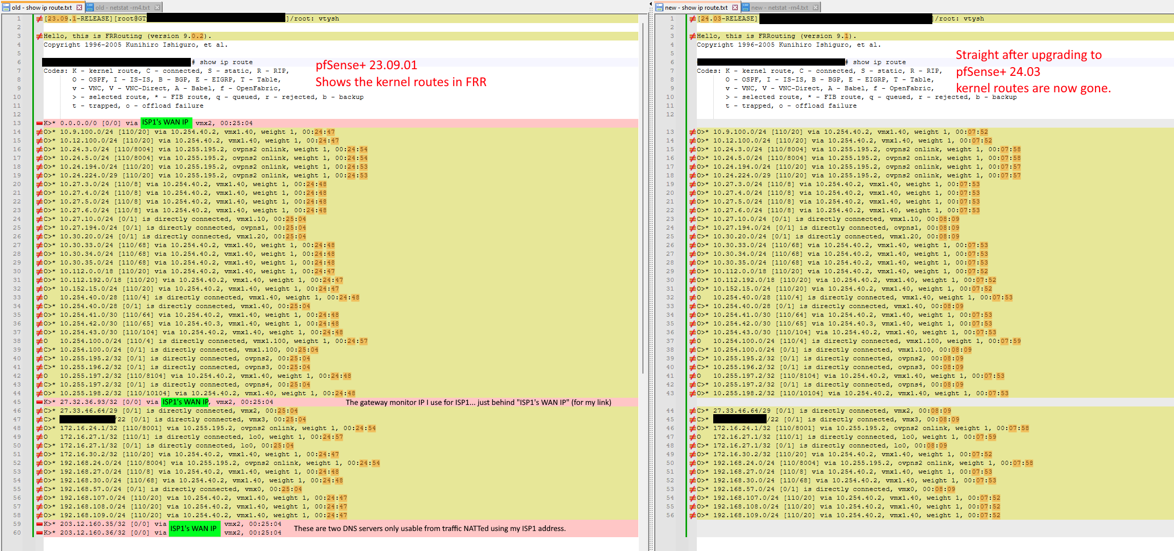

      The update from pfSense+ 23.09.1 to 24.3 immediately broke my network. Note that the update completed successfully.
      Upon investigation I saw that kernel routes have gone missing in the FRR 9.1 included with 24.3, but were present in the FRR 9.0.2 included in pfSense+ 23.09.01.

      The reason why my network broke was that there was another route in the FRR "show ip route" - an OSPF-learned default route - which is not shown here as I have since removed it. It was a default route on another router in another part of the network, which had a high OSPF cost, and is used as an alternative path in case the whole firewall dies. It is a low-bandwidth link and should only be used in an emergency. When I upgraded the firewall to pfSense+ 24.3 from 23.09.1, it would then direct all traffic to this other low-bandwidth gateway, instead of sending it straight out its own WAN IP to the ISP.
      I have now taken this alternative path's OPSF-learned default route out of the network, so that the firewall can function again.
      I suspect that these kernel routes disappearing from FRR is why pfSense preferred some distant OSPF default route over its directly connected default route. I am now relying on the functionality that if FRR doesn't have a route in its routing table, then it defers to the system's routing table, and you can see with the "netstat -rn4" that it does have all the kernel routes.
      But relying on this functionality is not robust. It should be fine to have a backup default route in OSPF costed out as to not break anything, but be there to take over in case of an emergency. I shouldn't have to remove that. with the age-old concept of "administrative distance", the firewall should always prefer a directly connected default route, other a high-cost OSPF route.
      We really do need these kernel routes back in FRR, so that the FRR can have a proper and complete view of system routing logic. Therefore, I consider this a bug, and not a feature.

                                        Aug 13 02:05:20 GTpfsense01 mgmtd[87833]: [VTVCM-Y2NW3] Configuration Read in Took: 00:00:00
                                        Aug 13 02:05:20 GTpfsense01 staticd[88655]: [VTVCM-Y2NW3] Configuration Read in Took: 00:00:00
                                          marcosm Netgate
                                          Ruling out changes between pfSense versions is very helpful. Before we can say it's an issue in FRR or even a bug at all, let's try to understand what exactly is happening. I'm hoping the logs will have a clue.
                                          G 1 Reply Last reply Reply Quote 1
                                          • G Offline
                                            Gcon @marcosm
                                            @marcosm I just edited my note with some extra info. Is it possible to get packages built for 10.1 and I can test those? https://www.frrouting.org/release/. Or even 9.0.3, just to confirm even more that the issue stems from the 9.0.x jump to 9.1.x.
