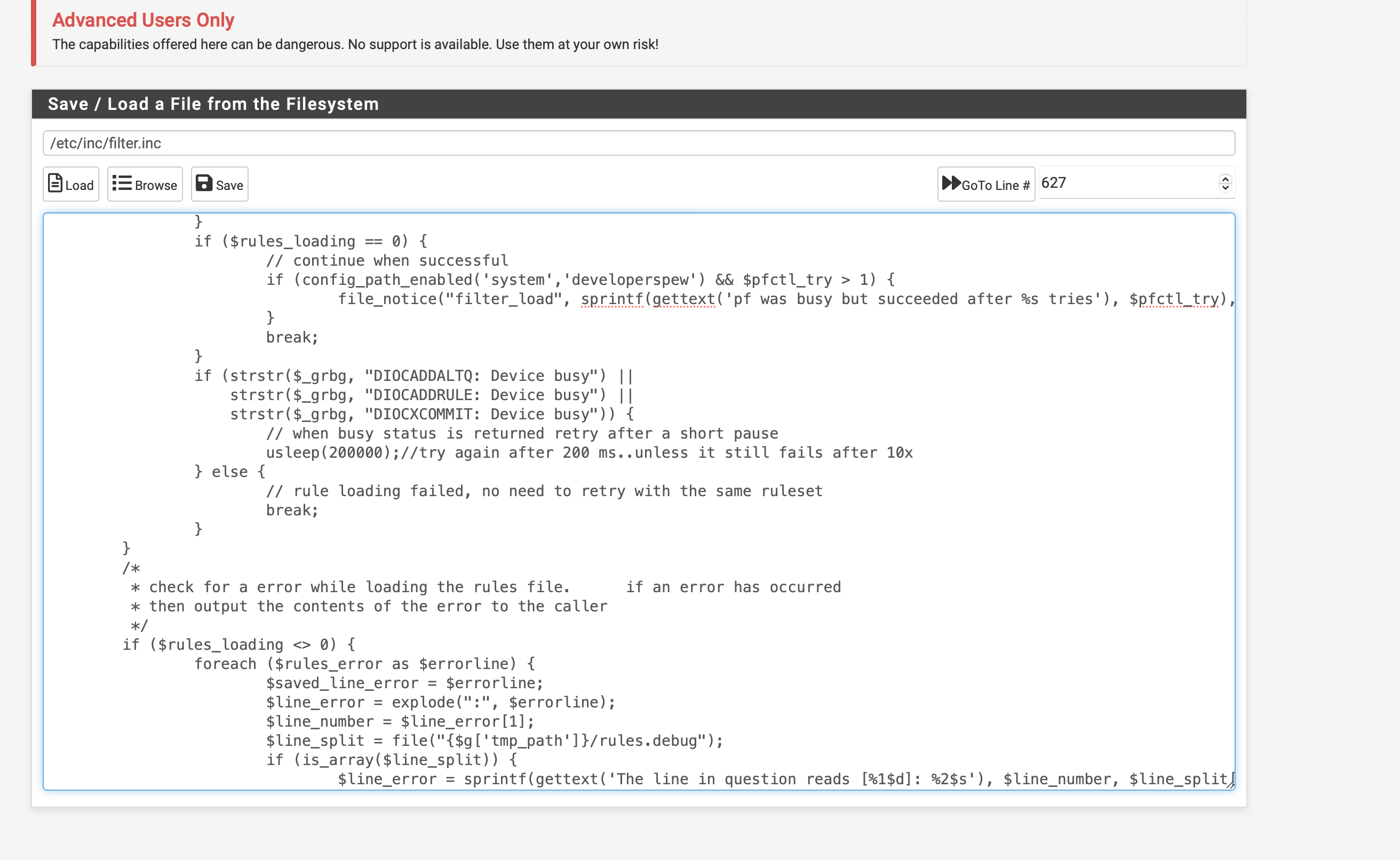

                    @JonathanLee I have a theory about what's happening here. Basically, the error message is misleading because we're not actually getting 'ENOENT'. The error handling code in pfctl is printing the wrong error.
                    The cause is likely to be a simple conflict between two processes trying to update rules at the same time. That's something the should PHP handle, but because the error doesn't match what it expects it doesn't.
                    If you're comfortable editing the PHP code it's a fairly simple thing to test:
                    --- /etc/inc/filter.inc.orig    2024-07-26 12:09:54.964680000 +0000
                    +++ /etc/inc/filter.inc 2024-07-26 12:10:15.221720000 +0000
                    @@ -624,7 +624,7 @@
                                            break;
                                    if (strstr($_grbg, "DIOCADDALTQ: Device busy") ||
                    -                   strstr($_grbg, "DIOCADDRULE: Device busy") ||
                    +                   strstr($_grbg, "DIOCADDRULE") ||
                                        strstr($_grbg, "DIOCXCOMMIT: Device busy")) {
                                            // when busy status is returned retry after a short pause
                                            usleep(200000);//try again after 200 ms..unless it still fails after 10x
                    So, in human terms, edit /etc/inc/filter.inc and on line 627 and change strstr($_grbg, "DIOCADDRULE: Device busy") to strstr($_grbg, "DIOCADDRULE") || (i.e. remove ': Device busy'). That ought to make the code match the error and retry in case of concurrent updates.

                            Before.....
                            After
                            Will update if error returns
                            Make sure to upvote
