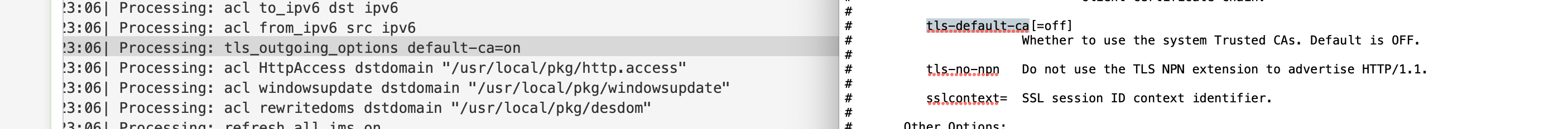

      Hello pfSense Netgate Community members,
      I have found an issue
      The directive for trust default CA on system
      is not tls-default-ca
      it’s just default-ca
      The squid.conf.documented lists it incorrectly
      Check it out...
      This processes ok when you run squid -k parse

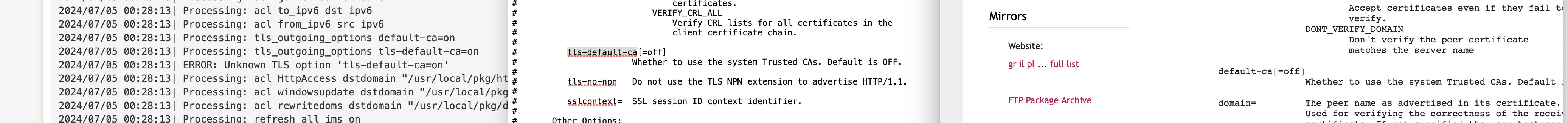

      (side by side with squid.conf.documented that pfsense uses)
      (side by side with Squid docs also)
