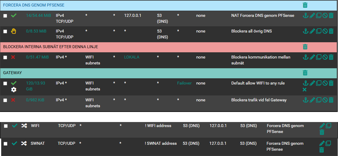

            You've shown the NAT rule.
            Can you show the related firewall rule on the LAN interface, all of them please.

              Check your rule order on the lan. When you create a port forward, PFS automatically creates another rule on that interface. That rule is at the very bottom. You need at least to move that rule up above your allow Internet rules.

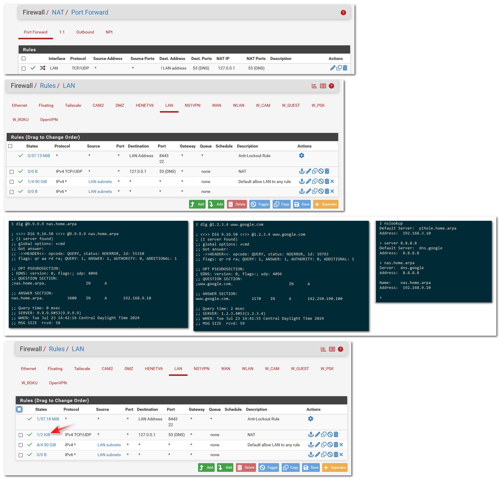

                  johnpoz LAYER 8 Global Moderator @DjJoakim
                  @DjJoakim I don't see that rule ever being evaluated. See the 0/0
                  Easy way to validate your redirection is working is just query direct say to 1.2.3.4, if you get an answer than yeah your dns is redirected, either by pfsense or upstream.. because 1.2.3.4 doesn't answer dns..

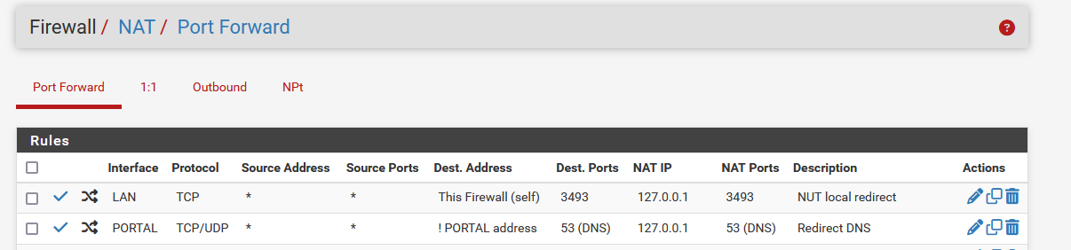

                      @DjJoakim lets see your port forward rules..
                      Not just the one rule - lets see the order of them. Keep in mind if there is an existing state your redirect will not work..
                      For example if your client is talking to 8.8.8.8 and there is state already in the state table.. That redirect will not take effect until a new state is created. Ie that existing state times out, or you kill it, etc.
                          @DjJoakim your dhcp server has nothing to do with it.. You sure your clients not using doh, that would be over port 443 and your redirection would not work..
                          Just do a direct query via your fav tool, nslookup, dig, host, doggo, dnslookup, etc
                          Here I redirected my dns for a test..
                          Notice got answer when asking 1.2.3.4, and how would google or quad9 know anything about my local nas.home.arpa so clearly that was redirected. Also notice my rule now shows evaluations, and a current state even.

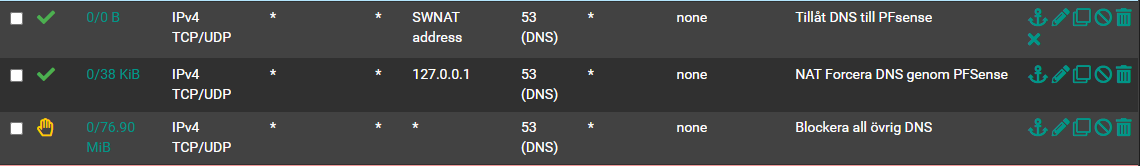

                              DjJoakim @johnpoz
                              @johnpoz @Gertjan
                              I performed an nslookup, and after doing that, I observed states on the LAN rule for DNS, so at least something seems to be working. However, I am not a DNS expert, which is why I'm reaching out for help. I have read a lot about how DNS works, and since nslookup seems to work, that's a good start. My goal, though, is to ensure that no one on the network can use their own custom DNS servers. I want everyone connected to the internet to only use the DNS servers on my PFsense, and if they don't, they should be redirected to do so.
                              Despite nslookup appearing to work, I get 0/0 on the states of the LAN rule when I try to "manipulate" the system by using my own DNS servers, such as Cloudflare and Google. What could be causing this issue?
                              See the attached image below. This is the opposite of what I want to achieve.
