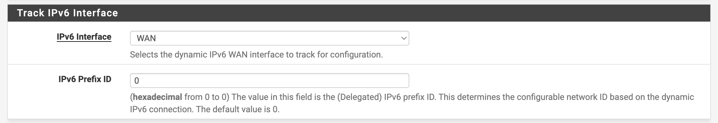

      Yes, it can just use the LAN address as source. If you have a functioning routable /64 on the LAN then just use that for pfSense. There's no need to add an address on WAN and putting an address on WAN that isn't routing correctly will only break it.
        @stephenw10 So why would pfsense use its lan IPv6 address to talk to the internet, it wouldn't have a gateway set - it is the gateway for the devices using the PD network..
        I am missing something? I haven't played with using a tracked interface in years and years. And my wan always got a gua on its wan when I did. And pfsense used that when pfsense itself wanted to talk to something out on the internet via ipv6.
        • stephenw10S Online
          It's default route would have to be the link-local address on WAN. My own WAN is like that, the ISP only supplies a PD, I have no routable address on the WAN so pfSense uses the LAN address (or whatever interface it's on).
