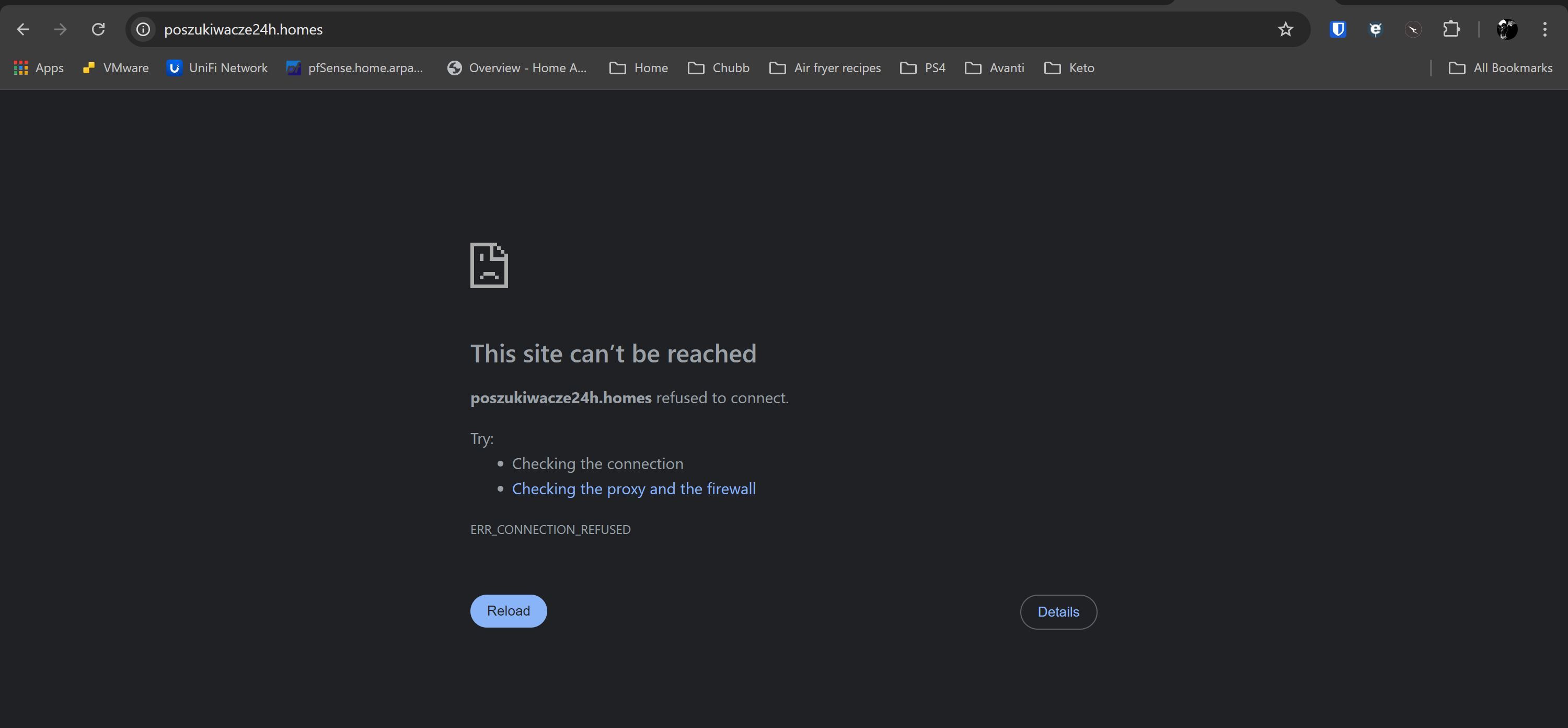

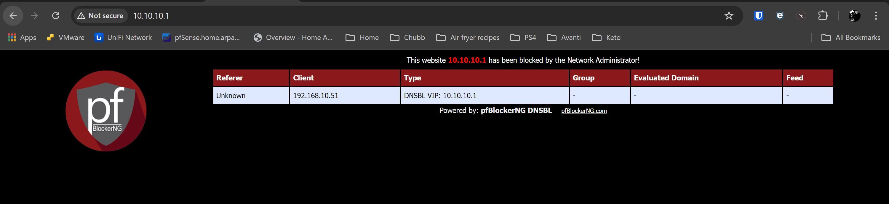

      For the first 10-20 seconds after a cold boot of pfsense, I am able to access the VIP page on 10.10.10.1. The expected default page is displayed with a not secure message in the browser. I can access on both HTTPS and HTTP as tested from LAN and IOT subnets. I have not changed the ports; they're set at default 80 and 443 respectively.
      After this time passes, I can no longer access the default page. The browser changes to reporting ERR_CONNECTION_REFUSED. I am able to ping 10.10.10.1 from LAN subnet at all times, and have confirmed that the DNSBL VIP address is in a unique range with nothing else close. A traceroute to a blocked dns entry returns 10.10.10.1 on the first hop.

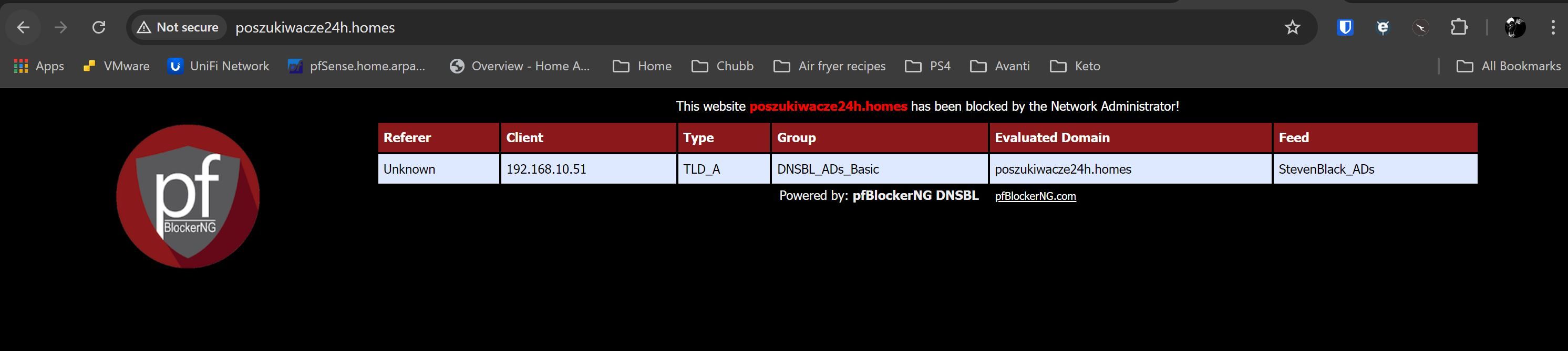

      This also applies to any DNS entry that should be blocked per blocklists or policy. Instead of returning the VIP default page with the ruleset that was applied, the browser returns ERR_SSL_UNRECOGNIZED_NAME_ALERT or ERR_CONNECTION_REFUSED.

      Any guidance is very much appreciated, I’m at a loss at this point. Being that the default page can be displayed for some time after a cold boot/change to Web Server Interface I’ve seen that it’s not completely broken. I also feel like some filtering may be catching up after this time and denying access. Happy to provide any logs/screenshots that could assist.

                --After changing Web Server Interface from localhost to LAN, but before Update>Reload>DNSBL--
                1. The VIP page will display with the correct evaluated domain/feed and remains accessible, after i have changed the Web Server Interface from localhost (80/443) to LAN (80/443), browsing both 10.10.10.1 and http://ib.3lift.com/ (StevenBlack_ADs)
                2. The VIP page will not display on 127.0.0.1
                3. I cannot ping 10.10.10.1
                4. I cannot curl 10.10.10.1 - terminal hangs
                5. I can ping 127.0.0.1
                6. I can curl 127.0.0.1 - output as working previously attached.
