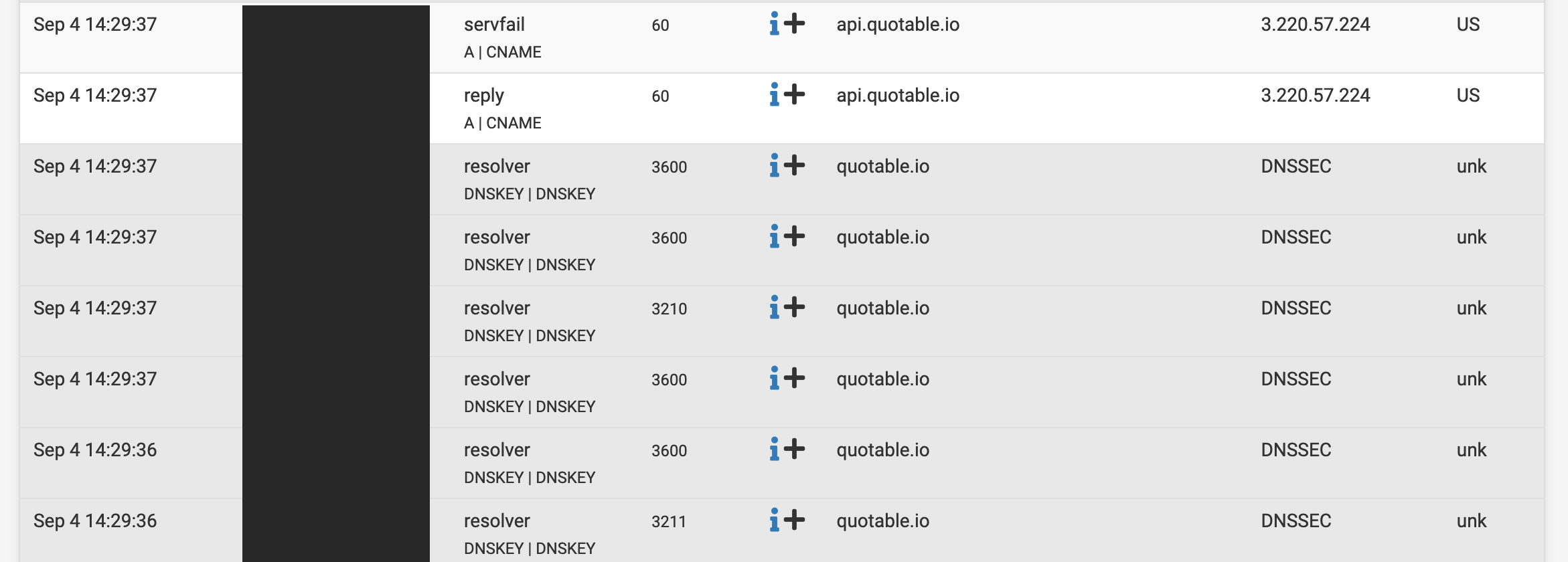

      I am getting mixed reply when looking at the logs for resolving a domain. I have added it to whitelist as well .quotable.io # quotes for obsidian but it still seems to be blocked when querying from device. What am I missing here?

      • johnpozJ Online
        johnpoz LAYER 8 Global Moderator @anubhav
        @anubhav said in DNS resolution failing with mixed replies:
        api.quotable.io
        looks to be dnssec failure to me
        https://dnsviz.net/d/api.quotable.io/dnssec/
        ede response is this
        ; EDE: 9 (DNSKEY Missing): (No DNSKEY matches DS RRs of quotable.io)
        Also showing this error with just unbound on pfsense
        ; EDE: 6 (DNSSEC Bogus)
        You can enable EDE in unbound so you can see such info
        edit: if you set
        ede: yes
        In the custom option box, and you dig and there is a servfail, you should get hopefully some info on what is wrong
        As a work around, you could set that domain as not secure, so that it doesn't do dnssec.. Or could turn off dnssec completely - but would be better to just make an exception for that domain.. But clearly they have an issue currently, so prob best not to even go there.
