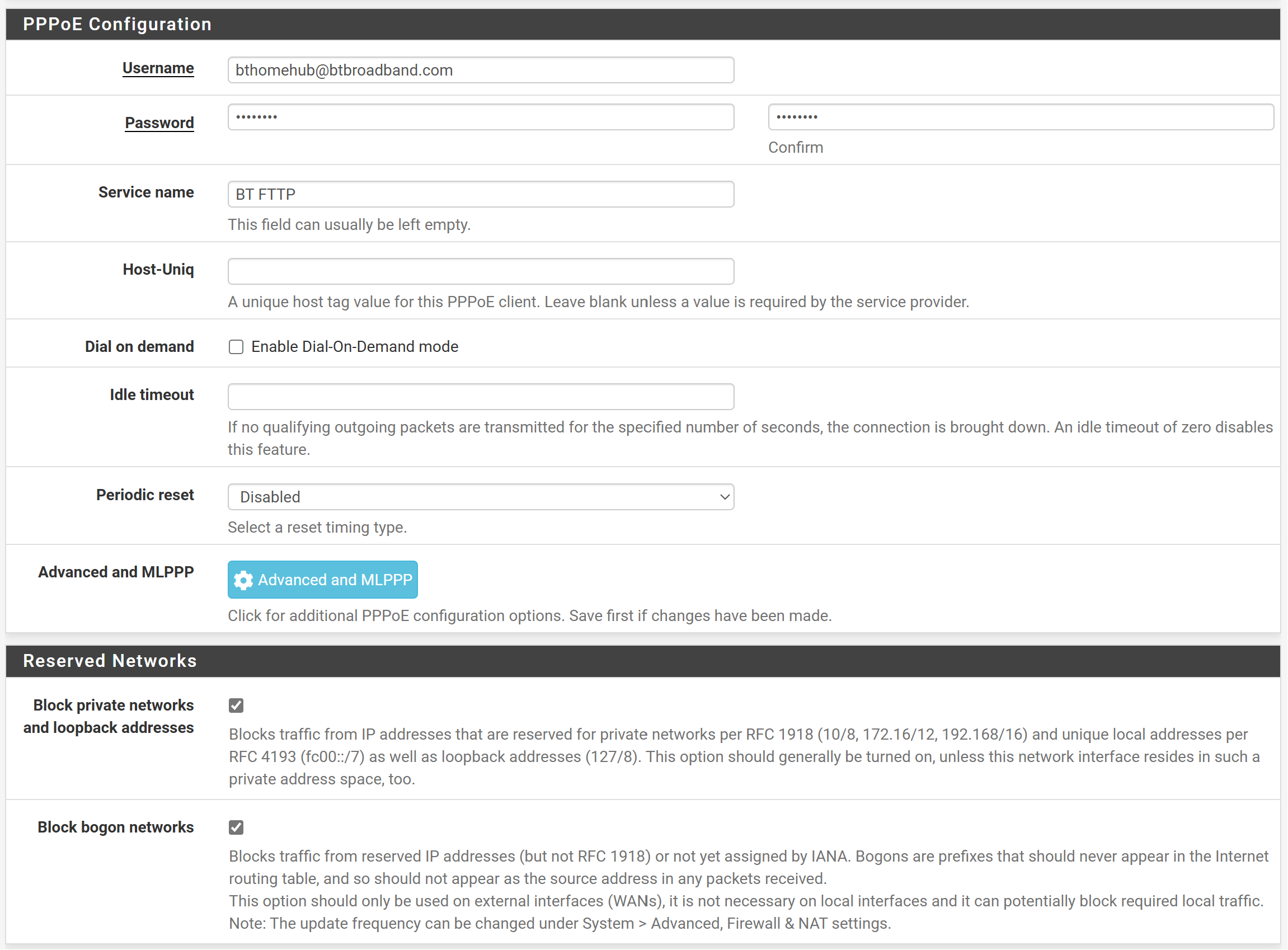

      No expert in the setup but I previously had my Virgin Router in Bridge Mode and pfSense, with Unifi APs for Wifi working great. Switched to BT Full Fibre and followed other forum post etc for the configuration but my connection appears to only be partially working.
      By that I mean, I can access websites like Google, BBC etc on my laptop connected in to the switch, but can't access Speed Test . Net to check speed and when I go to IP check sites I only see an IPv6 address but it can't show and IPv4 address (I think that may help diagnose but I could be wrong...)
      I am connected direct to the ONT with no BT Router in the mix currently.
      My phone connecting to the Wifi initially said it had internet but fairly quickly decided it was connected to the network but with no internet.
      Here's what I have set for my WAN:
      And on the front page everything looks like it should be up and running quite happily:
      Anyone got any ideas of what I am missing here? I had to revert to the BT Smart Hub 2 last night to keep the family happy but would love to keep running pfSense if I can get this sorted, sadly not having much luck at the moment!

        I have the same settings for my BT FF500 connection and it works fine for me - also using Unifi access points. What do you get if you try https://ipv6test.google.com/ - does it show you're using IPv6? I am assuming you are using ISC DHCP?
        Do you have a firewall rule to allow IPv4+6 ICMP for ping - this may be needed for IPv6 to work correctly.
        Why do you have a WAN2 interface - what is that for? Have you tried removing it?

            Did you set an IP for the WAN_PPPOE Gateway Monitoring - the default doesn't work as the BT gateway doesn't respond to pings. I have my monitor IP set to 1.1.1.1 - perhaps pfSense is thinking your BT connection is down and routing traffic to WAN2 instead which is why you don't have IPv6 working? I would keep WAN2 disabled - you shouldn't need it with FTTP?
