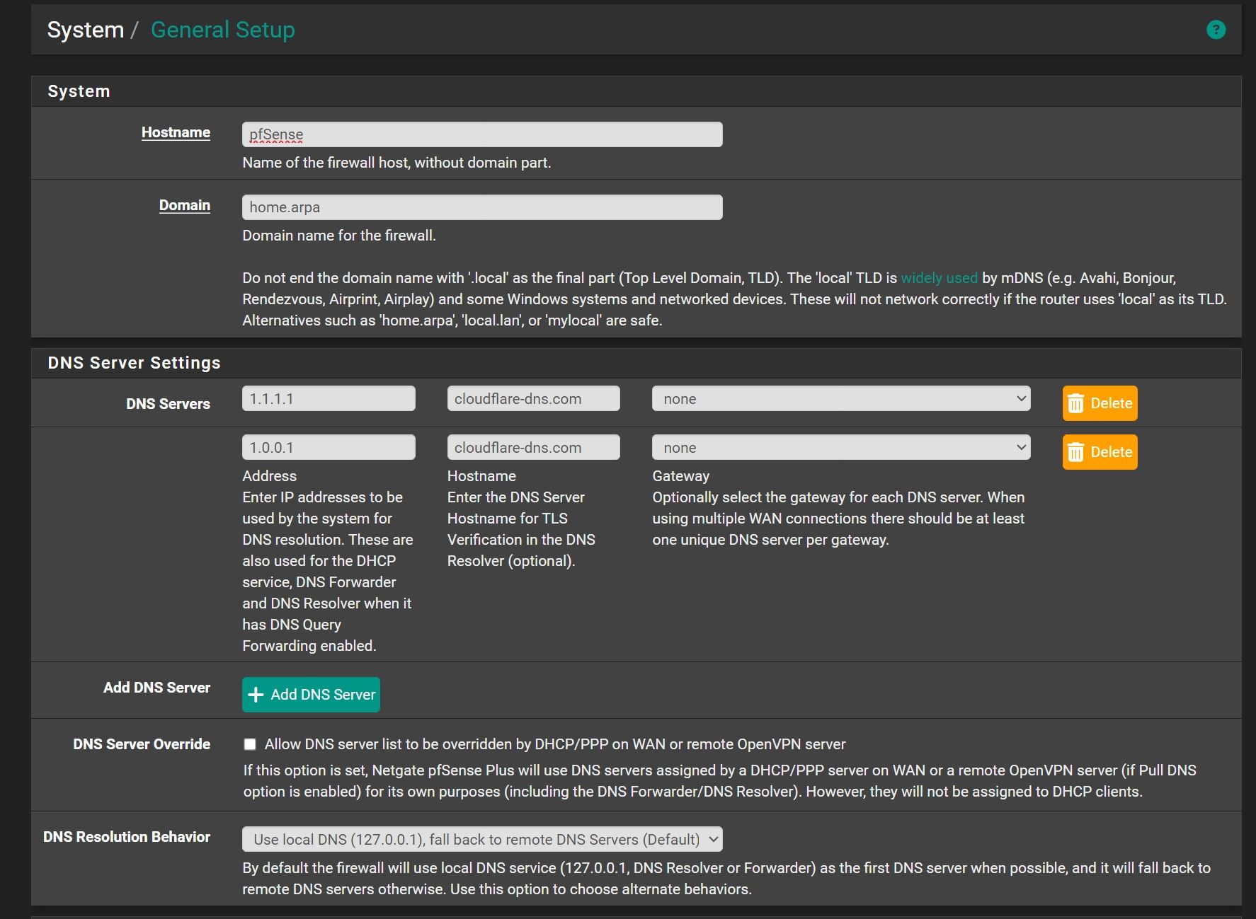

Slow local dns lookup. Is it normal?

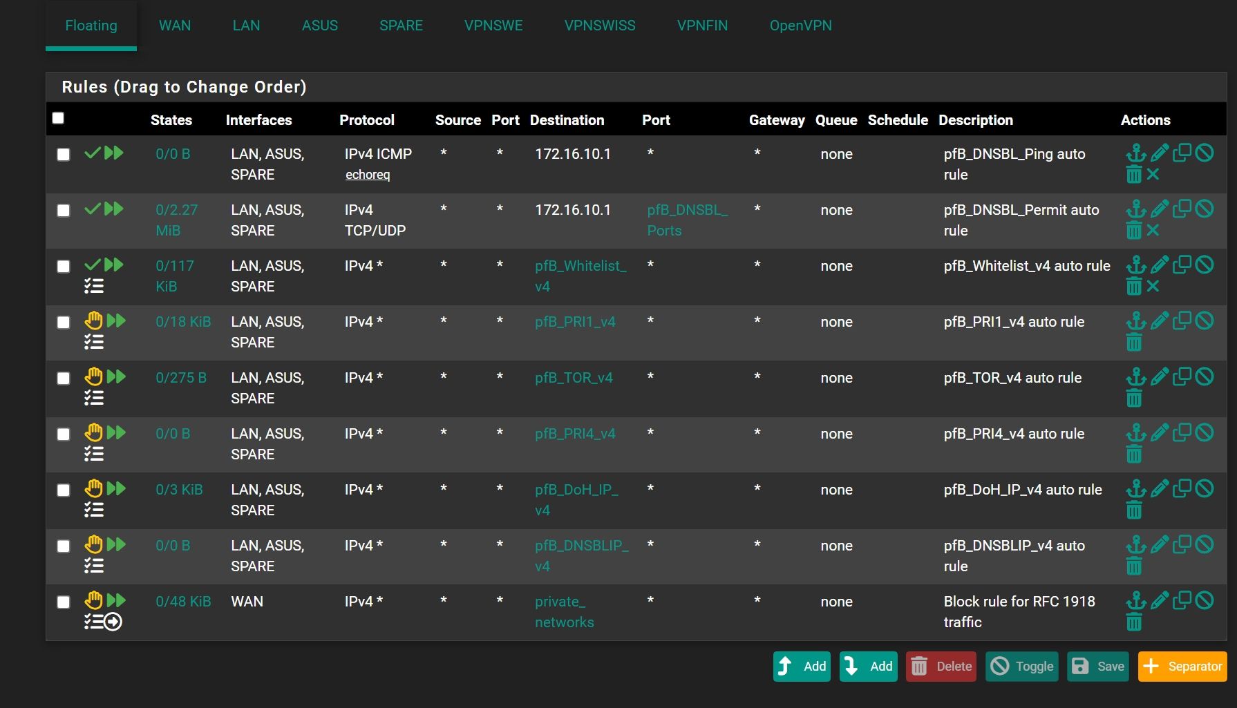

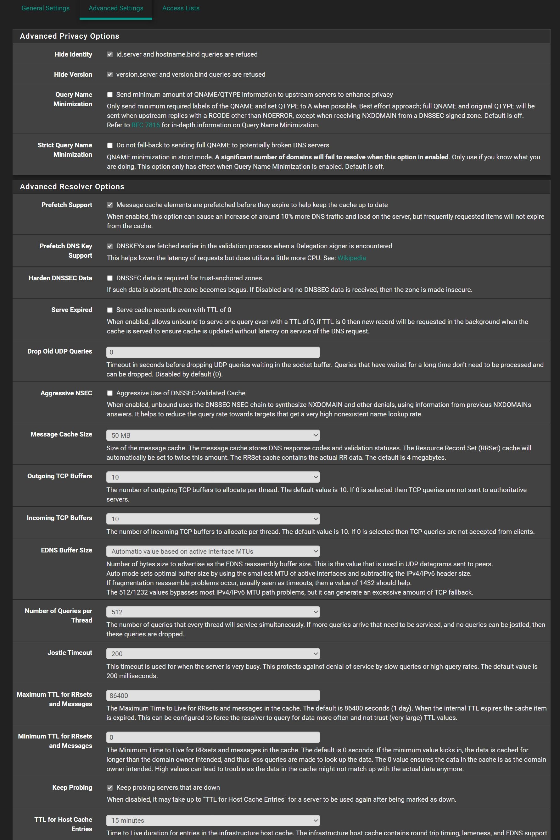

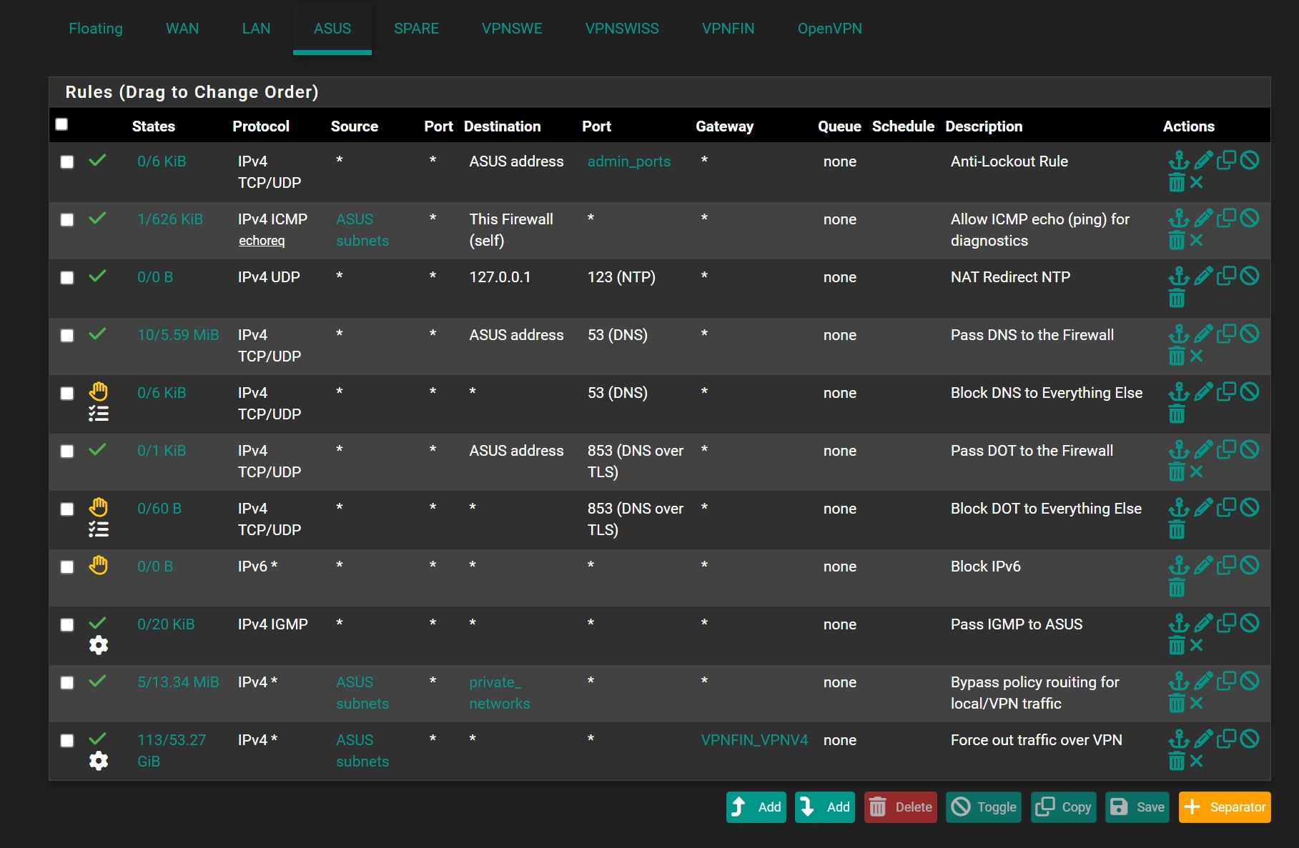

Dns resolver in forward mode to cloudflare.
This is my firewall rules and unbound settings.
pfSesne plus 24.11 beta
@Antibiotic well there is no freaking way you actually talked to 1.1.1.1 or 1.0.0.1 in 0 and 1ms.. Those have to be cached results.. Unless you were actually sitting in one of their DC ;)
Do a query to unbound from a client, what were you looking up btw? If you you look up something that is not in the cache it will take some ms, but after you have looked it up, then the query should be pretty instant, ie 0,1,2 ms sort of response.

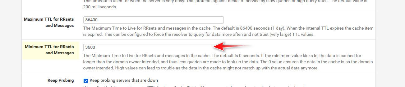

Could you please show, where is I can change this settings?
@Antibiotic in the resolved advanced section
I have been running this for years and years and never had any issues.. But keep in mind that you are really going against common practice and that is to accept what the owner sends for ttl.. but 60 seconds is insanely low.. And since your forwarding, its almost always going to be something lower because your pulling from where you forwarded cache..
the only place I could see having a problem is some ddns your trying to resolve where the IP has changed right after you looked it up, etc. you would have the old IP cached for 1 hour.. But I have yet to run into anything where the 1 hour ttl has caused a problem

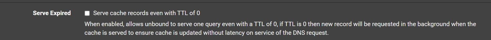

@Antibiotic I also set serve 0, so even if the cache has expired you will get the last IP and then it will look it up again.. So your client will get an IP instantly, but if for some reason that fails, when the client does a refresh he will have a freashly looked up record.
@johnpoz Do you mean, these settings to make ON?

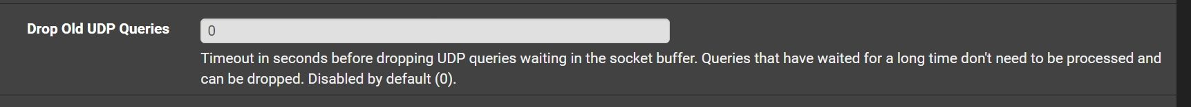

@johnpoz One more question about other settings
Could be useful to set some time here, because me all time using OpenVPN UDP for browsing?
@Antibiotic that really has nothing to do with browsing or openvpn over udp.. those are queries in unbound waiting in the que.. Unless you have 1000's of clients doing a lot of queries and really a under powered dns that should never be a problem.. You could set it to couple or 3 seconds or so if you wanted.. But I doubt it will ever come into play.
@johnpoz Thank you so much!
@Antibiotic nothing very technical but is there a reason you use
cloudflare-dns.comas hostnames for1.1.1.1and1.0.0.1instead ofone.one.one.onethat Cloudflare mentions (and that resolve to the1.1.1.1and1.0.0.1)? -
@patient0 No any reason
@Antibiotic Ok, I'm a bit suprised it does work since
cloudflare-dns.comdoes resolve to totally different IPs.dig +short cloudflare-dns.com 104.16.248.249 104.16.249.249But nevermind, perfect if it works.

@johnpoz So cloudflare-dns.com is correct for DOT or should make one.one.one.one ? Now I'm in doubt)))
@Antibiotic 1111 answers back with
certificate is valid for cloudflare-dns.com, *.cloudflare-dns.com, one.one.one.one
So any of those would validate, if that is actually been checked.. put something in wrong and see if answers. I don't use dot so not sure if unbound is even validating that, or if there is some option you have to enable for it to do it.
But using cloudflare-dns.com is returned by the cert when you talk to 1111
same goes for 1001
