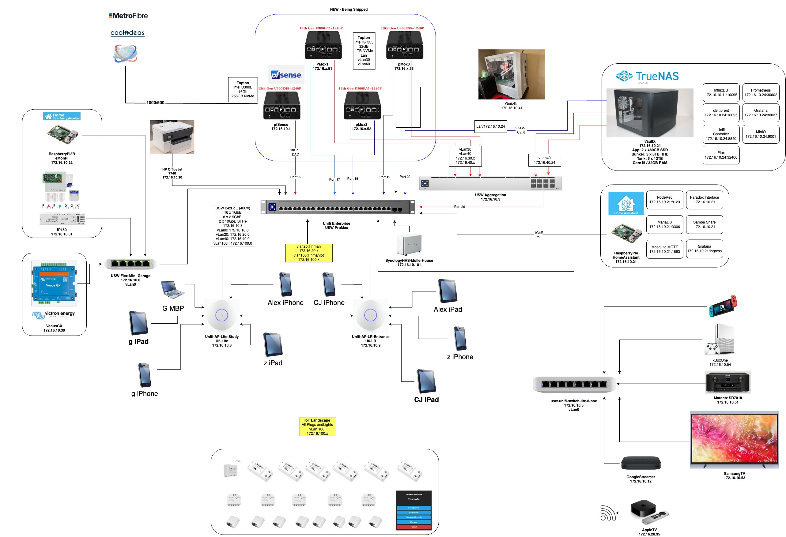

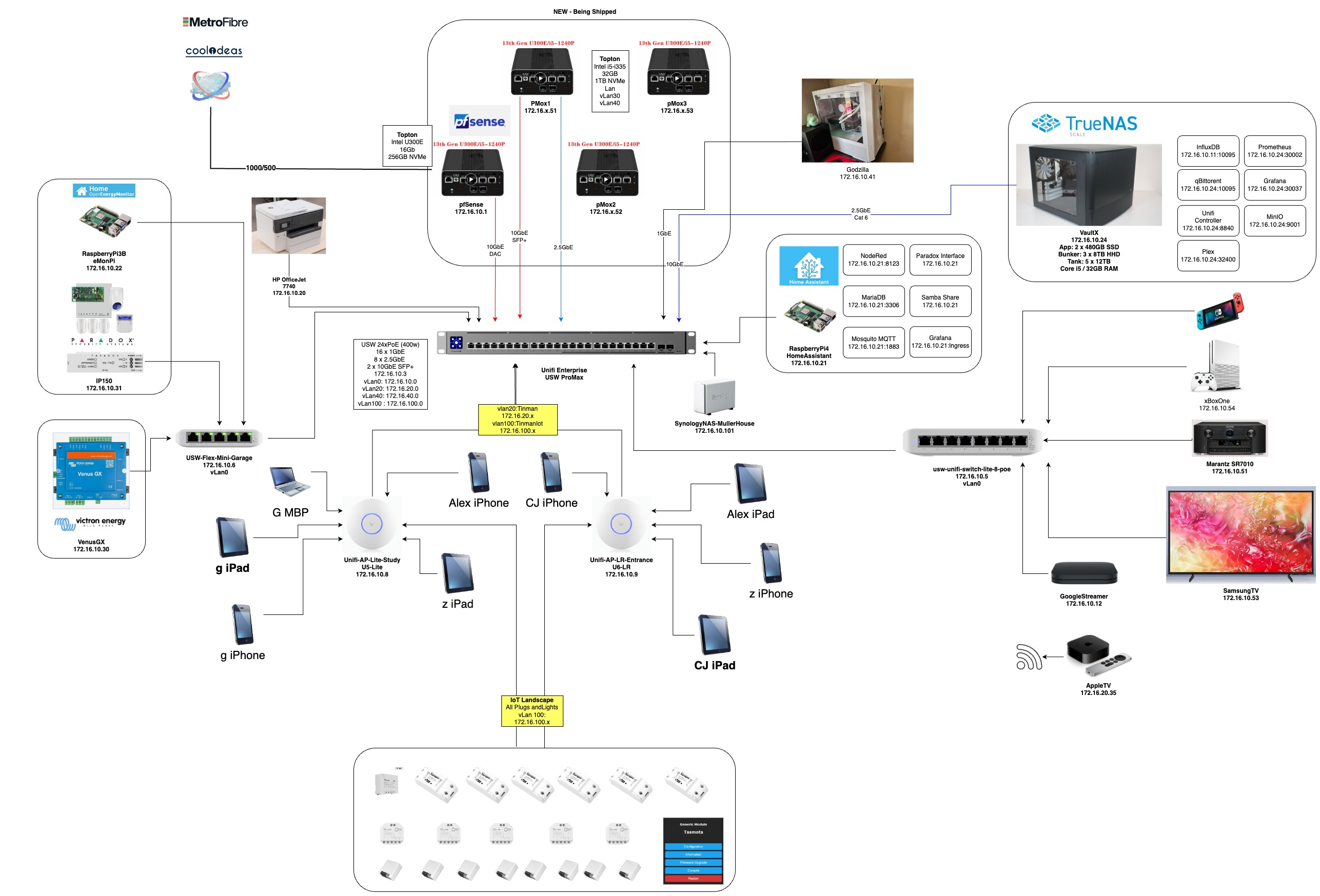

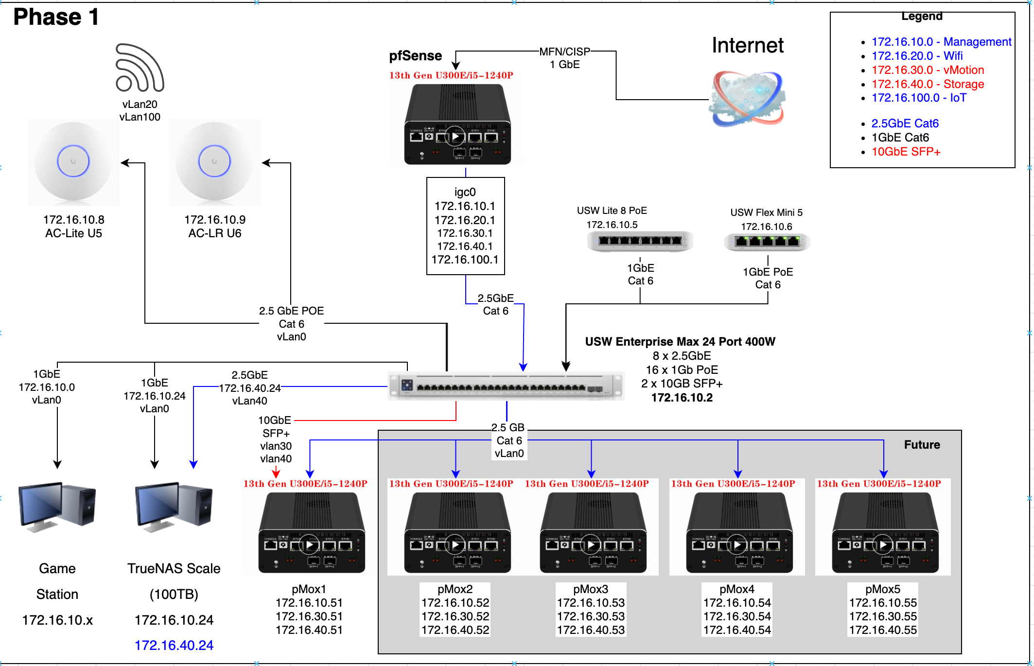

      I have a Topton with 4 x 2.5GbE Cat interface and 2 x 10GbE SFP cages.
      Currently port igc1 has 172.16.10.1 assigned (2nd copper). This is then patched into my core switch Unifi USW Pro Max with 172.16.10.2 assigned to port 24.
      172.16.10.0/24 being the main lan, the main internal network port on the pfSense.
      over this physical trunk I run the following vlan's.
      vlan20 172.16.20.0/24 - Wifi network with AP's
      vlan30 172.16.30.0/24 - ToBe ProxMox Cluster interconnect
      vlan40 172.16.40.0/24 - ProxMox IO
      vlan100 172.16.100.0/24 - IoT Wifi network over AP's
      I've now repeatedly tried to switch/move all traffic on pfSense from igc1 (on port 24)-> ix0 (on port 25)
      Steps followed....
      move vlan40 from igc1 -> ix0 and
      move vlan30 from igc1 -> ix0 and
      move vlan100 from igc1 -> ix0 and
      move vlan20 from igc1 -> ix0
      Last step move/reconfigure lan from igc1 onto ix0 making ix0 the master/parent for all now.
      At this port all is still good, stables. I can even go onto my Unifi and disable port 24. all good... Now the strange, the min i now unpatch port24 then all comes apart.
      G
      Black is 1GbE Cat5e
      Blue is 2.5GbE Cat6
      Red is to be 10GB, the pfSense to Unifi Switch link is to be a 10GbE DAC
      Note, I have a Unifi Aggregation on the way, all the Proxmox Topton devices with 10GbE will patch into the aggregation (to be 172.16.10.3), the aggregation will then patch into port 26 on the ProMax.
      Each ProxMox Topton will have a 2.5GbE onto Lan/172.16.10.0/24
      Each ProxMox Topton will have vlan30 and vlan40 exposed via the 10GbE links.
      This was the attempt...
      A view of the current working, you will see the pfsense to ProMax is 2.5GbE/Cat 6 based.
      igc1
      172.16.10.1 - Core Lan
      172.16.20.1 - vLan20
      172.16.30.1 - vLan30
      172.16.40.1 - vLan40
      172.16.100.1 - vlan100
      This is the to be/planned
      I have considered running only vlan30/40 on 10GbE between prSense and port25 and leaving lan/vlan20/vlan100 on the 2.5GbE link between igc1 and port 24. - no luck.
      Different view of the to be thinking
