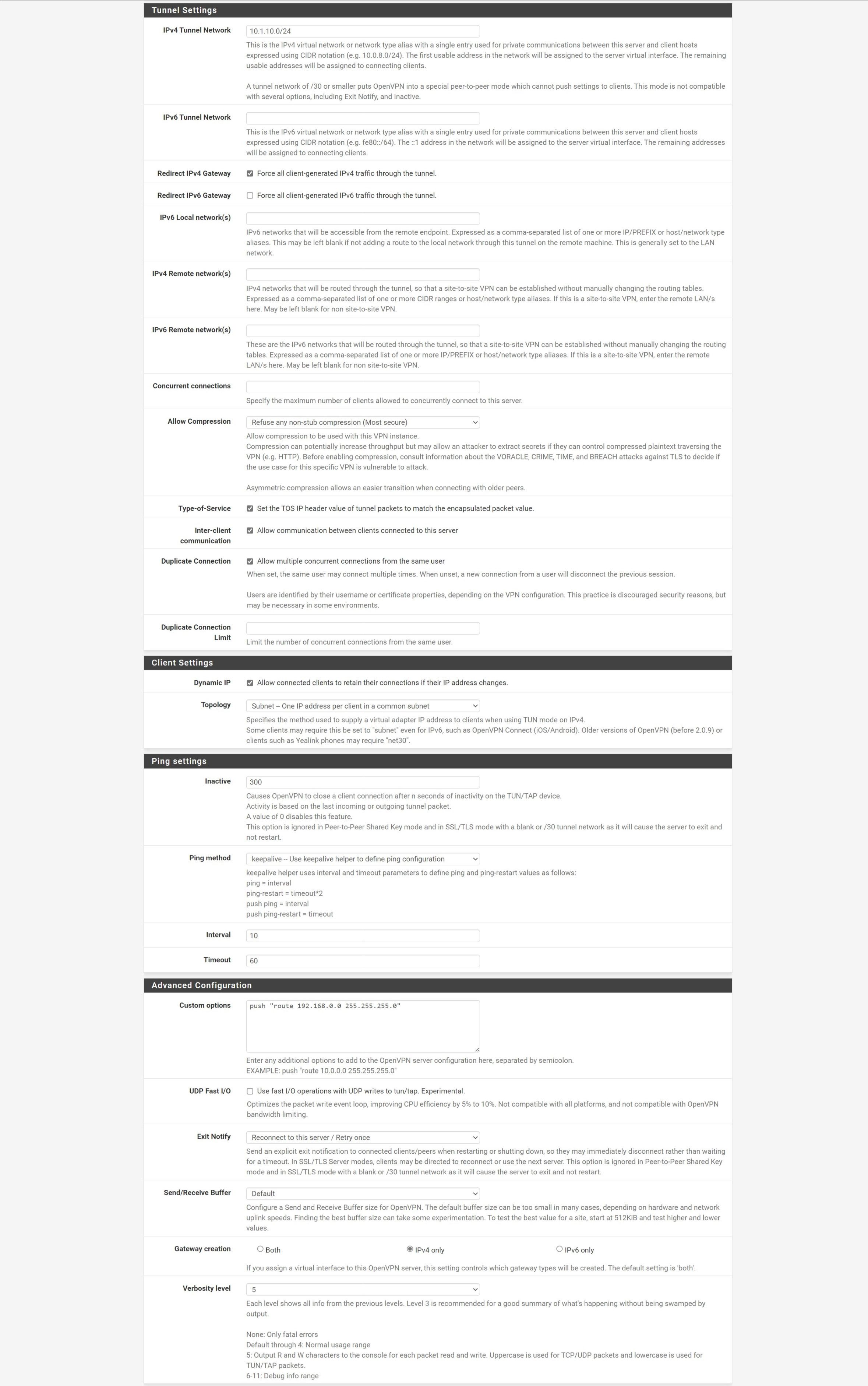

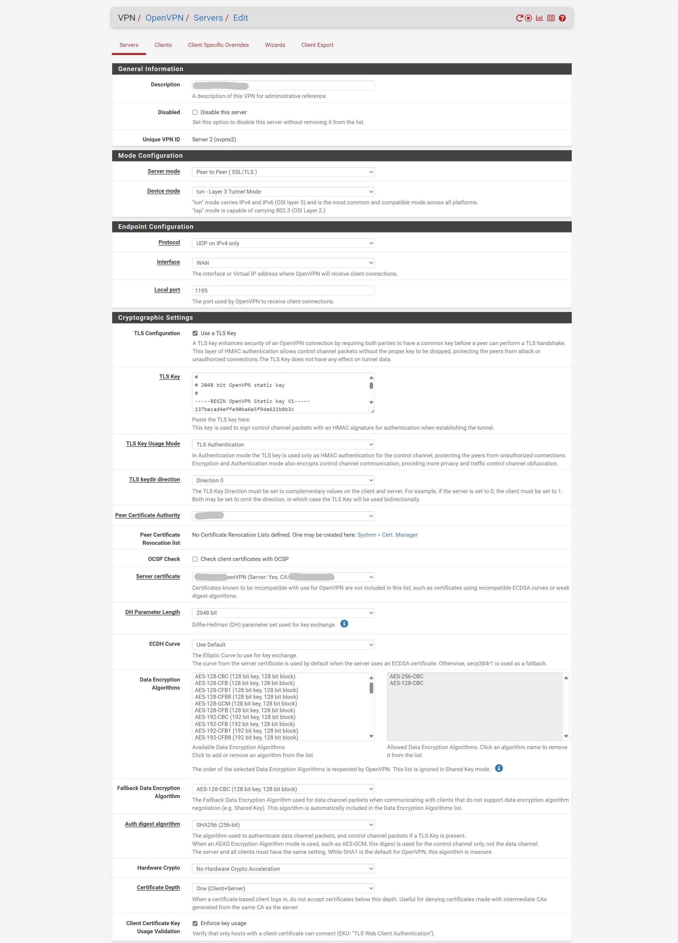

    Wondering if someone can help me with this issue.
    I have OpenVPN server running on pfSense and OpenVPN client running on a Teltonika
    Server LAN - 192.168.0.254/24
    Client LAN - 192.168.10.1/24
    Tunnel - 10.1.10.1/24
    VPN connects fine, from the client LAN I can ping and access all devices that is on the server LAN, no issues.
    But devices on the server LAN cannot access devices that are on the client.
    On the client side I have used the exported config from client export and imported into Teltonika.
