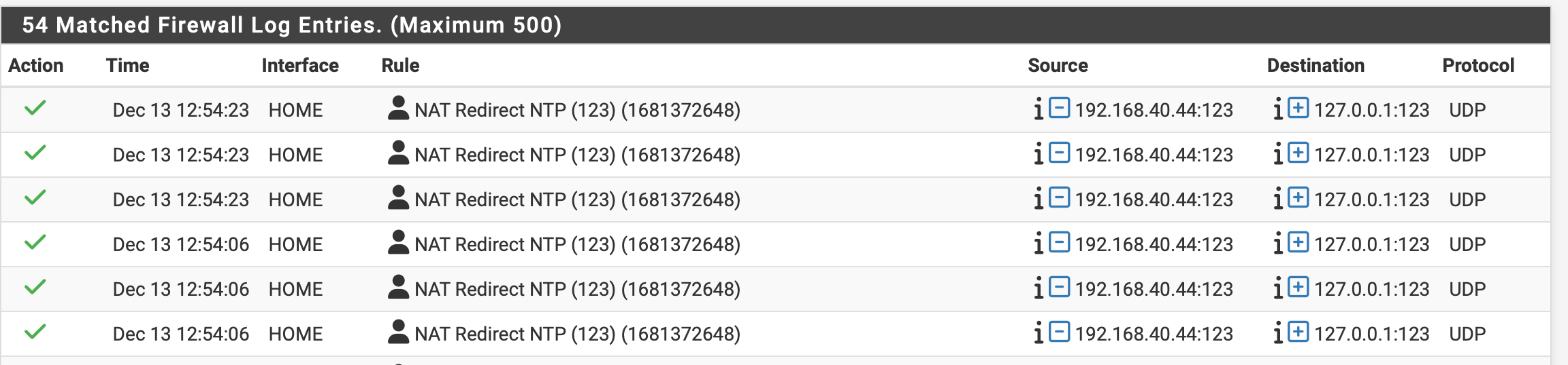

      One of my devices (a Surface Pro running Windows 11) can’t get the time from my home network (it works fine at work). I get an error when it tries to do so. The PC is attached to the network by Wifi at home and at work.
      I use a Netgate 2100 with pfSense+ 24.11, which is connected to a Unifi switch. I have three access points and a cloudkey all connected to the same Unifi switch. There are several vlans. All my other devices seem to work okay (a wired Mac, speakers (wired and Wifi), and various phones etc).

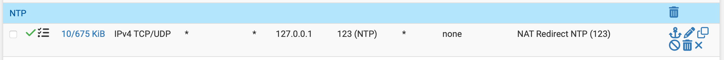

      I use a NAT redirect to point devices to the firewal (192.168.40.44 is the device in question):
      which seems to work:

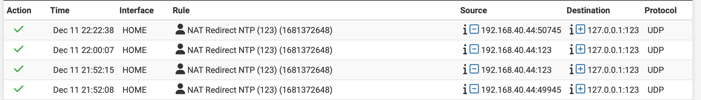

      A packet capture shows this:

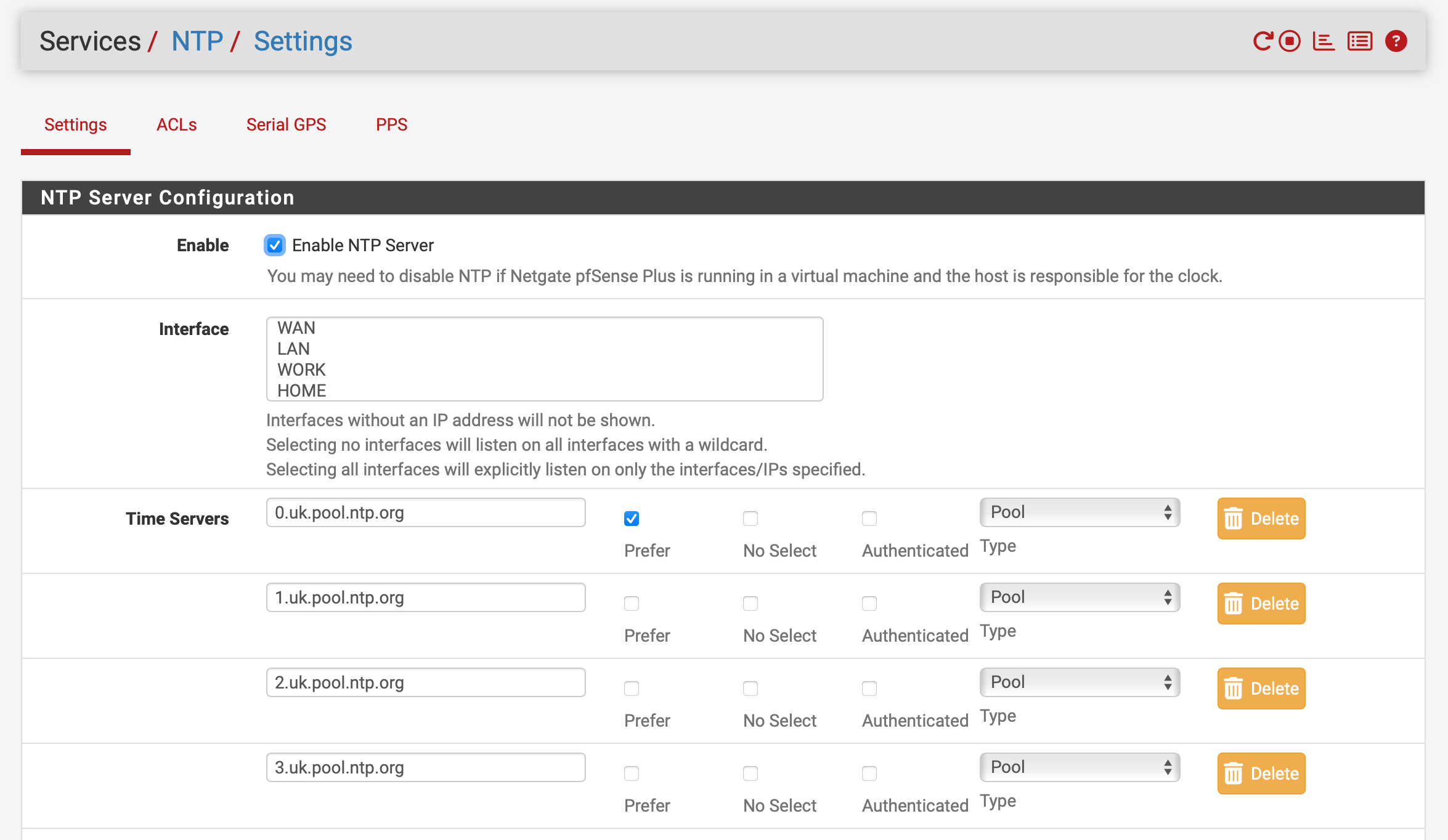

              Also, a question : does the NTP server listens on the WAN interface ? Maybe it does, I'm not sure, you better check that.
              These are the NTP settings (no interface selected - I think that's the default).

                      Go to basic mode first.
                      Unselect everything :
                      and restart NTPd.
                      Then check in which ports its listening :
                      [24.11-RELEASE][root@pfSense.bhfr.tld]/root: sockstat -4 | grep '123'
                      root     ntpd       44699 21  udp4   *:123                 *:*
                      root     ntpd       44699 23  udp4   192.168.1.1:123       *:*
                      root     ntpd       44699 27  udp4   192.168.2.1:123       *:*
                      root     ntpd       44699 29  udp4   192.168.100.1:123     *:*
                      root     ntpd       44699 31  udp4   192.168.10.4:123      *:*
                      root     ntpd       44699 35  udp4   127.0.0.1:123         *:*
                      root     ntpd       44699 36  udp4   10.10.10.1:123        *:*
                      These are all my known interfaces, port 123, UDP.
                      Then check the LAN firewall rules :
                      The first rule is a NUT NAT rule, very comparable to what you try to achieve.
                      But, as NTP listens to your LAN interface, why NATting it to 127.0.0.1 ?
                      NUT listens by default to 127.0.0.1 so the NAT is a solution.
                      The other two IPv4 and IPv6 rules are tested and work. because your pfSense was delivered to you with these two rules.
