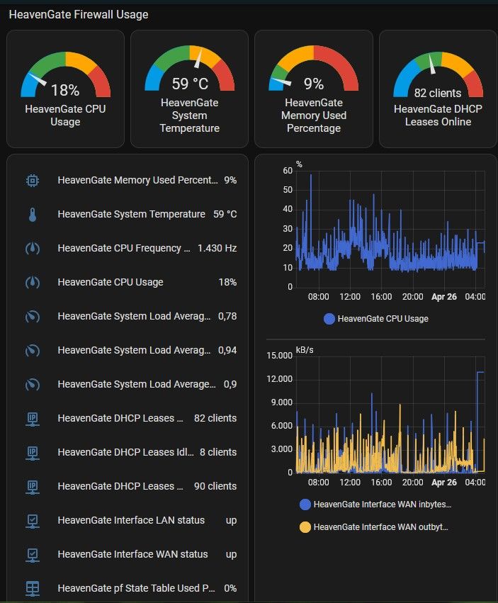

                        @pfsense57352 I am new to pfsense and It might seem a bit overkill to install Home Assistant just to monitor pfsense, but the built in integration is really nice and I don't know your use case.
                        It even has an addon that runs locally called Uptime Kuma (basically an uptimerobot alternative).
                        The ha pfsense addon has a lot of sensors... just fyi here is a home assistant page where I get info from pfsense:
                        1 Reply Last reply
