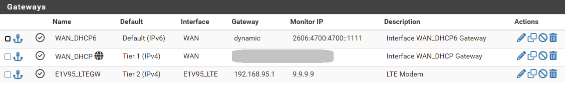

                              netstat -rn output differs from the case where the widget correctly displays the output in that the "S" flag for the v6 gateway does not appear.
                              [24.11-RELEASE][admin@pfSense.home.arpa]/root: netstat -rn | grep default
                              default            a.b.c.d                          UGS            igc0
                              default            fe80::be9a:8eff:fe0b:3b81%igc0   UG             igc0
                              System>Routing>Gateways appears as follows.

                                WRT the comment on redmine:
                                Aug 18 14:54:41 dpinger 89129 WAN_DHCP6 26xx:... sendto error: 13
                                The gateway status "dynamic" and the "sendto" error indicates that the system does not have a route to the monitoring address because the link-local gateway route is not available at that time. The "S" flag indeed means it's a static route which indicates the route came from pfSense itself rather than from some kernel process.
                                Normally pfSense will receive an RA indicating that a DHCP server is available and that kicks off the whole process. However some ISPs are "special". Do you have "Do not wait for a RA" checked? If not, it may be worth testing with it checked. Also pay close attention to both the system logs and DHCP logs around the time the issue happens. It helps to enable DHCP6 Debug under System > Advanced > Networking. Additionally the "ifconfig" output for the interface before and after the issue can be helpful.
                                  marcg @marcosm
                                  @marcosm Thanks for the info.
                                  "Do not wait for a RA" was not checked. I checked it, enabled DHCP6 Debug, and rebooted the system. I'll watch for a recurrence of the behavior reported here.
