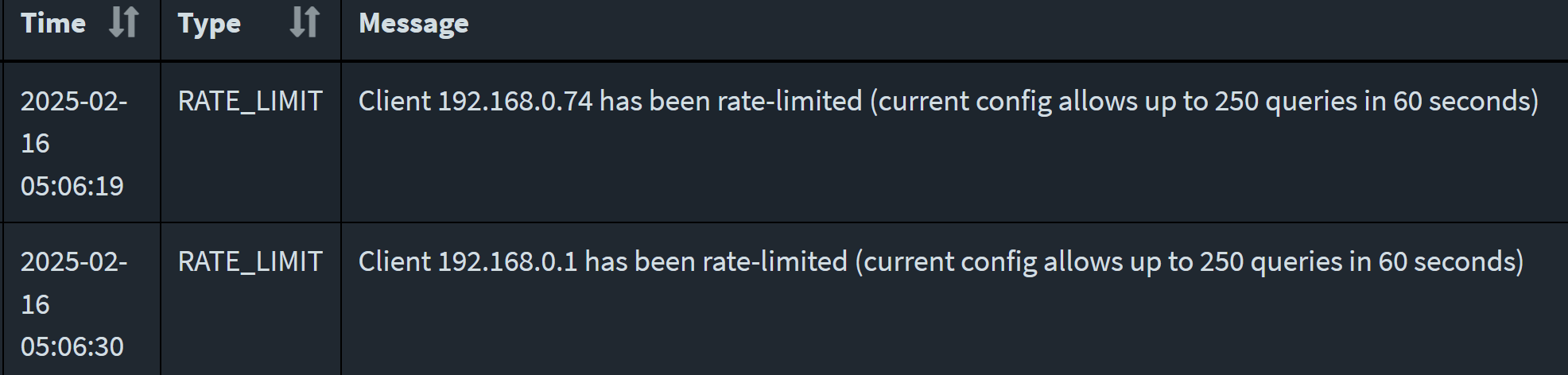

      My net is setup thus:
      LAN 192.168.0.0 -> Pihole (LAN DNS) 192.168.0.8 -> pfSense (Resolver) 192.168.0.1.
      My Pihole tells me the following:
      pfSense's DNS servers are just 127.0.0.1 and ::1. Clients get DNS via DHCP, but pfSense is hardcoded IP and not listed in static or leases. Clients and statics are not registered in DNS. Any thoughts as to why pfSense should be hitting the inside DNS when it should just be looking out the gateway? Thanks for reading and any replies.

      • AndyRHA Offline
        AndyRH @provels
        @provels said in DNS Puzzle:
        Where is pfSense going for DNS?
        2 guesses:
        pfSense is using PiHole and PiHole is not resolving a name a pfSesnse is retrying often.
        pfSesnse is using PiHole and 1 or more clients are using pfSense for DNS and PiHole is not resolving a name causing many retries. You said the clients point to PiHole, maybe there is a rogue system.
        Try pointing pfSense to 1's or 8's to test.

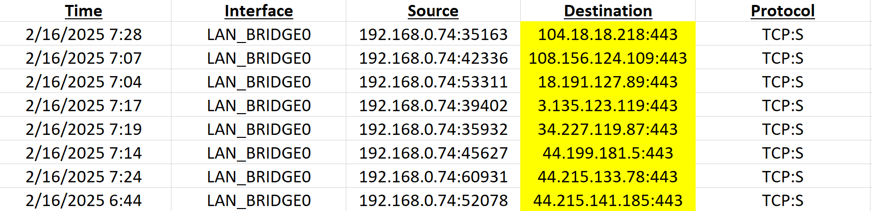

                  I finally remembered to look at the Query Log on the Pi. 🙄
                  Looks like it's
                  d1oxlq5h9kq8q5.cloudfront.net
                  and related to the TV. Github
                  but still no clue why things are going backwards. I guess I can just WL it and move on. But still...

                    @provels This is AAAA, so it is IPv6. You have to watch out that DNS is not going different routes for IPv4 and IPv6. I disabled IPv6-DNS in DHCPv6 and RA. Although, source is IPv4 so this also doesn't seem to be the problem here... It is a puzzle for sure.

                        @johnpoz @Bob-Dig Both DHCPv6 Server and RA are disabled. The FW is trying both IPv4 and v6.
                        My net is quite simple, it's like 1998... No DNS redirection, NAT reflection. I do use a couple HOSTS entries on a couple Windows boxes, but that should just blow past both machines.
                        No dupe IP because I'd probably be dead in the water w/o any gateway.
                        ARP table from the Pi below. The highlighted address is the LAN Bridge. It appears today's flood occurred between 07:33:46 and 07:33:47, hundreds of packets. Weird.

                                      If you believes its the TV generating the dns queries - I would packet capture to validate that and see exactly what is going on, where is the traffic being sent, what IP and mac coming off the TV.
                                      provelsP 1 Reply Last reply Reply Quote 0

                                        @johnpoz
                                        then how would pfsense even be involved in the conversation
                                        Good question! TV and Pi are on the same flat net behind the bridge. Pi runs as a VM on a Windows server. Mask is right , TV gets DHCP. But would anyone be surprised if Google DNS was hard coded into the TV? After all, they try to make these things as stupid-proof as possible. I do attempt to block DoH in pfB. And I force all normal 53 DNS to the FW. But still, pfS shouldn't even know there is another DNS server on the net. As far as pfS knows, Pi is just another client. I'll watch it and post back if I have any revelations. Thanks again.
