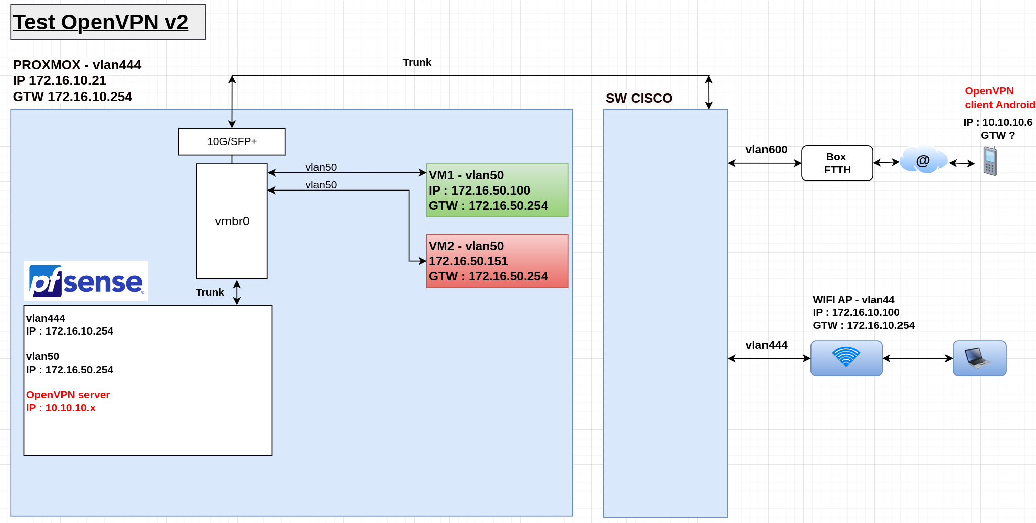

      I am testing a configuration in Homelab environment using Proxmox PVE + OpenVPN + pfsense.
      OpenVPN server is running fine on pfSense, client is connected, but I have an issue :
      This working :
      • external client can connect to VM on vlan50.
      • external client can connect to WIFI AP on vlan444.
      This NOT working :
      • external client can't connect to Proxmox VE -> KO
      Architecture :
      Open VPN fw rules :
      In brief, external Open VPN client can access to a physical device on vlan444, but not to pfsense VM on vlan444, despite acces rules.
      I probably I missed something in configuration.
      Could you please help me to find this ?
      Thank you.

              dvb @viragomann
              @viragomann
              Here is an updated schematic with more informations :
              I retried to connect theses 2 devices :
              • I checked OpenVPN rules
              • Rules are identicals, and devices are on the same vlan.
              • Proxmox uses pfSense as default gateway
              -> OpenVPN client -> VM Proxmox (172.16.10.21) -> KO
              -> OpenVPN client -> physical device (172.16.10.100) -> OK
              At this point :
              • I don't understand why traffic can reach 172.16.10.100, but not 172.16.10.21.
              • Do you confirm it could be solved by adding a rule here ?
              • V Offline
                viragomann @dvb
                @dvb
                So the only reason for this, I can think of, is that Proxmox itself blocks access from outside by it's own firewall.
                But yes, a masquerading (outbound NAT) rule can also circumvent such firewall restriction.
                Enable the outbound NAT hybrid mode.
                Add a rule:
                interface: vlan444
                source: 10.10.10.0/24 (OpenVPN tunnel network)
                destination: 172.16.10.21 (Proxmox)
                translation: vlan444 address
