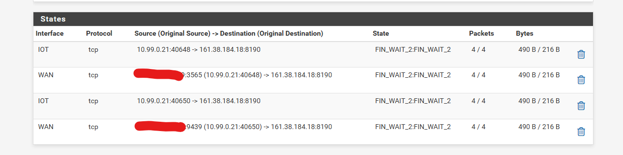

        • E Offline
          ezhawk @stephenw10
          i see some fin acks both ways. after a while all the states drop and then it comes back and in the states it just sits at fin wait.
            Can we see the pcap from the pfSense gui with the TCP flags? You can obscure the IPs if you need.
            We need to see which side stops responding.

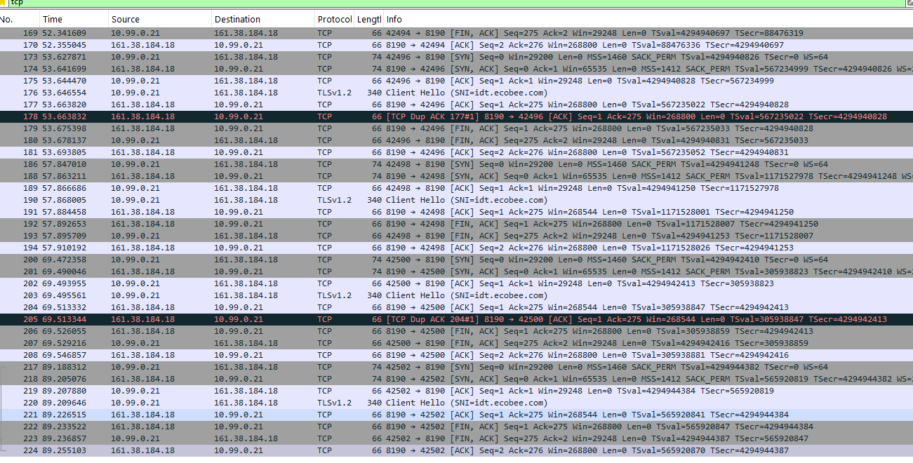

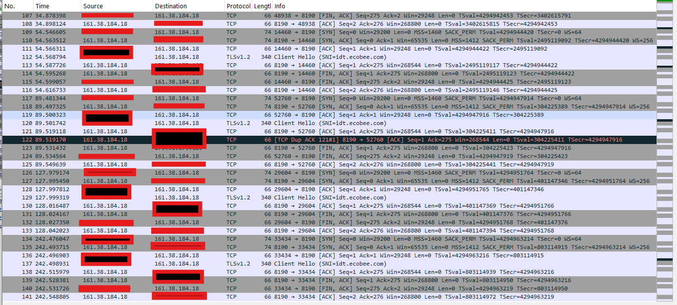

            • E Offline
              ezhawk @stephenw10
              wan pcap
              lan pcap
                Hmm, interesting. That dupe ACK is odd. Like the server expects to see something from the client and doesn't. Except the dupe comes 12 microseconds after the first. Other than that it looks like a pretty normal TCP connection. The client just isn't sending or pulling anything. I do note there are no large packets shown. But they are not present on either interface. pfSense seems to be passing that traffic as expected. 😕
                Even when the dupe ACK doesn't happen the server sends a fin-ack pretty much immediately.

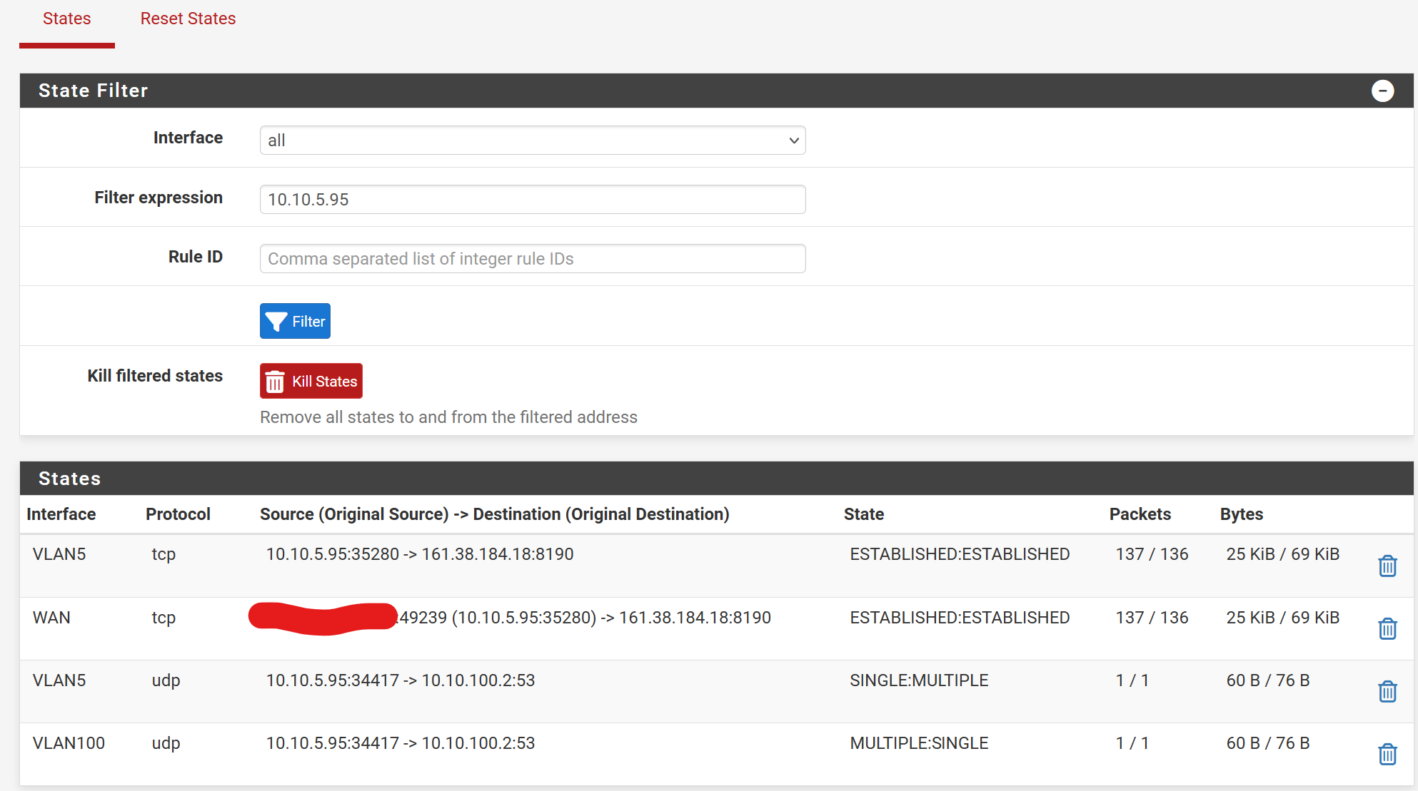

                        @GPz1100 Are you able to grab a pcap for comparison with a working connection?
                        GPz1100G 1 Reply Last reply Reply Quote 0
                        • GPz1100G Offline
                          GPz1100 @stephenw10
                          @stephenw10 What specifically do you want captured, and for how long? I can use the pf packet capture gui option but what options do you want set there?
                          The ecobee is on the IOT vlan which only has rfc1918 access to dns server and internet.

                              • GPz1100G Offline
                                GPz1100 @stephenw10
                                @stephenw10 Attached is a sanitized pcap. Ecobee mac and lan interace mac sanitized to begin with bb dd cc and lan mac begins with 11 22 33.
                                sanitizedpacketcapture--20250828135527.pcap
                                The capture is a 10 min segment of steady state operation.
                                Note, the ecobee tries to resolve api.amazon.com every 50s. This is denied via dns server as well as blocking the entire amazon asn for the ecobee ip.
                                Hope this helps.
                                PS. please delete the previous message - it's already tagged as deleted, please remove permanently.
                                  Hmm, so it normally just holds open the TCP connection continually.
